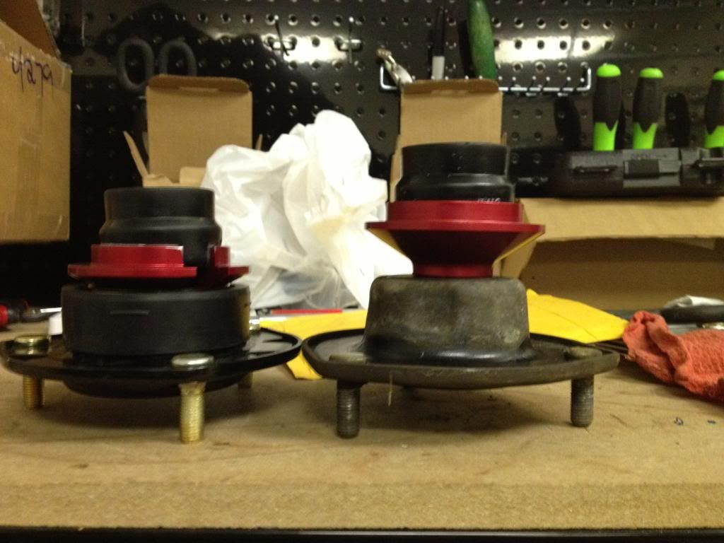

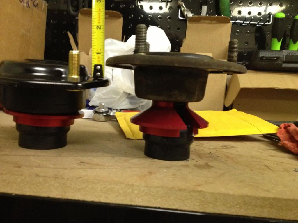

I am building a set now and taking pics so I can post them. I have everything for it but am doing it slightly different. I had all 4 coil sleeves bored different, am adding another c clip groove in the rears to get them to the height I want, and had the 4 shocks machined at the top to work with MK4/SC300 strut mounts.

The top / upper mounts are going to be the key. What did you do to fit the shocks to them? Is the body side the same?

BFR body side is the same and all that is needed for the shock to fit is file down a flat on opposite side. MK 3 supra has one flat side so the end looks like a D the MK4 and SC300 have a flat on both sides. I took pics of the shock both next to each other to illustrate if I have time ill post them tomorrow. Also I just found out yesterday that I have to leave for work for a few weeks on Monday so I will not be able to post up completed shocks until after then.

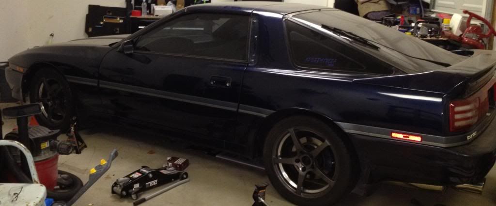

Here are a few pics to show the difference between a MK3 and MK4/SC300 strut mount. Also a few pics of my system and them on the car. I am waiting for the springs to settle and will then adjust the height again. Also this saved me 20 pounds of weight not counting the wiring and computer/controllers i am removing. I also have pics of the difference between the MK3 and MK4 rear strut mounts if anyone is interested. Also while you can get any form of sleeve you want i would stay away from the AFCO ones as there top spring perch is designed different and adds about a half inch more (i purchased those first and then returned them).
