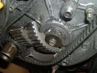

Don't know what you're talkin about Muzy, never had a wobble or ticking noise, in fact nothing warning at all just stopped.Muzy;1211423 said:I think you found that ticking noise. Was the wobble issue ever addressed? I think this
failure is related, from previous post. muzy
Good question, I checked that first and it's spins freely, I can turn it by hand. I think I'm going to put a drill on it and make sure I have oil pressure though.grimreaper;1211438 said:holy shit! it was wobbling before this happened? does the pump spin freely with a socket on the pulley bolt?

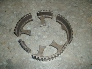

90T04;1211459 said:Mine did that exact same thing. No pump failure or driveshaft problems, just replaced the pulley and was good to go.
IJ.;1211453 said:Sort of common failure AJ!
If you mark any of the spokes during assembly it will fail as the pully is "sintered"
For those that don't know what that means they take Metal powder and compress it into a mold of the part add heat and LOTS of pressure and out pops a 99% finished part. (The infamous r154 thrust washers are made the same way)
During assembly/disassembly people often wedge the pully with a screwdriver so they can torque up the bolt and this in turn marks the spoke creating a stress riser (think lines on toilet paper)
