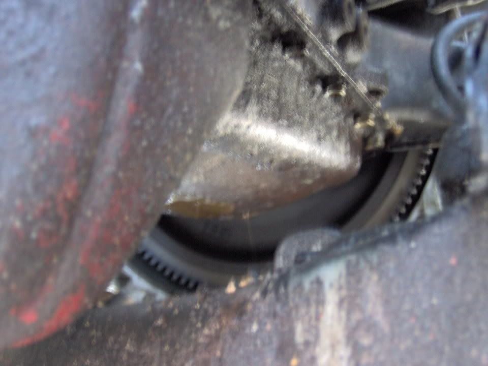

I've narrowed down the nice drips coming from under my car to possibly the oil pan leaking. How hard is it to change out? I'm getting tired of dry sweeping the black spots everyday, some is okay but as many as this drips it's a pain. :nono:

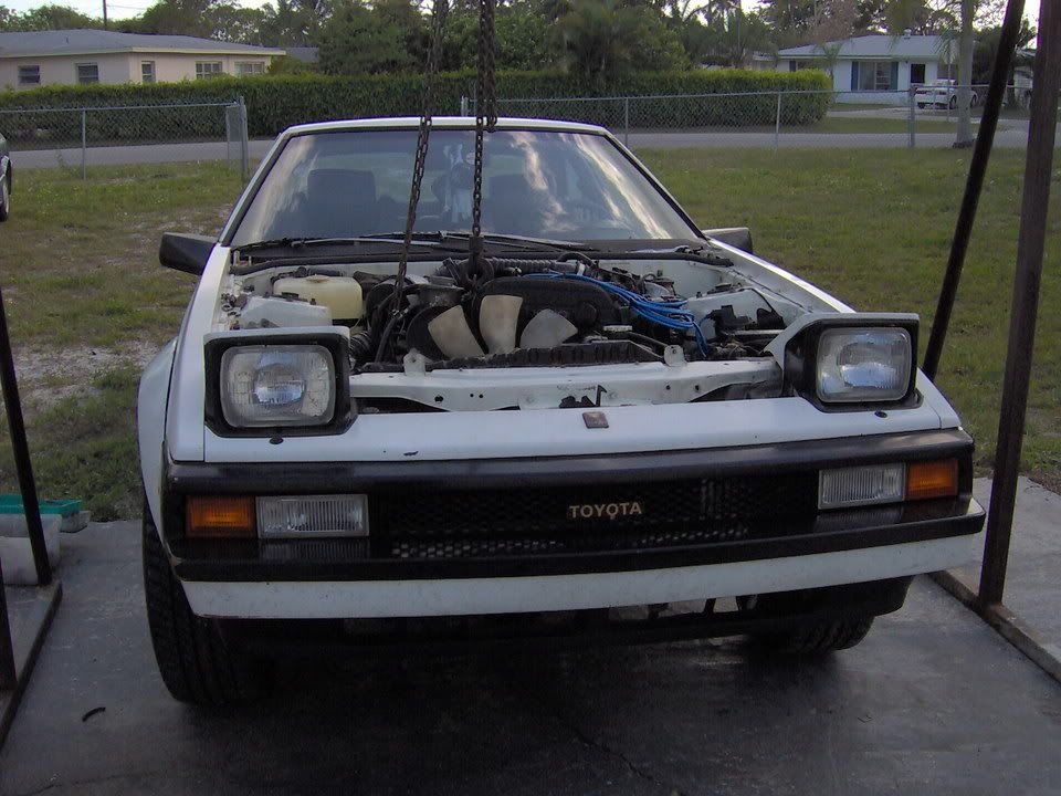

pull the hood, undo the engine mounts and start lifting. unbolting the oil pan and bolting it back up probably takes the longest. gotta clean both surfaces very well and use a decent RTV sealant, FIPG or whatever gasket maker, lol.

pulling the 7m is really easy after you do it once. man, i pull my motor out when i change my spark plugs. ;)

^^I agree. Pull the motor out, you'll wish you had if you dont. I pulled mine out to change the t/o bearing. makes everything easier.
