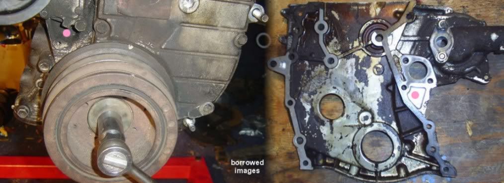

rumptis - How did you fix yours? I think the front plug for the block oil rail is leaking on mine too. Did you have to pull the entire front off including the timing gear case sub-assy? Doesn't that affect the hg seal?
Is it possible to drill a hole, in the sub-assy, small enough to get the allen wrench in? It appears there is structure all around and that area is a void that only covers the plug.

Thanks for the reply. Since you had the wrong plug, yours had to come off anyway :( Or maybe you could have drilled large enough to get the plug out.
I think, (hope), mine is the correct plug and only needs tighten. The one at the rear was loose. Took the transmission off expecting to do a rear main the that plug was barely in there. Teflon tape and tighten and now I'm not going through a quart a week.
This is why I suspect to find the same for the front plug. I just wanted opinions of drilling the case, cause it looks feasible.
edit: that filled in area is only 4mm thick

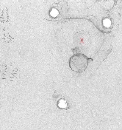

I'm thinking I will put a 1/2" hole in there, to get the 3/8" allen in there, and tighten that plug.
I don't think it will compromise any structure and doesn't expose any coolant or oil passages.
The plug itself is 11/16" but the 1/2" will give me enough room, for 3/8" allen, in case I don't get exact center of the plug.
