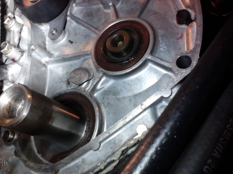

I've searched for an answer but can't find an answer. I've been having problems with my 7m since I've bolted on my new turbo. I have a pretty bad oil leak, it is coming from a hole in the front of my engine, just above the pan gasket, behind the crank pulley. What is this hold for, and what causes oil to leak out of it. It is some sort of weep seal? How do I fix it?
I've got a holset hy35, 4 an feed like with a .065 restrictor, and a 10 an drain. PVC ports on the valve covers are connected with a filter in between them.

Yes it is a weep hole, if you have oil coming from here you need to pull the timing cover and check where the leak is coming from. Most likely it is from the cam seals, oil pump shaft seal, or crank seal, but there are other possibilities.
Your two valve covers are hooked to each other and no outlet to anything else?
I think you found your problem.

I do believe the PCV needs vacuum to operate properly..
Pull your dipstick with the engine running and cover the hole, do you feel any pressure pushing against your finger? If you can't tell, cover it with a piece of paper and see if the paper moves. Sounds like the pressure in the crankcase has caused one of your seals to push out. As stated above, cam seals and front main would come to mind first.

Poodles;1917813 said:
Bigger turbo = more boost = more blowby = more need for PCV
Makes sense. I'm going to pull off timing cover off to see what is leaking, probably replace all the seals i can, as well as fab up a new intake pipe so I can hook the PVC system back up.
