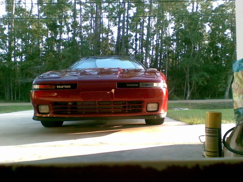

the intercooler mounts to the two the frame where the front bumber mounts to? you want pics?
noah89t
get naked & boost a supra
mine sits in front of the ic. it is on the right side. been like this for years with no problems.
dumbo
Jul 16, 2008
1,913
Albera, Too Far North
as you can see in the pics, its simply bolted in 2 spots, the one with the oil filter in the pic is the passenge side.
its hard to get good pics of the oil cooler, but thats her.
