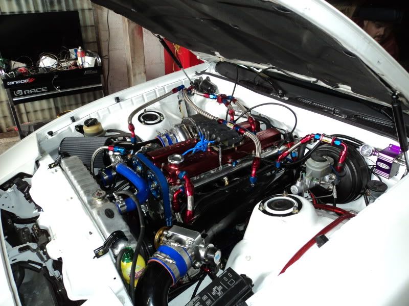

here is mine
I used 1 way check valves works really well for ring seal
under boost the intake pipe give vacume and berfor boost the manifold does the job all controled by the vavle

Damn thats a clean motor.

NashMan;1678884 said:
here is mine
God that's some nice work there Nash, thumbs up!
Really nice hoses/routing/etc.....is that 6AN hose for the PCV you have setup?
