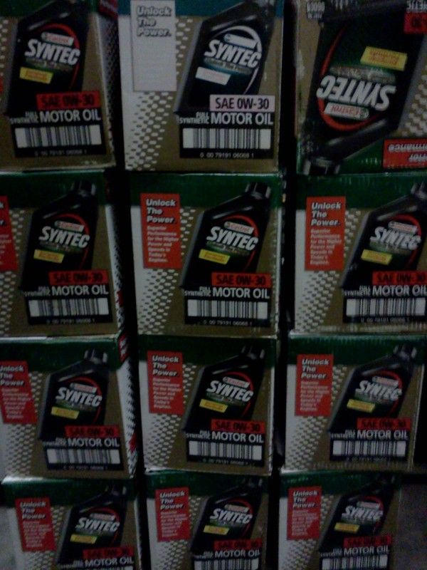

redline 5w30 eneos 5w30 and castrol syn 0w30 with a carquest blue(wix) filter or a bosch. they dont make castrol syntec anymore its edge now *shrug* bought 0w30 syntec for 1.40 a qt... got half a pallet >=)
not sure why anyone would want to run rotella... or any 40 weight
