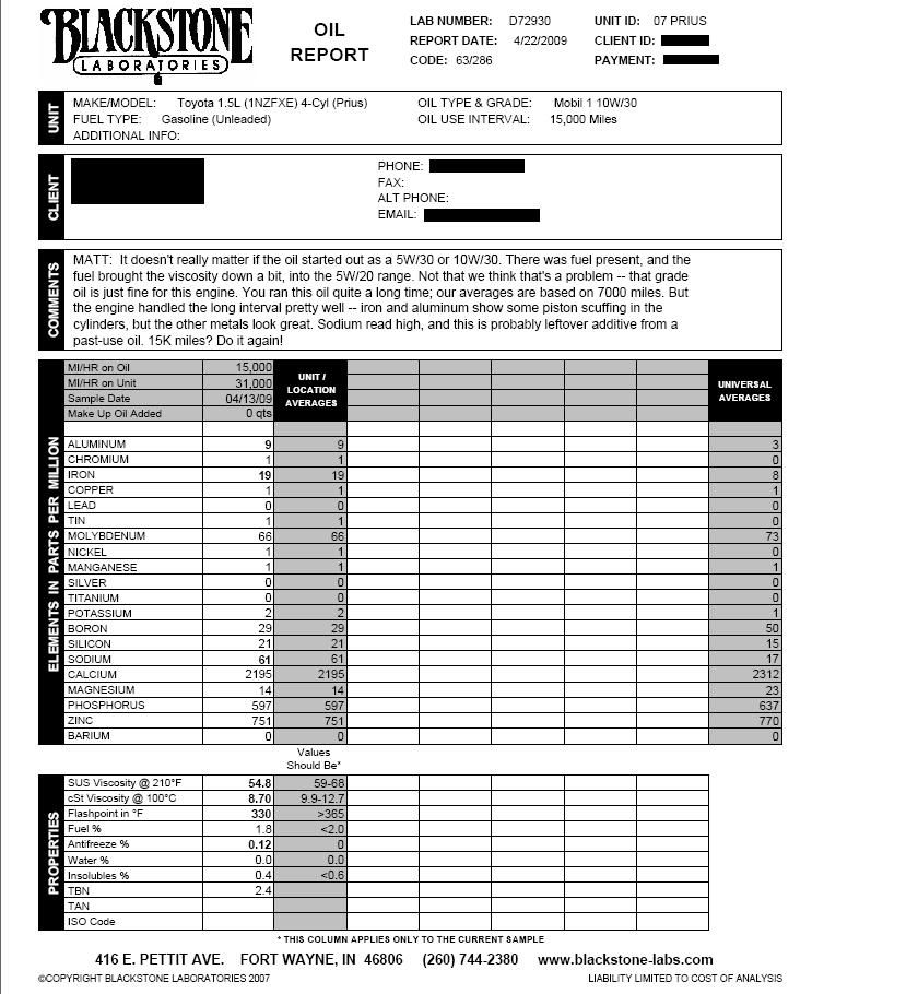

Piratetip
Far From Maddening Crowds
Dec 30, 2005
1,179
70
MKE, WI
My brothers oil change interval went longer than expected.
I suggested he should have it tested.
It turned out better than I expected, definitely used the whole life of the oil.
Here are the results.
LMK what you guys think.
jdub
SM Expert
Feb 10, 2006
10,730
Valley of the Sun
That's damn good for 15K miles...looks like that motor likes Mobil 1 ;)
Illustrates a case in point...most people change their oil way too often.
Does that engine run rich? I'd take steps to reduce the fuel dilution. Use a better air filter (AC Delco for stock air box) and change it per the manual interval...that will help the wear metals.
Piratetip
Dec 30, 2005
1,179
70
MKE, WI
People DO change their oil too often! :)
Were trying GC this time around at 10k, oil analysis again.
Was on sale and figured why not.
I would say that the engine probably does not run rich (55mpg), the stop start characteristics may have some impact on the fuel getting past the rings.
Will look in to what may be causing the fuel dilution with this 1.5L engine.
Will check to see the last time the air filter(s) were changed, there are 2 in series so I would be surprised to see anything going through them.
Running GC in my DD now and will do an oil analysis at 7,500mi to see how much life is left in it.
I am hoping for 15,000mi, but well see.
Those results will be posted here also.
jdub
SM Expert
Feb 10, 2006
10,730
Valley of the Sun
Get a TBN as well...that will tell you how much life is left in the oil to neutralize acids.
Piratetip
Dec 30, 2005
1,179
70
MKE, WI
Oil analysis without TBN would be frightful (and handicapped). :)
jdub
SM Expert
Feb 10, 2006
10,730
Valley of the Sun
LOL...tis true ;)
The one in the analysis is right at the min I would accept...I have to say (though I dislike Mobil 1 oil), 15K is damn impressive. If the GC doesn't meet expectations, I'd switch back.
Piratetip
Dec 30, 2005
1,179
70
MKE, WI
Will do.
I suspect the fuel dilution to come down as temperatures here have risen.
The Prius was driven in the winter and it was damn cold here some days.
