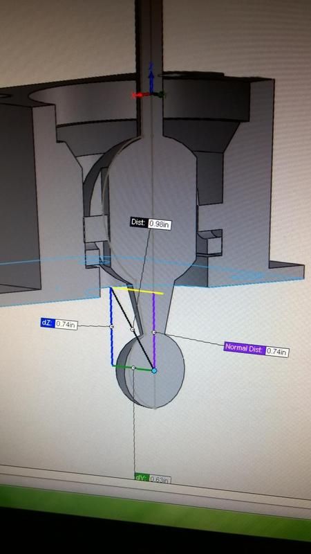

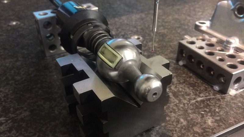

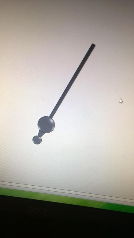

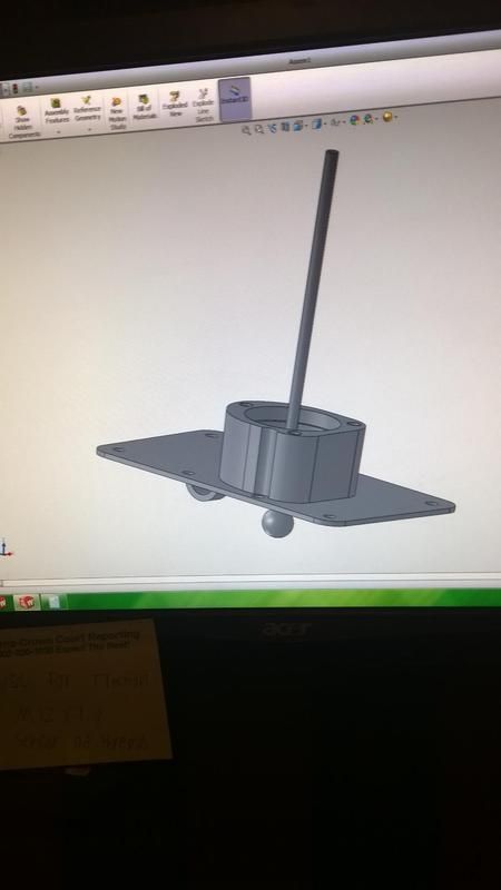

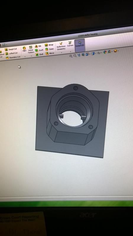

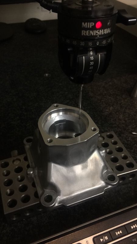

Since my shifter setup to fit the mkiii semi worked, I decided to push forward and revise it a bit so hopefully it will be a drop in soulution and utilize a shifter setup that's a good 1' plus farther forward.
This was my mockup prototype:
http://youtu.be/tR-8Wrw1lbI
Creating a better drop in shifter housing: shoutout to BillyBadass for helping with modeling

Well this shifter setup can be modified in length to fit more than just mkiii, like sc300/400,z32, Mkiv, etc.
Also my adapter can be utilized on any Engine that utilizes a W series bell; 7m, 1j, 2j, 3rz, etc.
So it may be a group buy for everything in between
