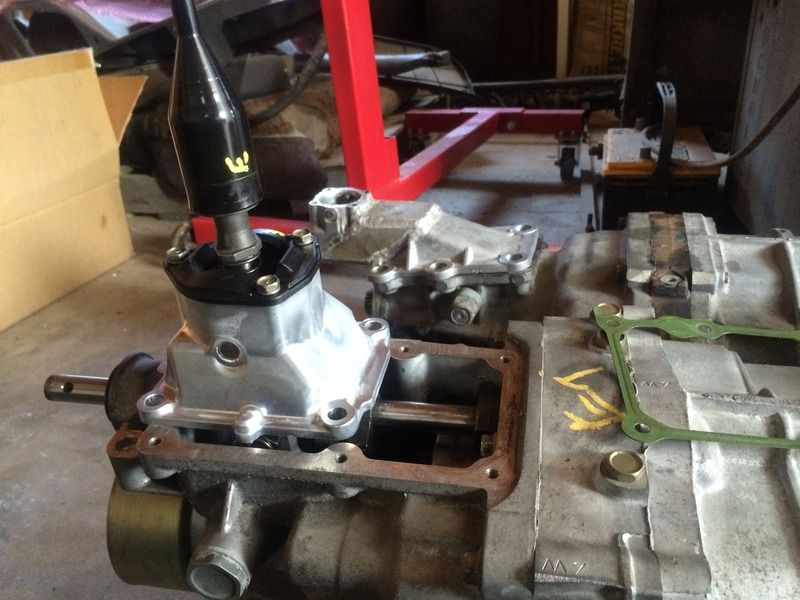

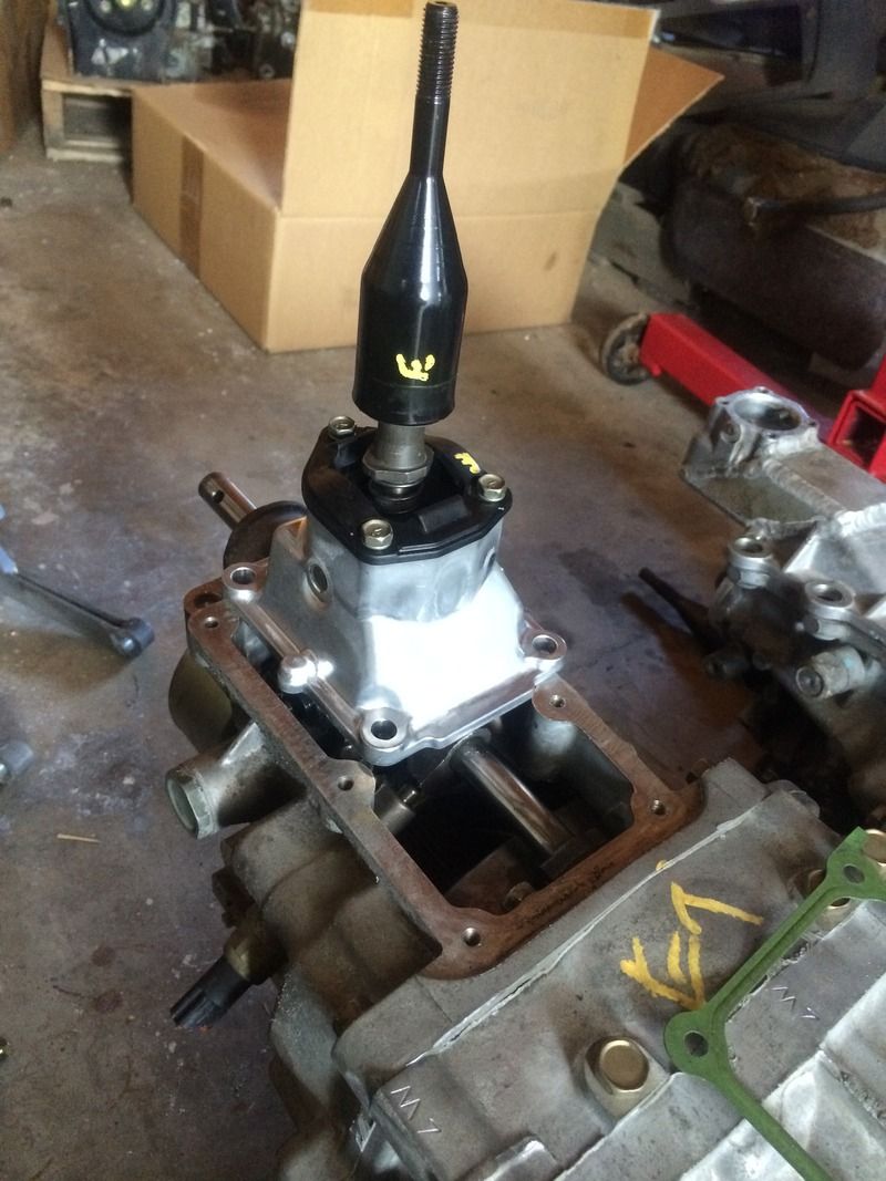

Here's the shifter setup I am working on. Kit will be an adapter plate and a new shifter selector that will replace the oem one. Then buy off the shelf shifter housing and shifter. It's a 6speed shifter and still retains reverse lockout (down to the left)
