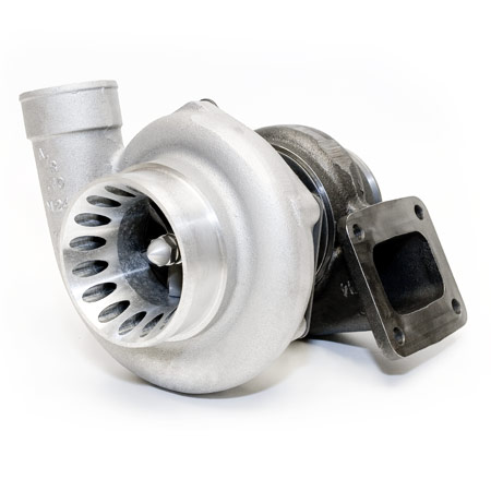

thats a pretty sexy turbo, it says 700-750 hp capable to. im starting to like you man. to bad you live so damn far away i could really use a hand on this car, i've been having to do it all by my lonesome. no one wants to help a supra guy out :nono: and all my friends drive hondas and i just dont trust them.
64
LOL I'm pretty damn impressed with it even at 5psi :)
(mine doesn't have the ported Comp cover)
Yeah the distance thing sucks there's so many times I see things here I'd like to be hands on to help but can't due to being on the other side of the planet...
NO ONE trusts Honda guys ;)

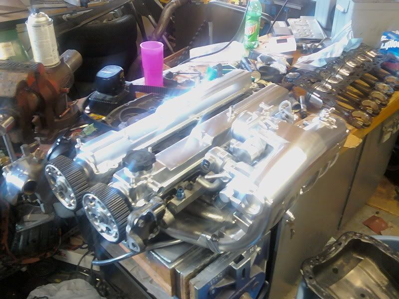

well i thought i would pop on in and give everyone an update on the supra's life, so in record time we pullled the motor out got the head and pistons all out, it is a fact that the front timing cover was not machined, so that will be getting done this monday or tuesday. the head gasket had the rivets on there, i have drilled only the 2 corner ones that did in fact get in the way of the head. it looks like only 1 of them really goes under the head while the other one couldnt really tell so i drilled it anyways just in case. the coating on the HG was still on there but im going to copper spray it anyways. going to relube everything while its apart, get the block hot tanked again. and while it was out i also put my solid motor mounts on, meanwhile my friend is making a solid tranny mount for me and short shifter. im going to deal with the fuel system and oil after the motor has broken in partially, i want to know that i dont have any other problems that i will have to spend more money on. but as for updated pictures here you go :icon_bigg
