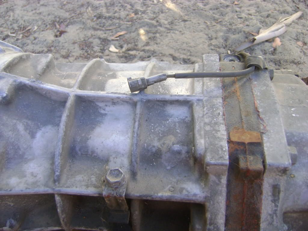

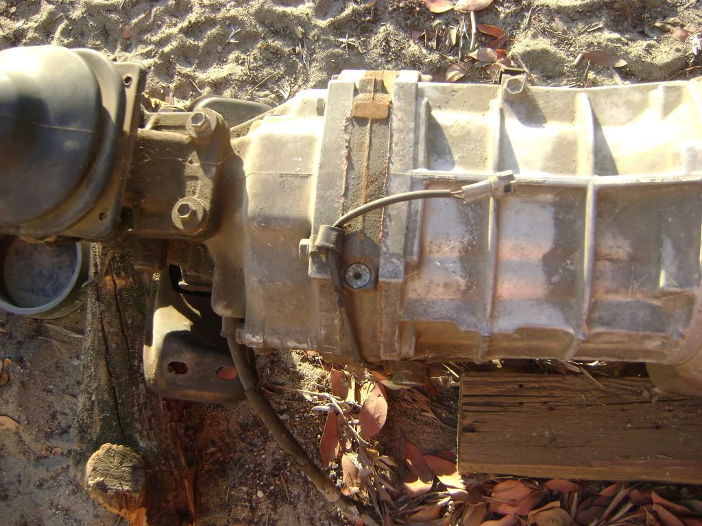

i just looked at mine thats layen down in my garage there is a its right on top of the tranny i will take a pic and download it if you need me to...? You should be able to get it though......

MA70_Powa;1402184 said:
cheers for the tsrm link, but an actual pic would be sweet too :)
does this help...? :naughty:

that pic does help, yes! I assume the auto one is in the same spot. I'll have to check on my car over the weekend, see if I can find it lol
