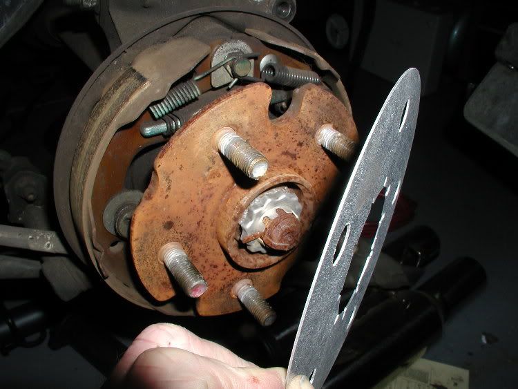

Here's how the MKIV TT kit mounts to the rear, if you're interested. Click pics to enlarge:
By the way, this is the kit that Jakespeed had made some years back.
