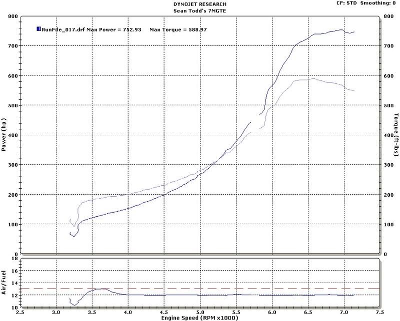

X-man;1021241 said:
We dynoed the car tonite. We made 753 rwhp and 589 rwtq @ 30 psi on stock internals.
Mods to the car are AEM, 1000 cc injectors , GT42, and 4 inch exhaust.
Here is the sheet.
I want to give a big thanks to Jeff, Manning, and Jamey. This was possible tonite because of them.
Sean

figgie;1021877 said:
Sean
refresh my memory
the GT42 is the plain jane GT42 not the R or RS (102mm) correct?
Yes Sir, you are correct. These pulls were made in 3rd gear and it spools quite a bit sooner in the 4th gear pulls.
How come just 3rd gear pulls? Wouldn't you make more power in 4th and it would spool up faster as well not to mention your graph would look much better and it wouldn't seem so laggy to some people on here. Great job again.
To hard on the dyno brakes stopping near 20 consecutive 140 mph pulls. We have a 248 Dynojet with a 4 ft diameter drum and they don't have really big brake shoes on them.
