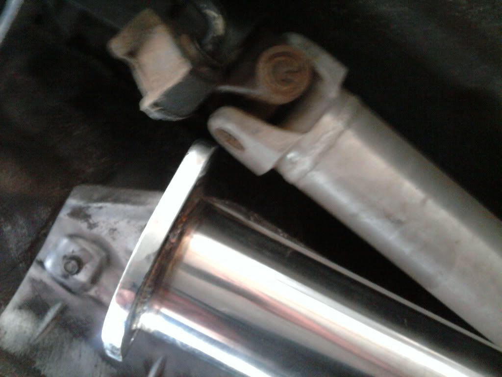

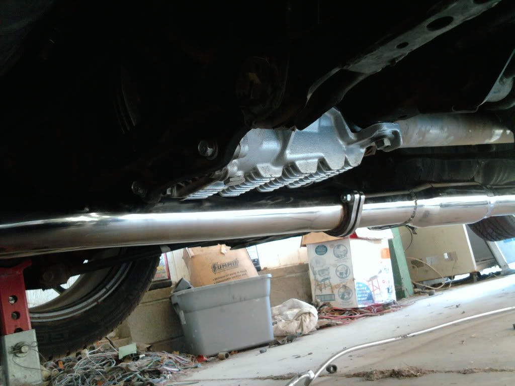

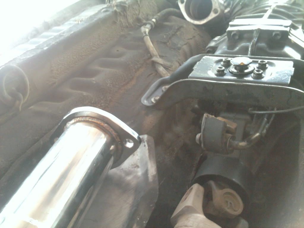

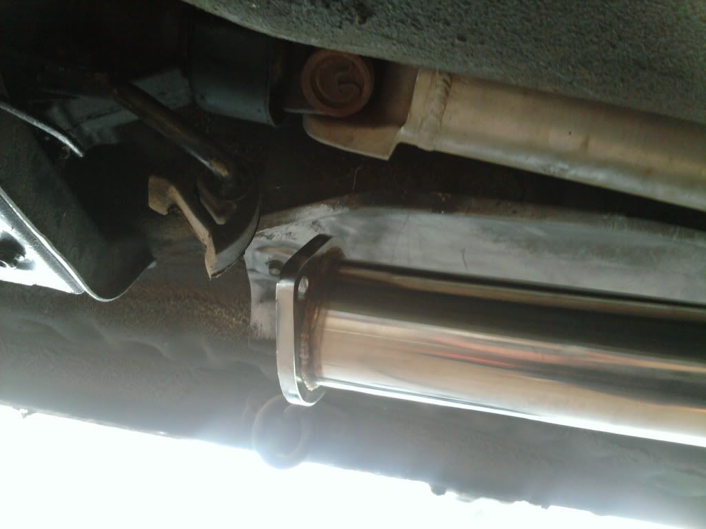

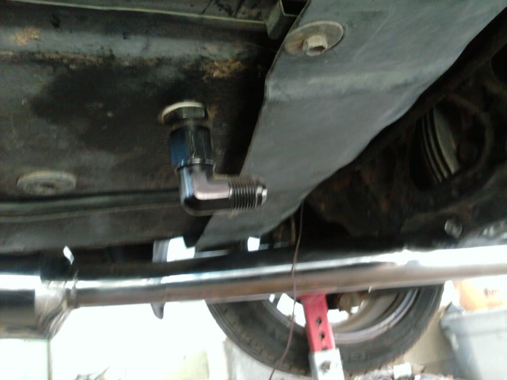

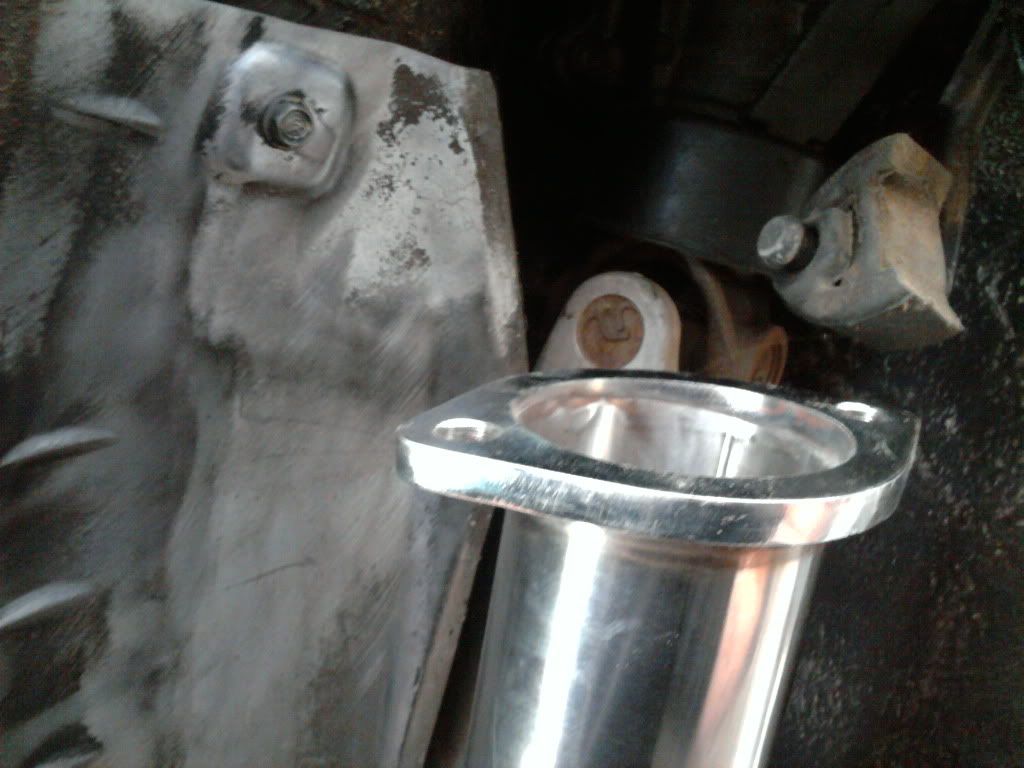

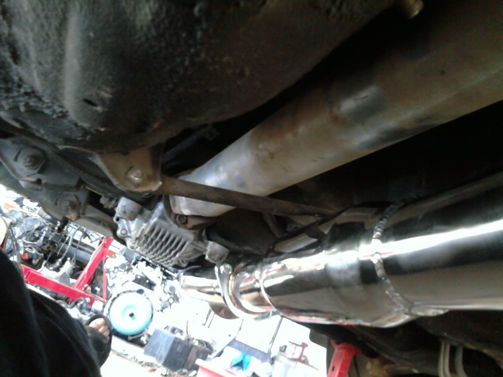

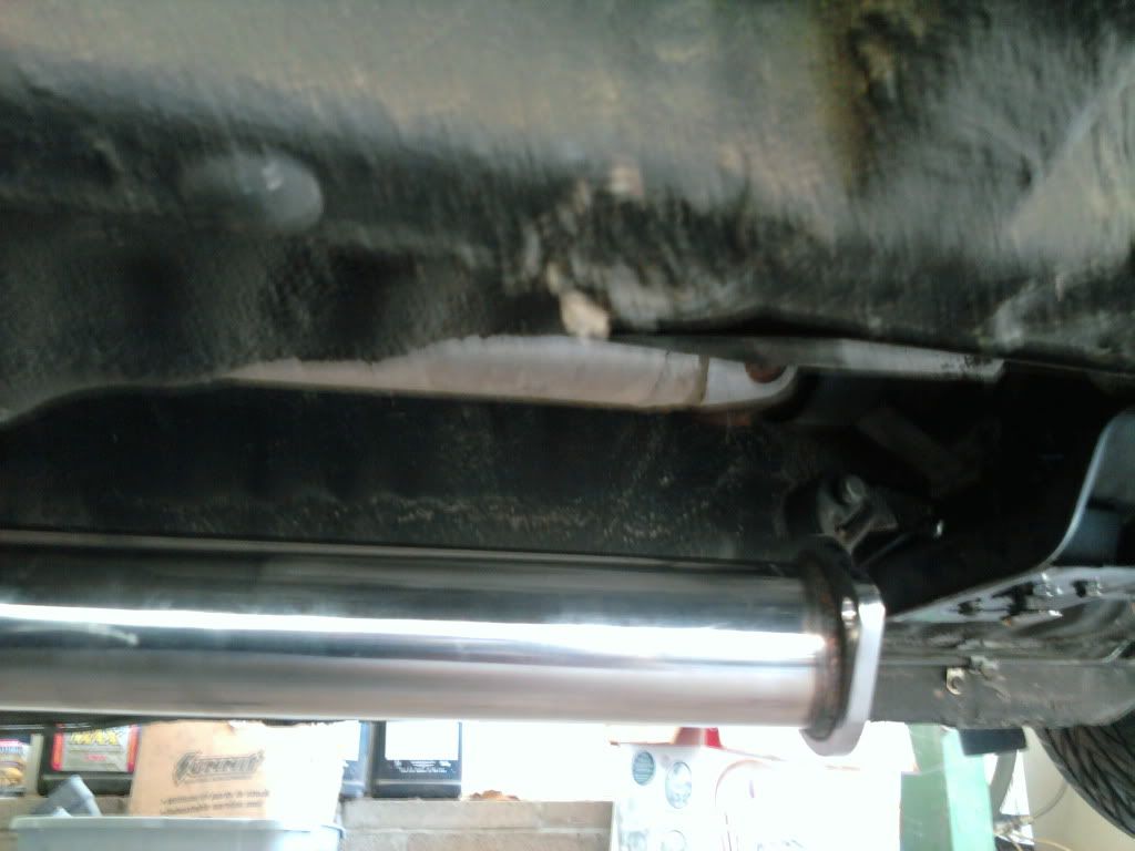

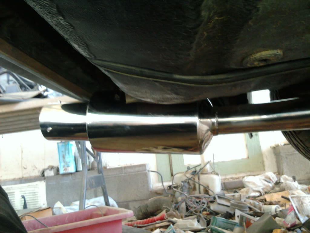

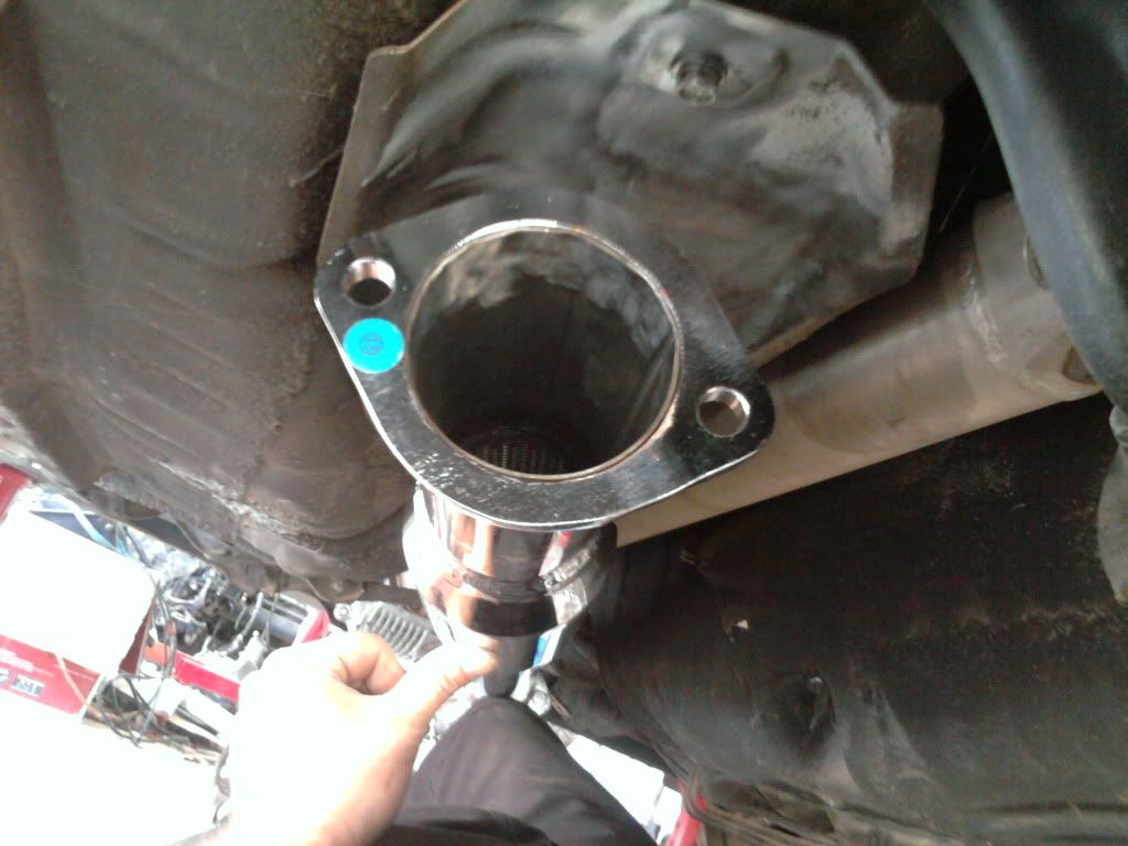

Ok here is what I found out about the exhaust from my experiance with fit and pictures.
The exhaust comes in 2 pieces with 3 non V band (2) bolt style bi-diamond shaped typical oem style flanges.
You may perfer to make it a single exhaust pipe with only one flang to save weight and make it simpler.
Now as far as fit you have two options.
It either fits 100% with no mods perfect clean fit!
However if you fit it this way, with the resignator facing the front of the car instead of towards the rear of the car you can not install your 3" race cat in the factory location under the heat shield you also can not modify the exhaust to install a CAT because the resignator will be placed under half of the heat shield.
So this exhaust will fit flawlessly 100% out of the box if you decide to run your car with out a CAT, but by running the exhaust this way you can not add a CAT there is nor room for it!
There is however another option I talked to aaron at DM about this because he has not seen the exhaust installed yet.
You can flip the exhaust around with the resignator facing the back of the car cut the flange on the resignator half of the exhaust and angle it like the streight end flange angle or weld the 2 pipes together to get rid of the flanges then simple cut the streight side of the exhaust in ~half add a flang then yes with simple easy to do welder modding you can install a CAT with triming and re-angleing of one of the flanges. I dont know if Aaron plans to modify it and sell it compatable to with CAT but its simple and any muffler shop could fix it for under $40
For the money this exhaust is well worth it it is infact 100% 3" stainless steel polished exhaust well worth the money even if you would have to mod it for adding your 3" race CAT.

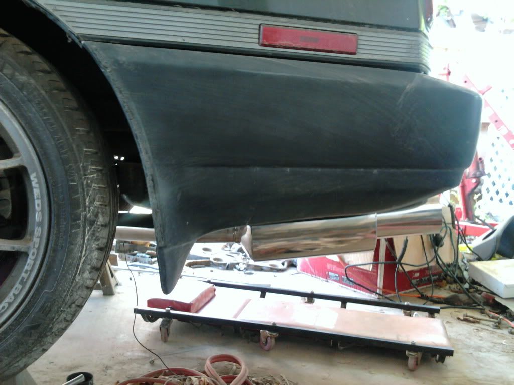

The back half of the exhaust for sure is a 100% fit.

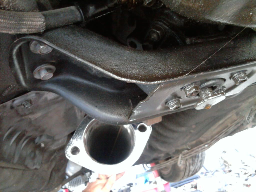

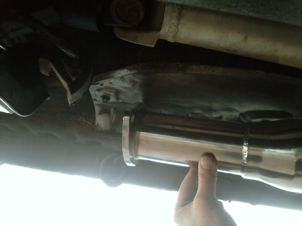

as you can see here look at where the front inlet ends up if you install it with the reisgnator facing backwards like factory

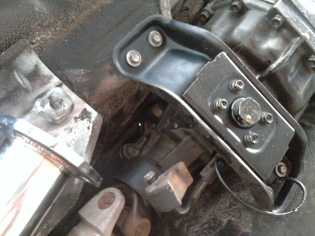

Now look at the install with the resignator facing forward
