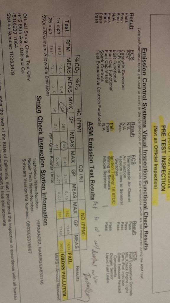

Hi everyone, like tittle says i need to pass smog . Took the car to a pre test and it is outrageously off. Results were
As of now i set the timing and got new fuel cap. I searched and lokks like i need to mess with the egr and catalic converter but im not 100% sure. I would really appreciate any help with this issue. Thanx in advance.

jetjock;1940127 said:
Check the EGR. It hooks up just as shown in the book. Your problem at 25 mph is leanness as shown by the O2 and suppressed CO. Since the engine doesn't appear to be in fuel control you should start there.

Sorry for the late reply, I just had a lot of stuff to deal with and just now getting back into fixing this issue . Yes it has a code 41 that won't go away I calibrated the tps to tsrm specs but I gotta take a look at the wiring, this is the code about right? I just replaced the upstream o2 sensor and I will start tackling stuff down .
Mando
Oct 18, 2012
25
east bay, cali
Thanks to all you guys with all the help and I know I'm not good at troubleshooting s*** . I don't really want to take the car to a mechanic because of $$$$ but I might have to. Also after setting the timing to 10° the emissions went down I'll post a pic right now .....
