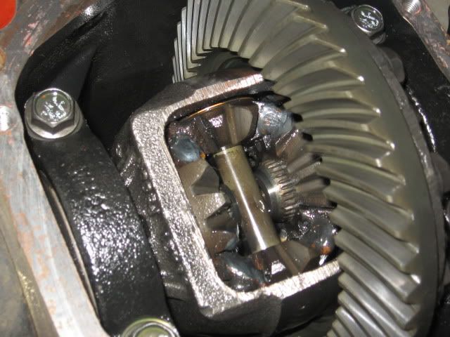

bioskyline;1741739 said:welded is a waste of time. the lsd is designed where if there is to much traction/diff bind it will let go to avoid breaking something. also alot of tracks now wont let welded diffs on the track, as its a saftey hazard if something breaks, as it can catapult the car in an IRS setup.
as for feel, a LSD/posi had same feel as welded in a stright line. in a 4x4 welded diffs are ok, as your going all over 10mph max on soft ground. for street they suck.
but there are 2 way to weld a diff
the right way

Hmmm, we'll see, I have a spare open one so im just gonna have it welded for funn
