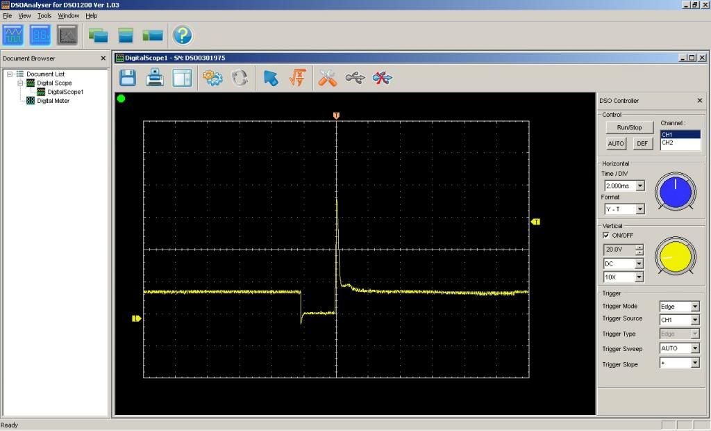

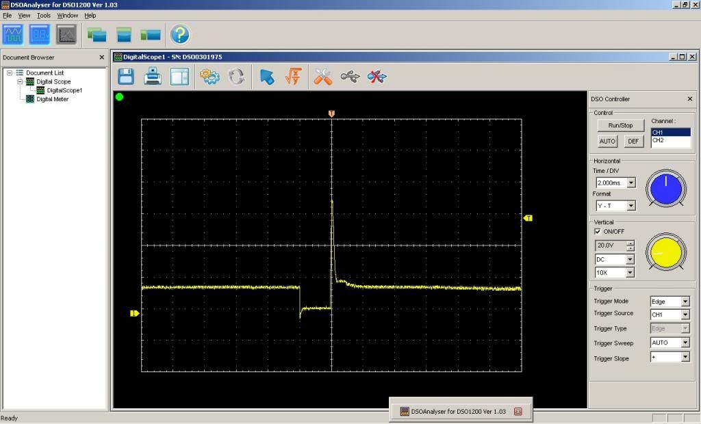

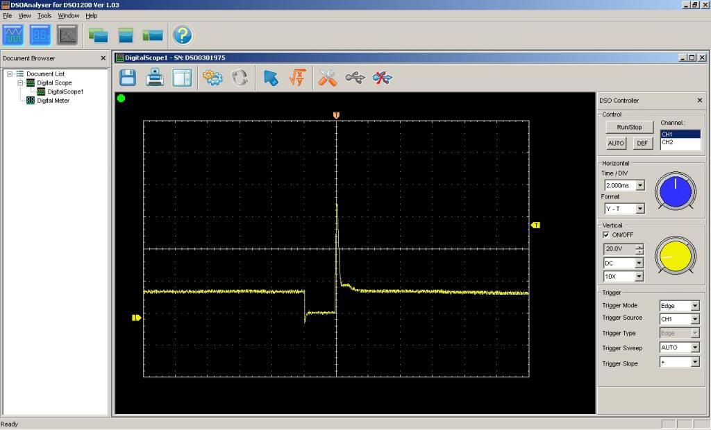

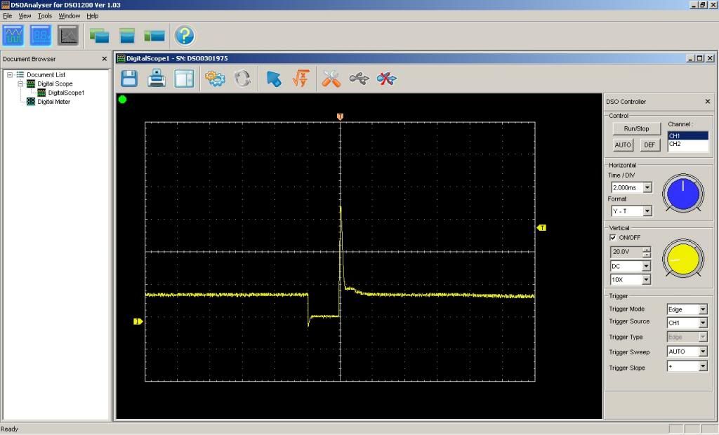

Went ahead and got a pattern for the injectors, here they are 1-6 Everything looks normal to me. These were at idle, nothing stands out at 2k rpm. Unfortunately I have no means to get a secondary pattern with the tools I have now, so I will have to find someone to do that for me.
I do have a question regarding the injector patters though, maybe you could help me out. I understand that these injectors are fired in pairs, so each pair of injectors has a common switched ground. Does this mean that when I scope for instance the number 1 cylinder injector, I am looking at the injector pattern for both #1 cylinder and #6 cylinder? How could I only focus on one injector at a time? Would I have to disable the other?
