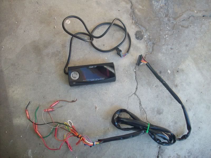

Need help wiring up the SAFC-II on my 1JZ if someone can point me in the right direction of where to find the diagram and instructions, thanks

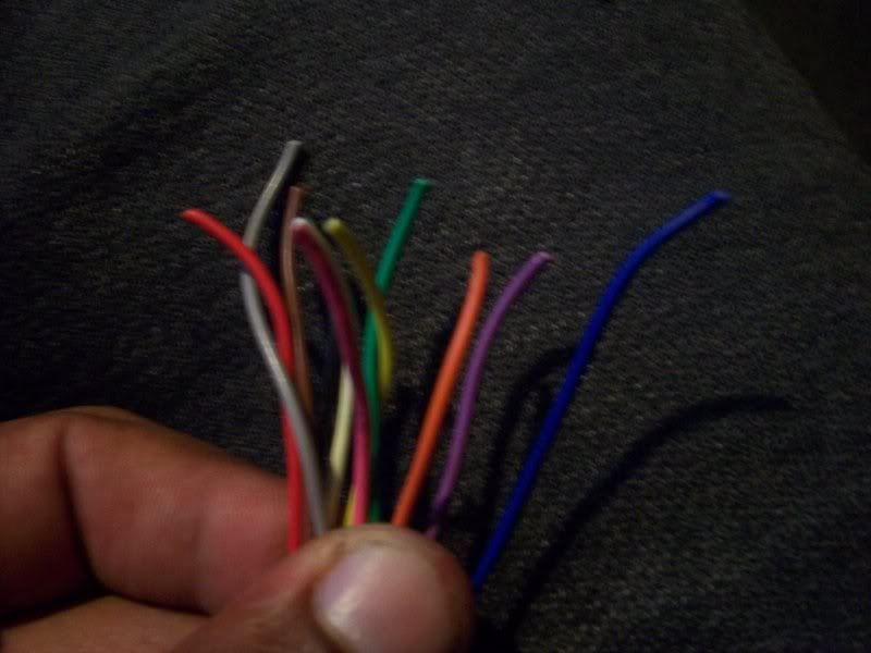

okay thanks for the diagrams but now im trying to figure out what each wire is i keep looking at the apexi-usa website but what is each wire,

this is what i used:
RED - Ignition Power
GREEN - RPM signal
BROWN - Ground Wire closer to ECU
BLACK - Ground Wire farther from ECU than brown wire
PURPLE - Knock Sensor
GREY- Throttle position sensor
YELLOW - Air Flow Signal wire going to ECU
WHITE - Air Flow Signal from AFM/Pressure Sensor
BLUE - Optional for Reading Oxygen Sensor Voltage
