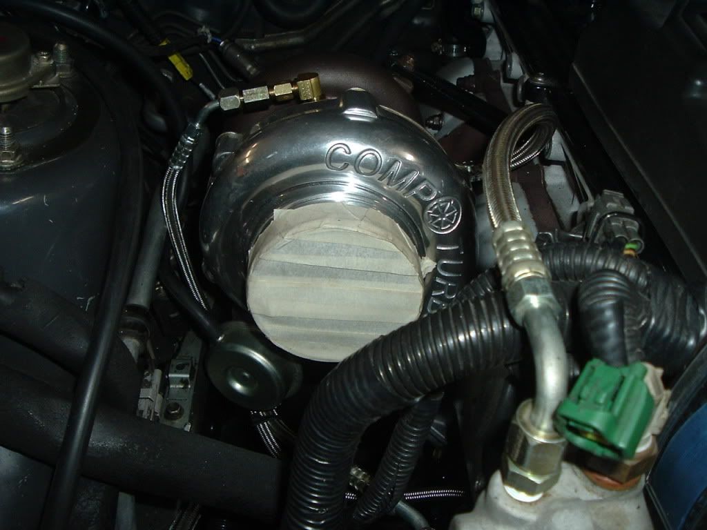

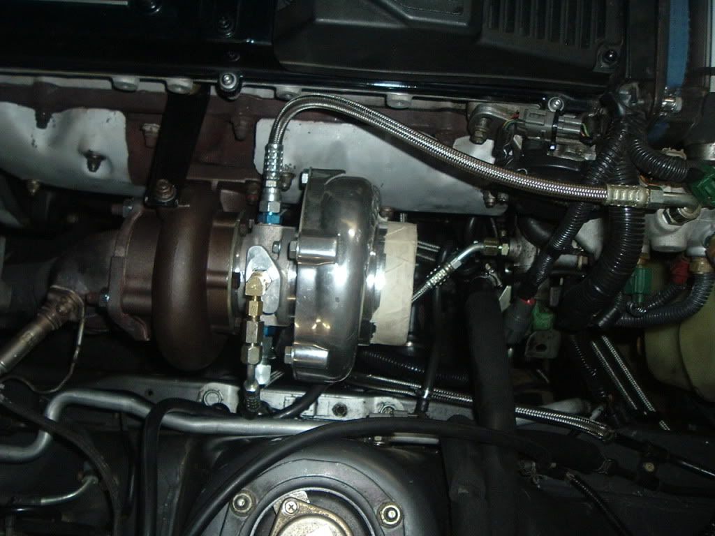

Lipp BOSS Sr. GTS 60-1 with Triple Ceramic Ball Bearing center section will get the job done also. Bolts onto factory manifold and downpipe / turbo elbow. Fitment is excellent, and I couldn't be happier with it.
One thing to remember when going with this largo of a turbo / hp numbers, there IS lag. If I were to do it again I wouldn't have told my self the same thing what you are also saying "500+ hp" and went with a smaller turbo where the lag in much less. With the lag there are several moments when your yelling at the windshield, " come on, spool up already". But once it dose hold on for dear life. If not careful 3rd and some times 4th gear at 70+mph the car will kick out side ways and spin you into a world of pissed off-ness that you don't want to go into.

I will concur on the Boss Jr. I know of all the complaints of SupraSport, and their "failure to communicate", but my product from them is very good. In fact, all the products of theirs that I have gotten are very good. The Boss Jr wasn't meant for 500 hp. Keep that in mind, but meant as a more reliable and powerful upgraded CT26. Their T04E Sr line will do it, and it is bolt on. Get the intsall kit while you are at it. Go to the turbo review for issues I had.
