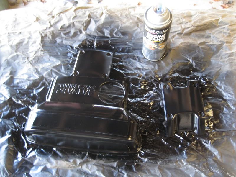

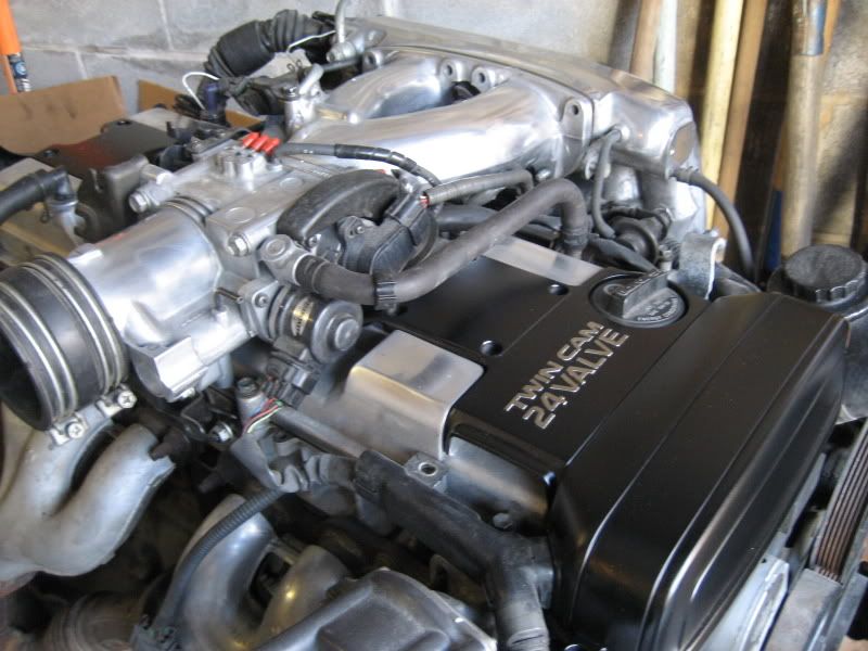

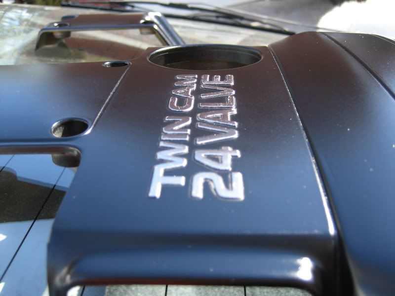

Well this weekend the woman wasn't at my house bothering me and taking up all my time! LOL. (hope she doesn't read this). Anyways, so I got to do a couple things that I have been wanting to finish up while I await my steering rack to get here. The first and least significant of the 2 was repainting my timing cover that was silver and came from a lexus. So I popped off the lexus emblem, masked off the letters, and painted it black. Looks much better now!! Here are some pics.
Here you can see where I taped off the letters and the glue still on it from the lexus emblem. Also what I used to mask the letters off. Pretty good huh?

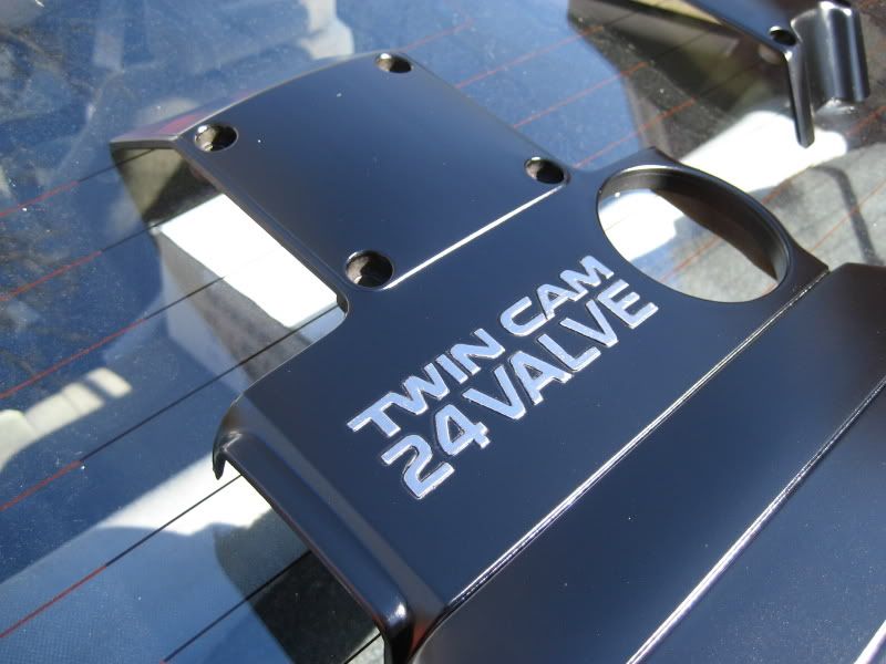

Here's the two pieces painted.

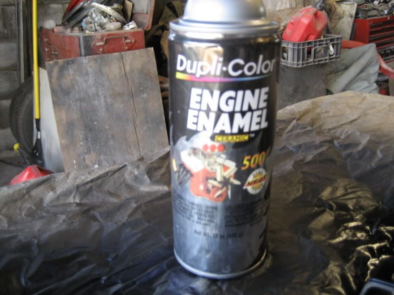

Here's the paint I used. From advanced.

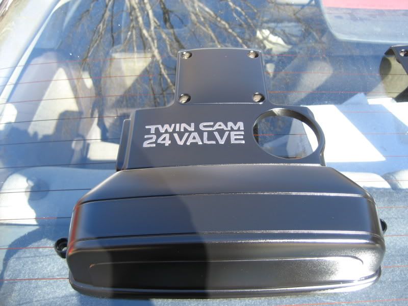

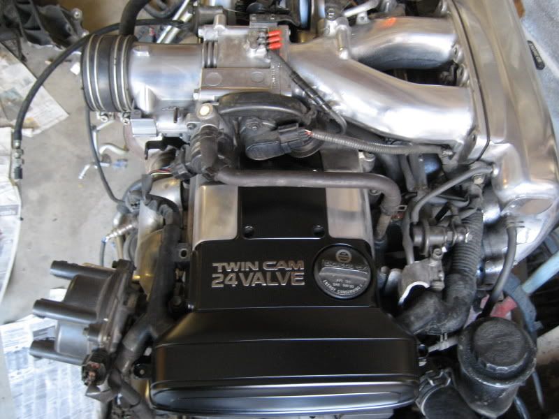

Finished product!!!
Back on the motor! Looks much better IMO. Very happy with the results!

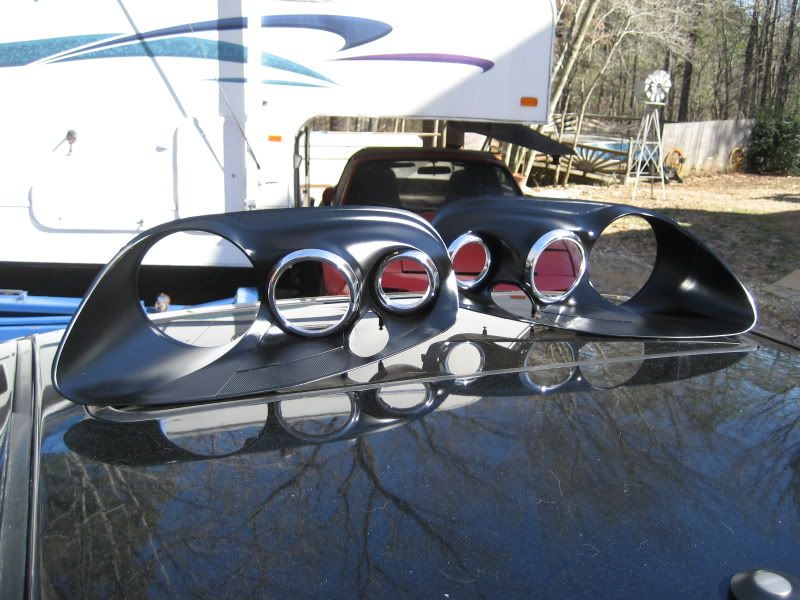

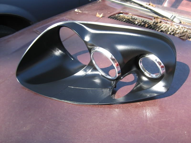

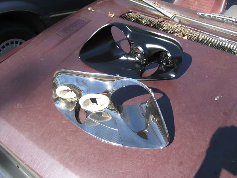

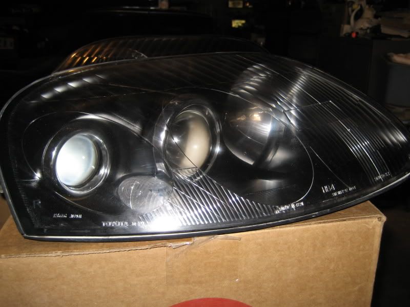

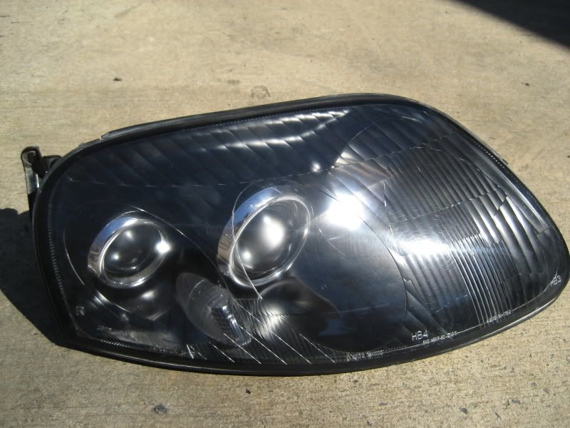

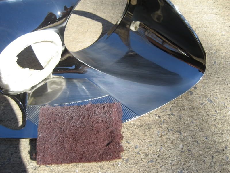

Well the second, and most significant, thing that I did was my headlights. I was a little intimidated at first but once I started I was suprised at how easy it actually was. I don't have any pics of disassembly, but its pretty straigt forward. I just used a heat gun and heated up a section of the headlight where the 2 pieces come together. Let it get hot enough and just pry the 2 pieces apart with a screwdriver very carefully. I would work on 1 spot at a time until I got the whole thing done. I felt more comfortable with the heatgun than I did sticking the whole thing in the oven which is another way to heat up the glue. But here are pics during the sanding and painting process.

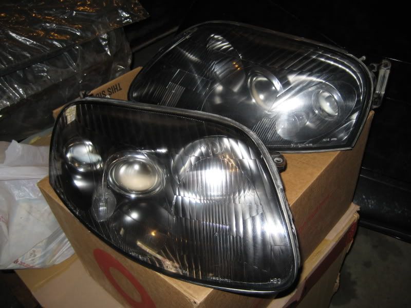

Started with this

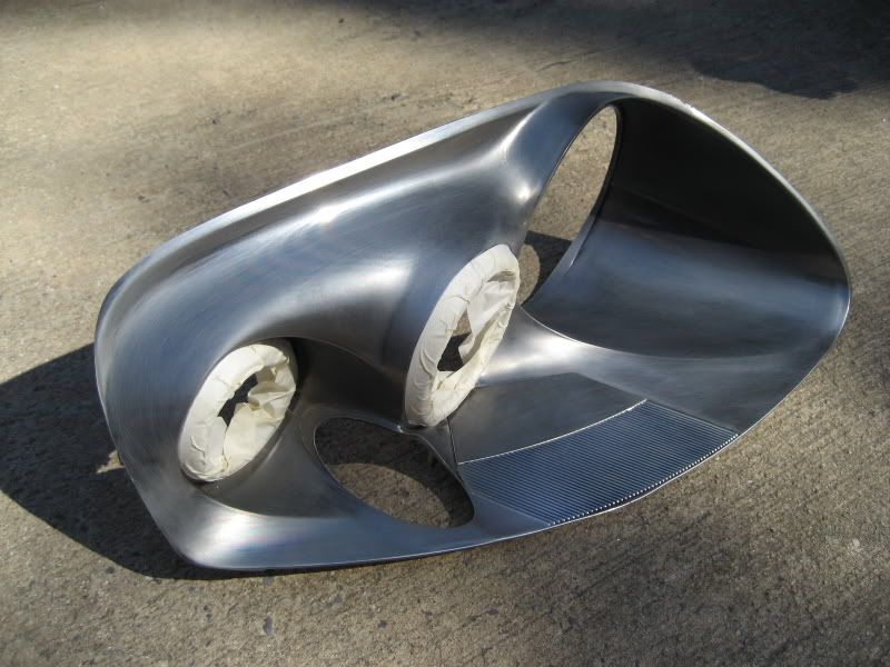

Started sanding with "scotch brite"
Fully sanded

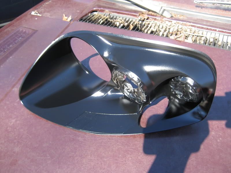

Painted using the same paint as the spark plug cover. Duplicolor high heat
Before and after
Masking tape removed
Both done

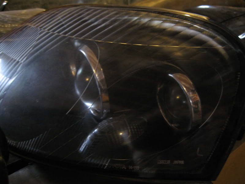

Finished!!! (well I still gotta re-seal them, but thats it)
