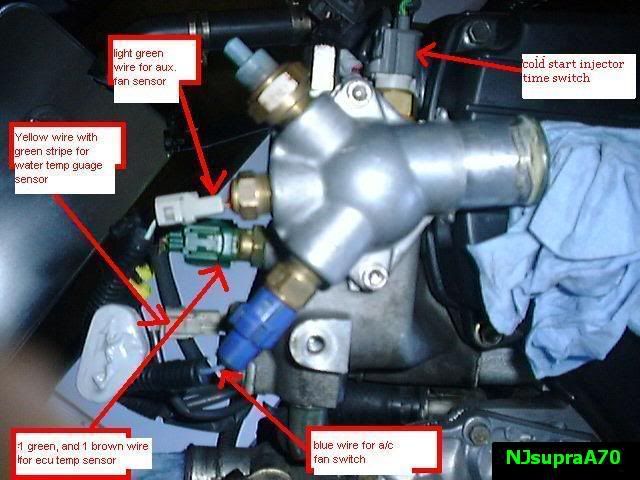

Turn the key on and ground the wire. The fans should come on. If they do that wire is supposed to connect to the single terminal sending unit on the *radiator* side of the T stat housing but if there's more than one terminal on it, it's not the correct one. Somebody will come along and put our generic T stat housing pic up. I don't have it handy.
