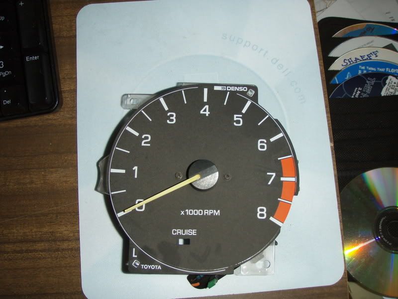

Here, I took some pics of a tach I had laying around, click to enlarge:
Here's what you need, boxed in red. Apparently I didn't make the print large enough. LOL. :
And here are some random close-ups of different angles:
