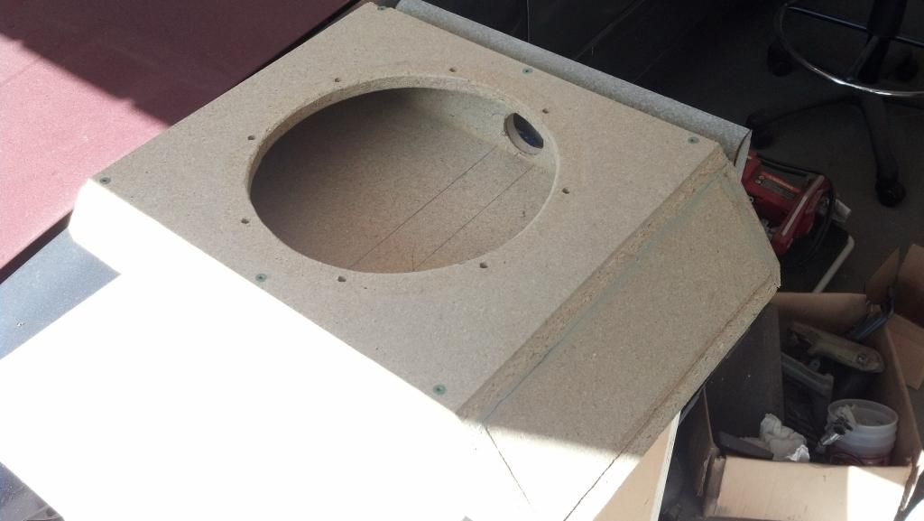

I had begun to fiberglass a spare tire sub box, but decided against it at the last second. 1)- I want to carry a spare tire, and 2)- I was afraid that the sub would cause the rear deck to rattle if it was mounted below.

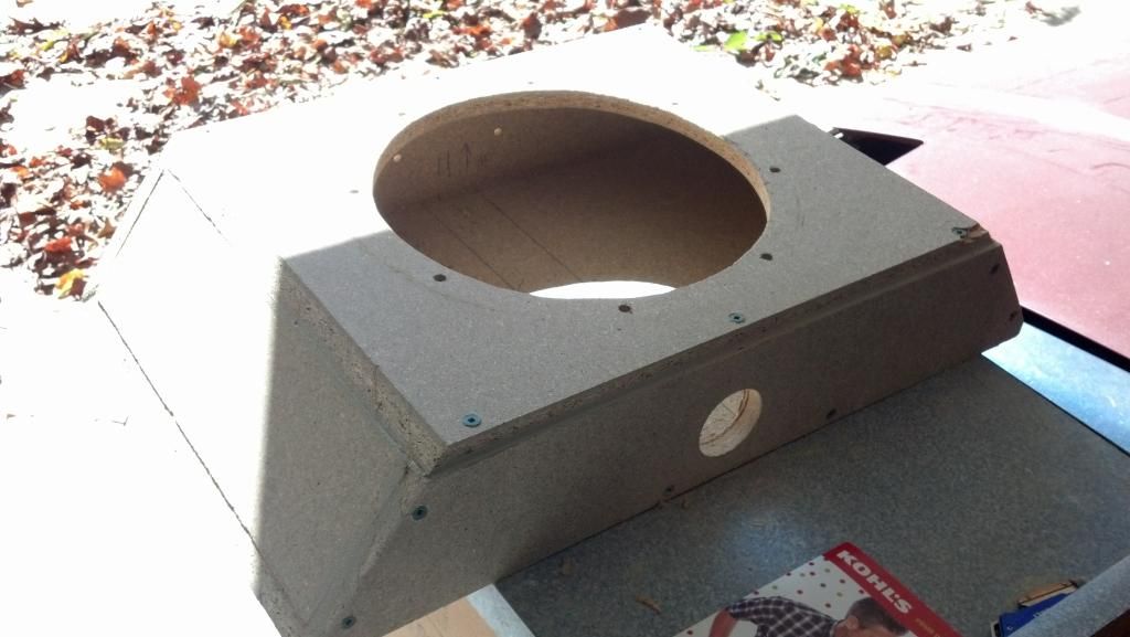

Anyway- this is it. It's roughly 5"x16"x18", in 1/2 MDF. I could have gone thicker, but I didn't feel the need. I only plan to run this at normal levels.
The sub itself, is a Pioneer TS-SW3001S4. More than enough for my future system. I just wanted a sub that I wouldn't have to move around if I took the targa off.
Ideal enclosure size is .5 to 1.0 cubic feet. I figured this one out to be roughly .6
Basic construction, sealed with construction adhesive/ sealant, and screwed together. Sub mounting holes have T-nuts imbedded on the inside.

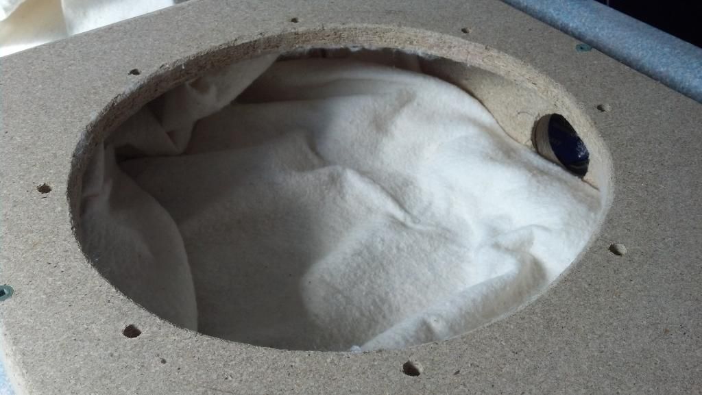

Added cotton batting to reduce resonance/ rattle.

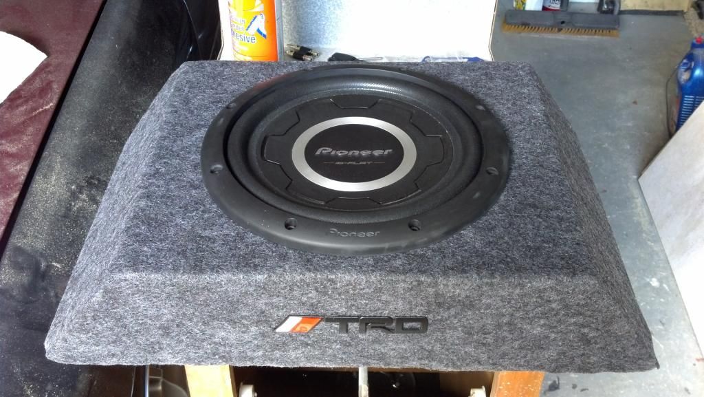

Covered in carpet, rear terminal cup added.
Added some bling.

Thank you for adding to the car audio lol very clean! You are right about not needing thicker I use 3/4" but I blast bass [emoji48], should sound real nice! Would be nice to see how it fits with the targa on top.

Looks awesome! I did the same thing with my first supra by building my own 1 cuft box for my Sony Xplode 12" sub back in the late 90's. It worked great and fit under my Targa perfectly. Where did you buy the outer coating? When I did mine I never covered the MDF (although I did paint it black). I added Velcro to the bottom of the box so that it wouldn't slide around and ruin my targa (or anything else in my trunk).

I wasn't sure what I wanted to put on the bottom. I was considering bonding a ribbed rubber mat to the underside, to eliminate sliding.
The cover is a dark grey 'sub box' carpet. Really cheap stuff, but it looks ok.

The Velcro worked great on my box. It keeps it in place really well but seeing as you have carpet that's out of the question now I think. You might be able to adapt something though. Maybe you can put some low profile 'feet' on it and put some Velcro pads on them.
