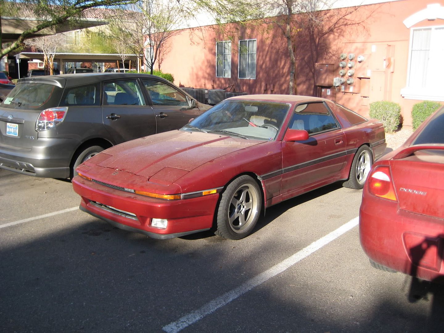

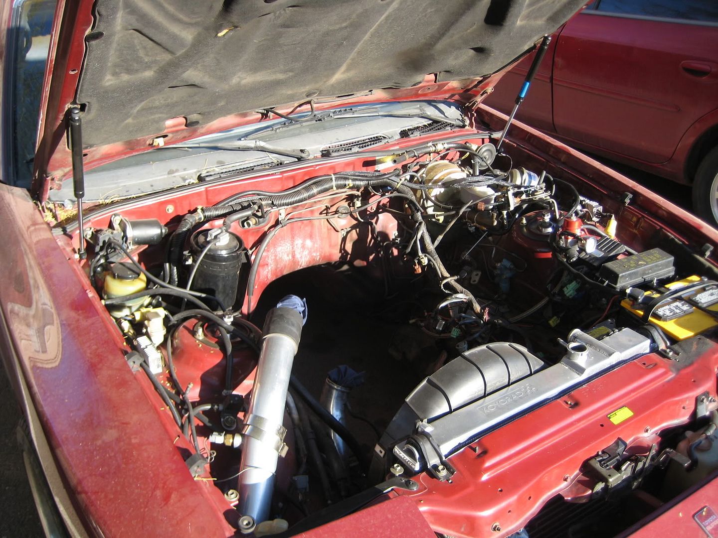

Haven't updated in a while, here are some recent pics of the car! The motor has developed a bad smoking problem, it is burning a lot of oil. Engine is coming out soon to see what happened.
Also, took my car to the track recently and ran a 13.7 with a 2.5 60 ft:nono: Trapped 112 mph. Def need some tires.
Will be updating when the engine is apart and I figure out what has gone wrong.

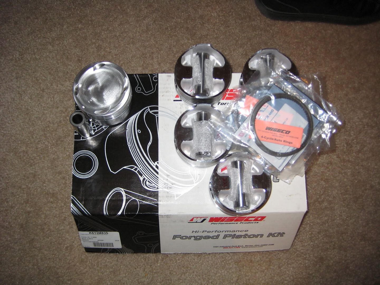

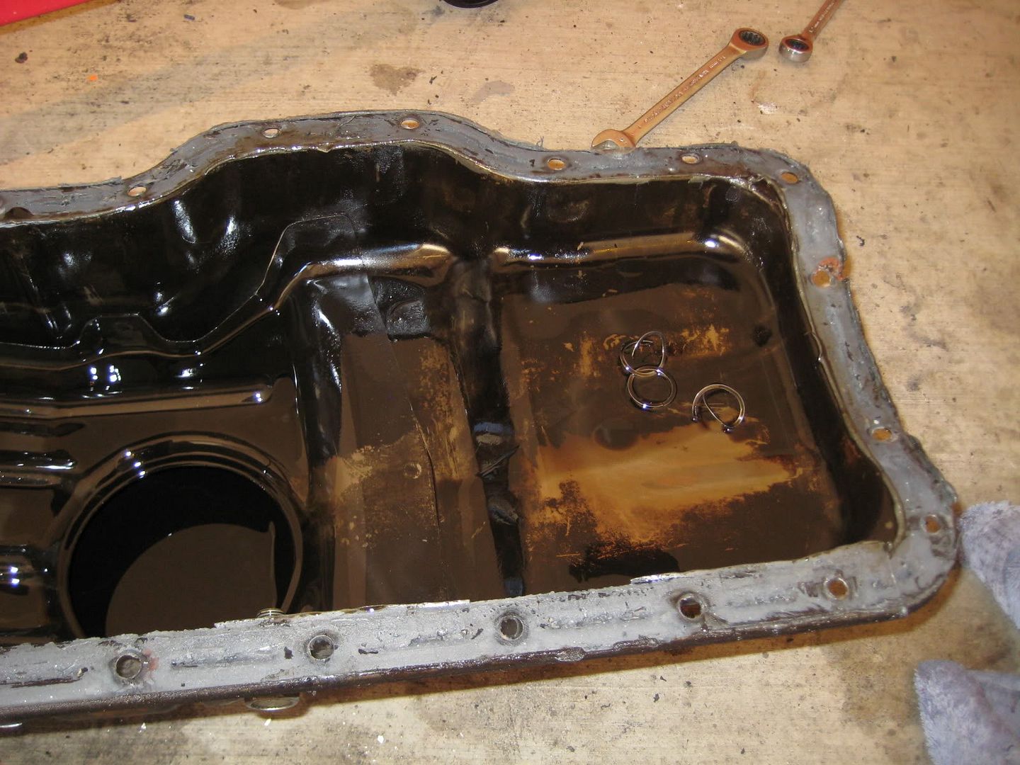

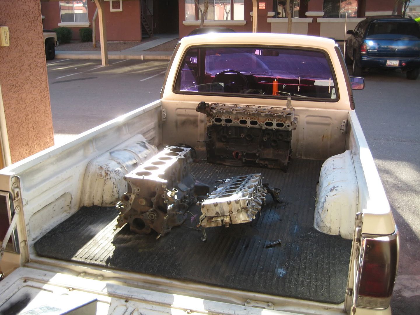

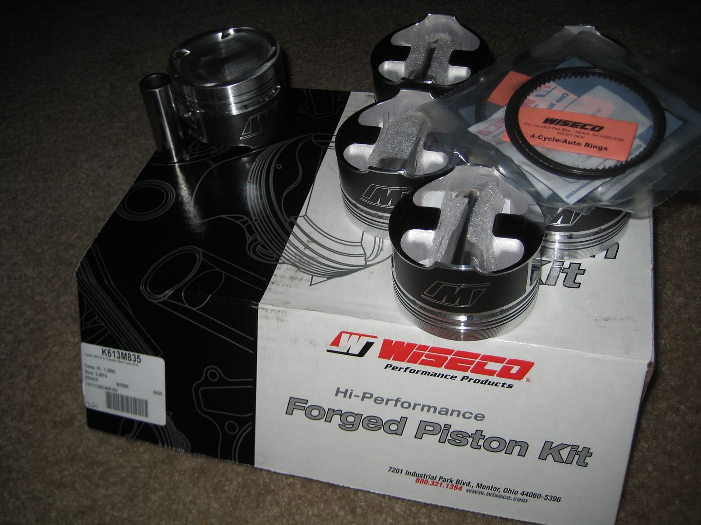

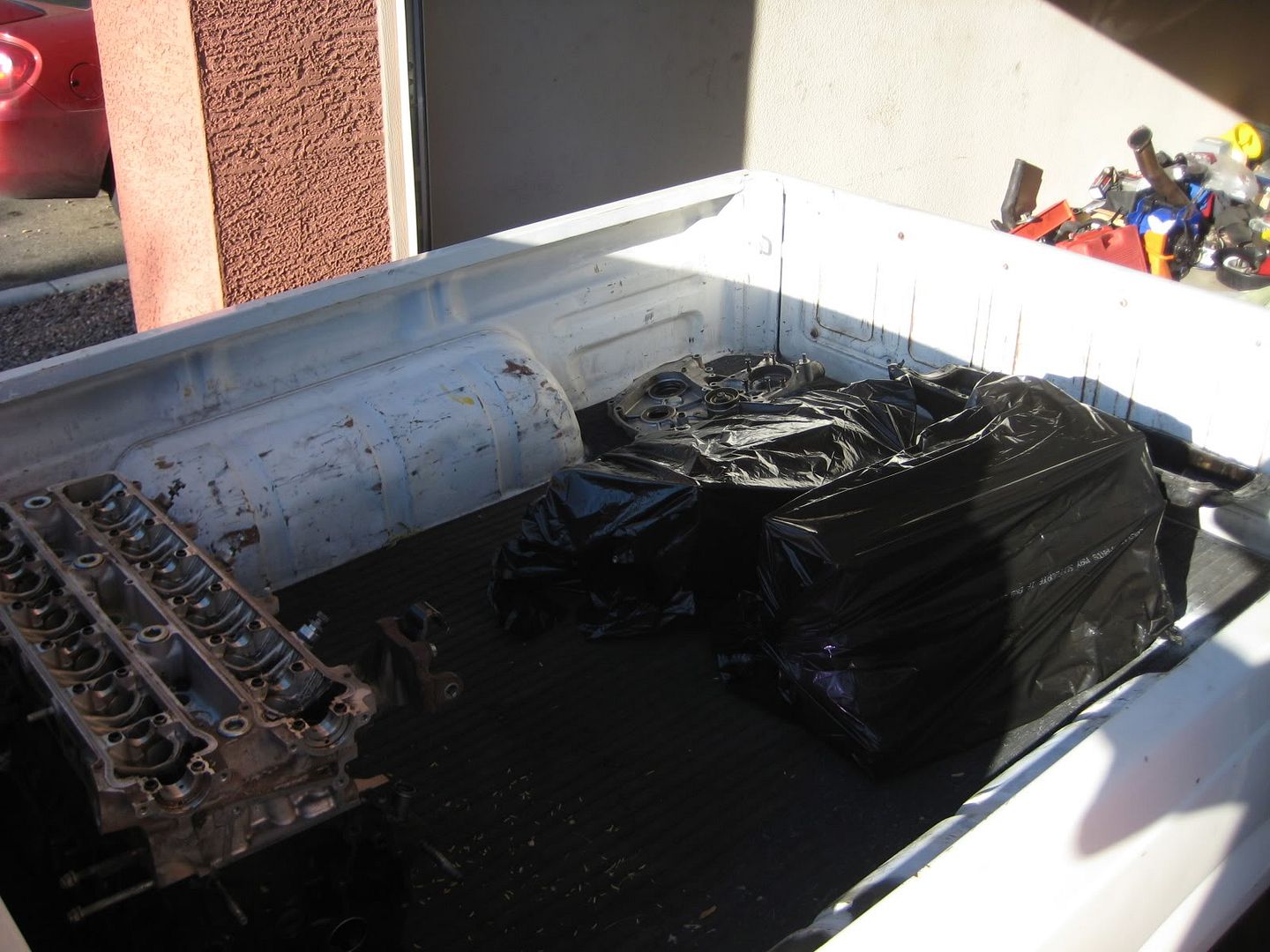

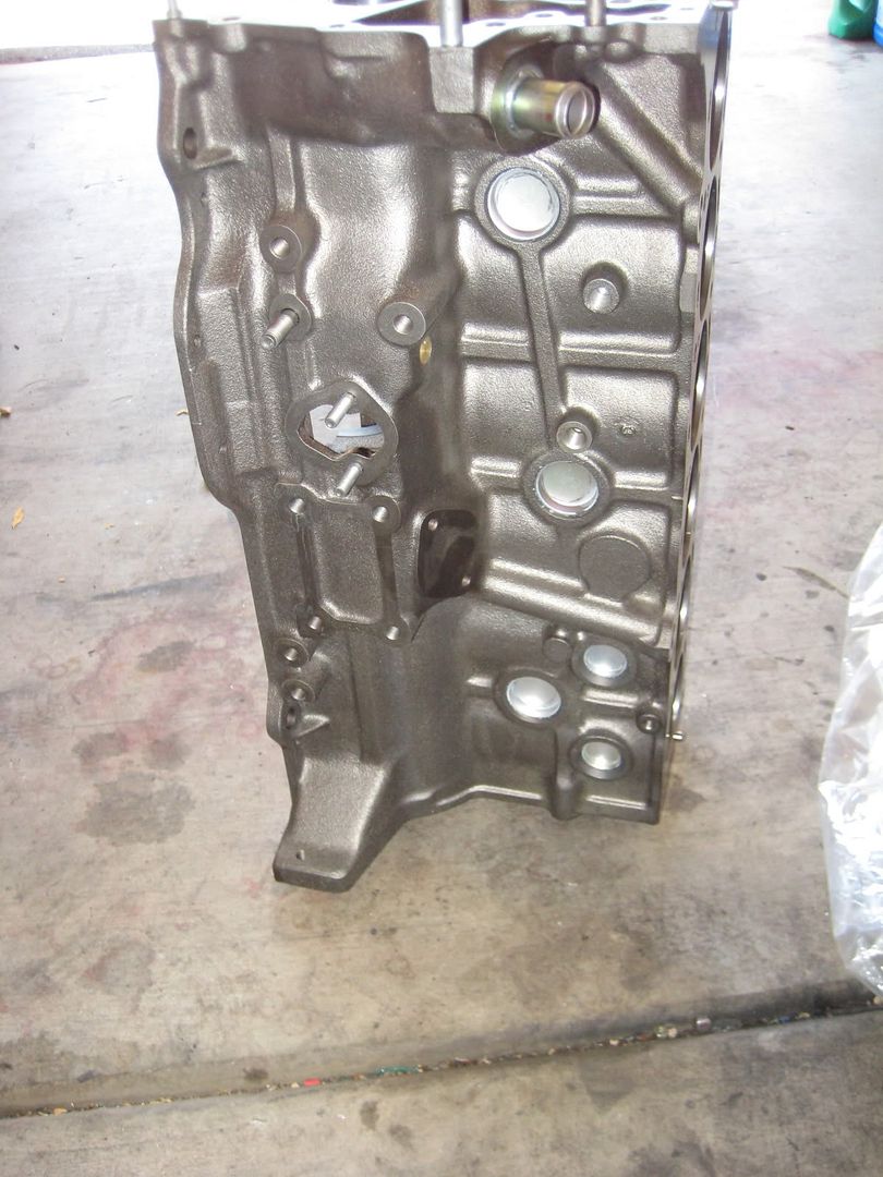

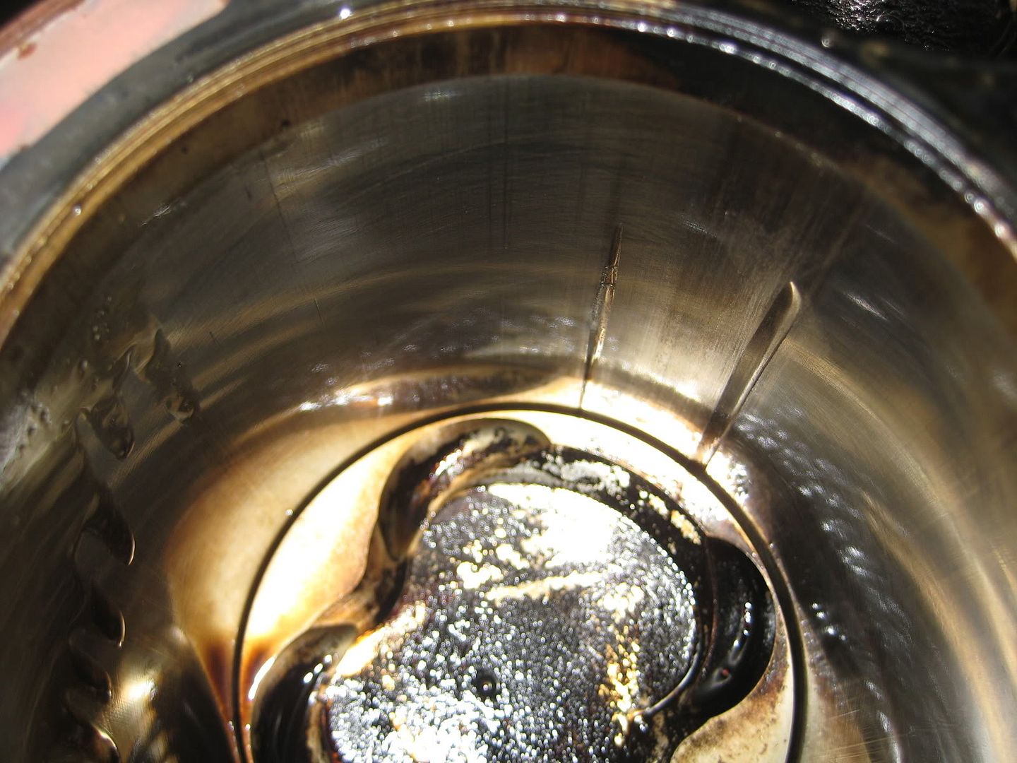

Update! Tore the engine down and found that the spiral lock grooves on my Probe pistons had somehow worn out and let the locks jiggle around in there until they finally popped out and let the wrist pin dig into the cylinder walls...

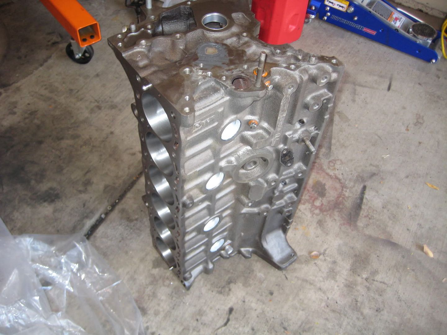

Block is junk and was scrapped, got a hold of an NA 7m block from a cressida, going to be using that for my build. Using Wiseco pistons this time around.
New pistons

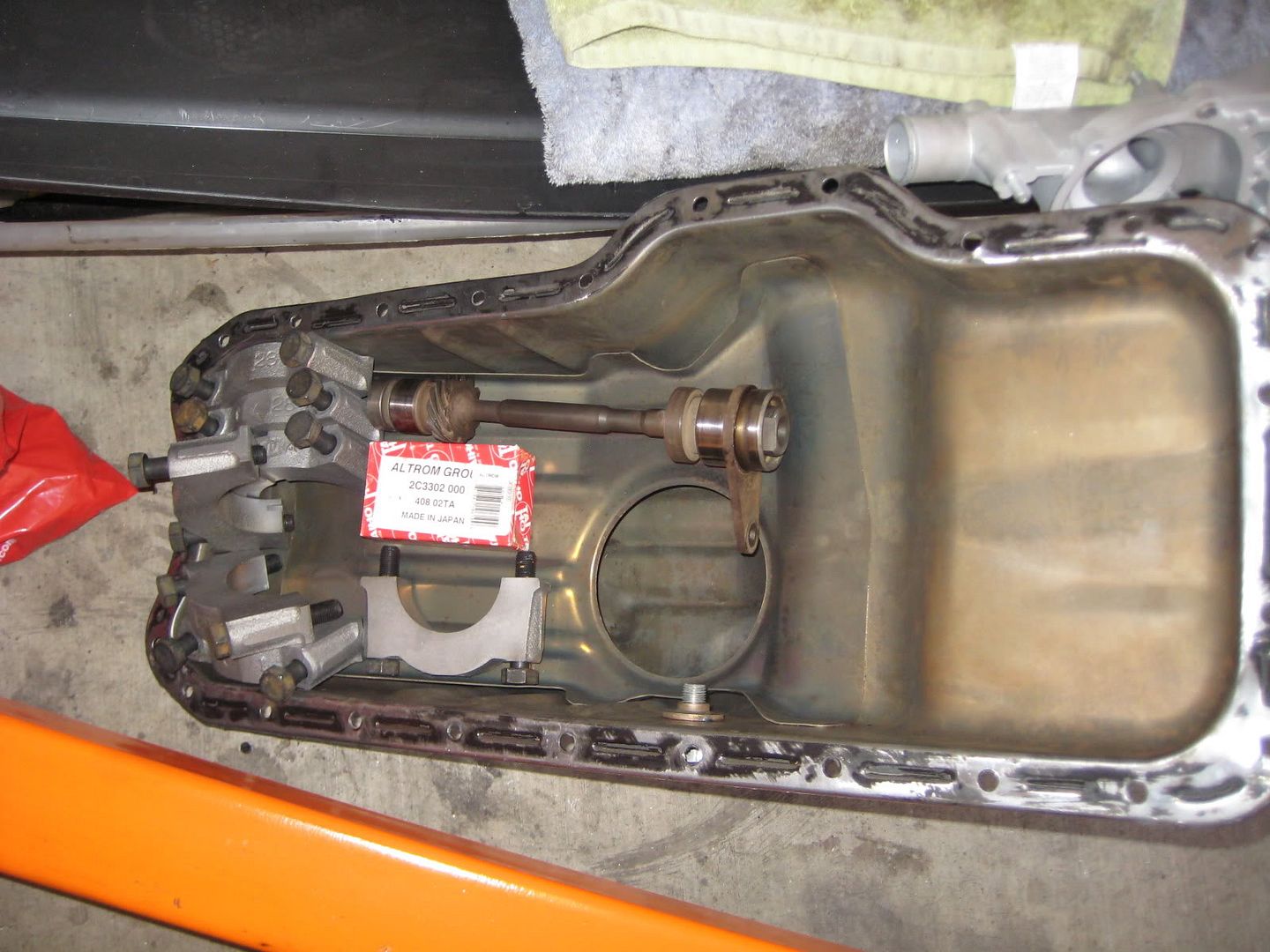

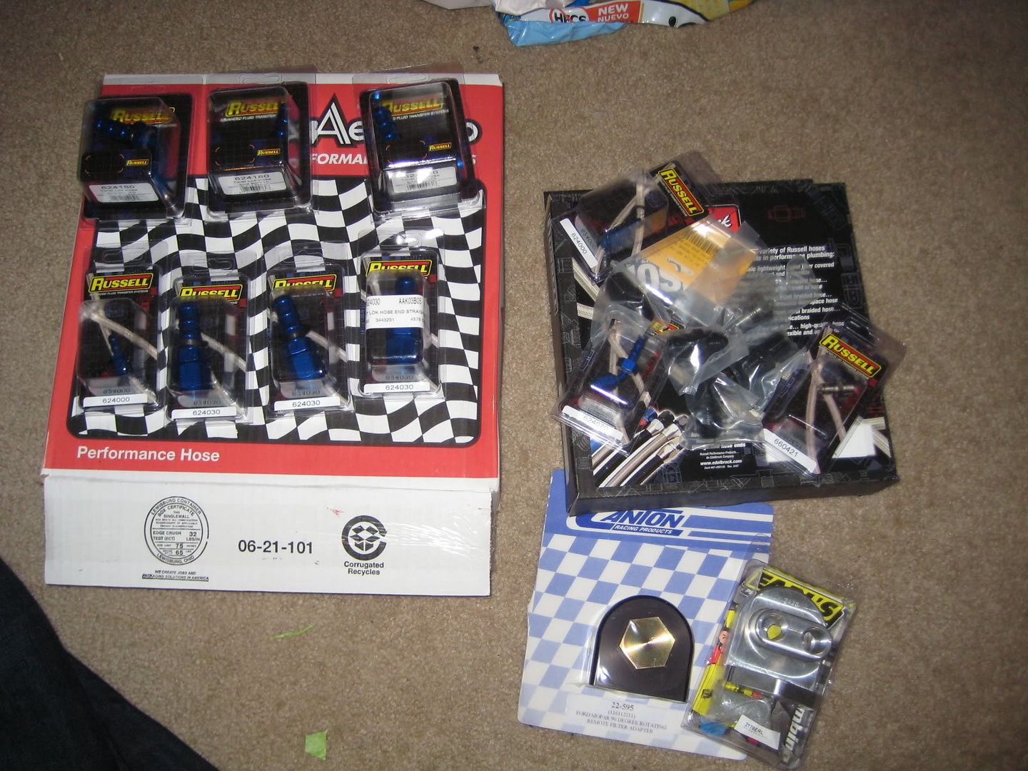

New lines and fittings for oil filter relocation and ct26 softlines. Went with pushlok hoses and fittings. Will be installing a fill flow cooler eventually.

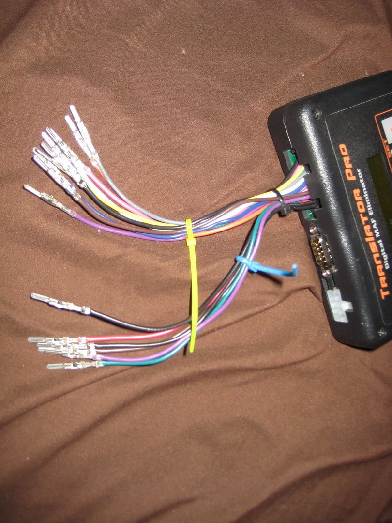

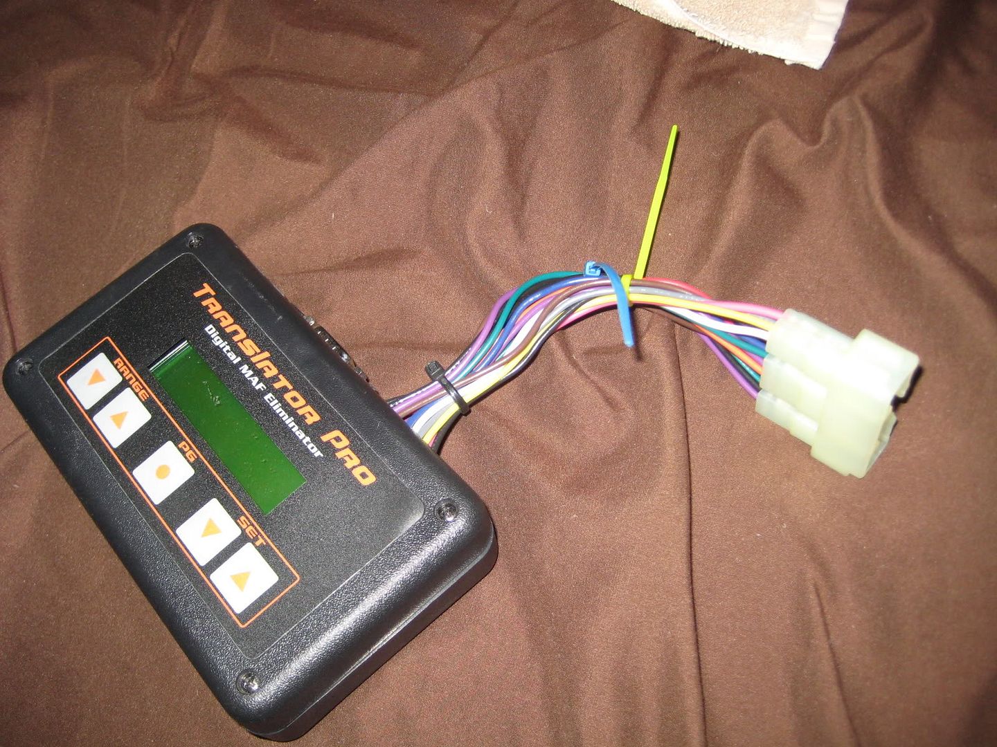

Wasn't happy at all with the stock connectors on the Maft Pro. Not only did they jiggle around and cause intermittent connections, but the pins were so small and weak that they were very easy to break, ended up breaking a couple pins before I decided to do this... Ended up soldering the wires directly to the main board, then used my own high quality connector.

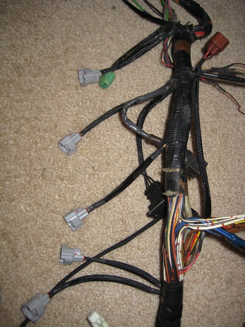

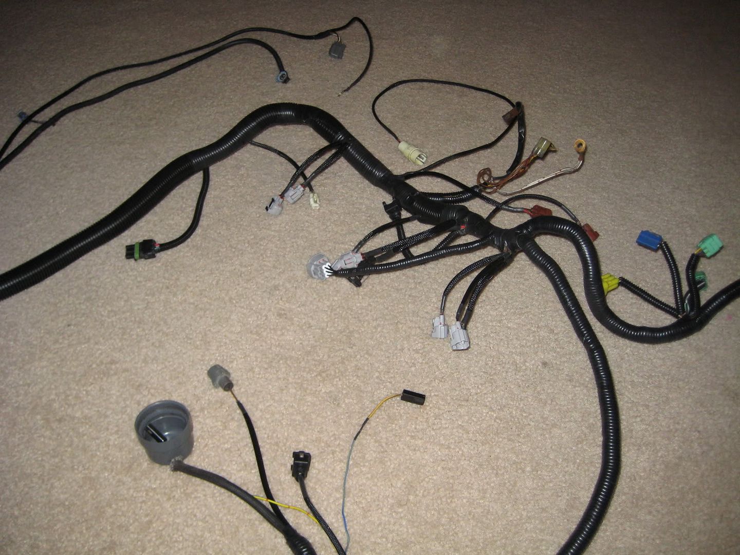

Doing some repairs to the harness. All new injector connectors, sensor connectors etc. All new loom yet to be installed. Shouldn't have any more issues with this harness :)

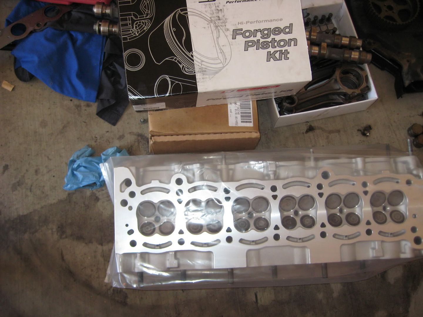

That's it for now, should have the engine back from the machine shop on Monday. Its getting a bore/hone, resurface of the head and block, new oem core plugs, oil pump shaft bearings, oil pump bushing, valve job, etc.

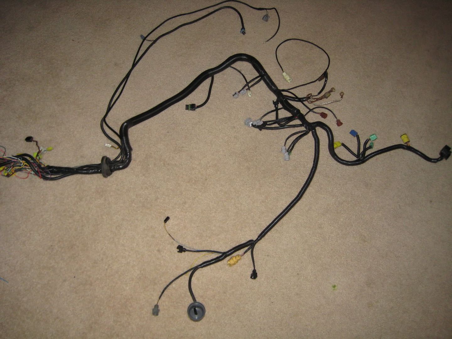

Harness is completed! Fully plug and play for my maft pro now. New connectors for injectors, tps, iscv, o2s, water temp sensor, csi, csi switch. Cant wait to have a good condition harness on my engine.

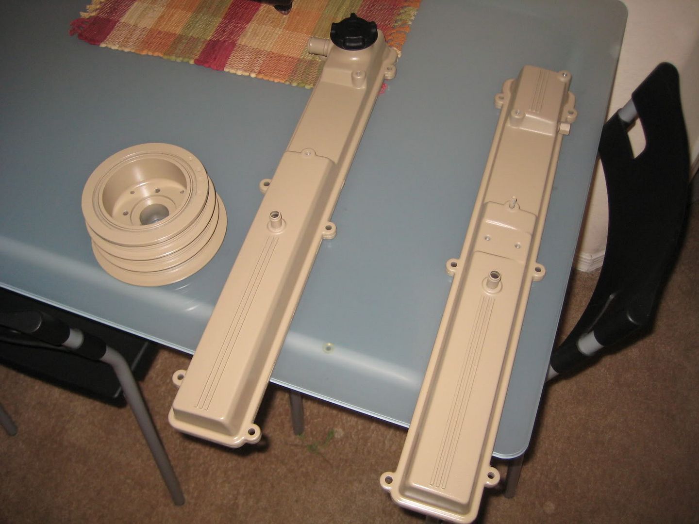

And my color scheme :)...Cummins beige. Don't ask why because I have no idea! Engine coming back from machine shop on Friday, pics to come.

Do you have a parts list and where you purchased all the connectors you replaced? I've found and purchased most of them- from driftmotion and 'eastern beaver' company, however, theres a few I can't find.
CyFi6
Aliens.
Oct 11, 2007
2,972
Phoenix
www.google.com
Zumtizzle;1810628 said:
Lol yep, and your plug wires are still going strong as well.
Almost all of them were through driftmotion, the csi, water temp sensor and csi time switch were all identical to EV1 injector connectors (this is for pre-89). Eastern beaver has the connectors for the VSV's.
