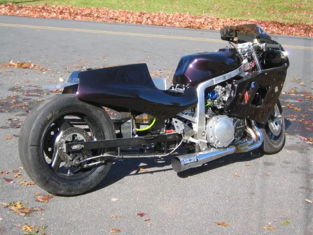

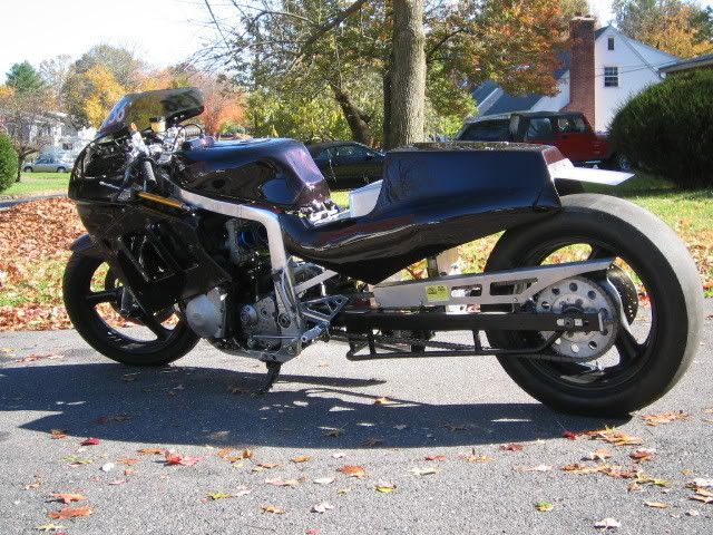

Been holding off slightly on the Supra to get this pile of hot garbage done...My 91 Zuk 1100 Drag bike. Here's some pics on the build...
Heres how i got it...Bare, motor in a box(lunched a piston from too much spray), and shitty wiring all over the place.
Got the engine back on one piece. Made 185hp/105tq on the engine dyno. Specs are 1277cc, 13:1 custom nitrous pistons and Carillo rods. Stock head/cams with slight port work.
Did some fabricating...
And some wiring...
Exhaust on...
And painted the same color as my Supra...
Little blue bottle...
Riders view...
Bike should go 9.1s on motor and 7.9s on Spray so we'll see what happens!
Lemme know what you think!

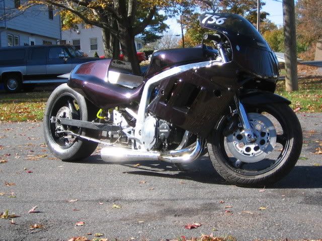

Got her out on the street for a minute today and did its first burnout :)
Here's some more pics in the sunlight, and i might have a little vid of the burnout later if anyone's interested....
