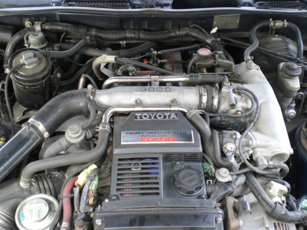

Yes, that's what i planned on doing. Can anyone Point out on the Picture i posted above wherabouts the Sensor for the Heat and Oil Pressure gauges are? Thanks in advance
Mrbaboon
Jul 13, 2006
277
Victoria, BC
Sensor for water tempurature is a spade clip on the thermostat housing.
Oil pressure is on the passenger side of the engine block, close to the front, near the bottom. The sending unit itself is gold in color and should have a rubber boot over it. You might have trouble reaching it without removing the accordion hose as you still have your power steering.
