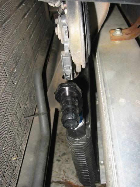

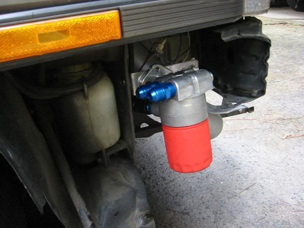

I installed the above-mentioned fasteners into the front timing cover, and also installed my Long oil cooler behind the intercooler, and before the AC condenser. Next I will install the remote filter mount and Tstat up front under the passenger headlight, and start running the pushlock hoses between the two.

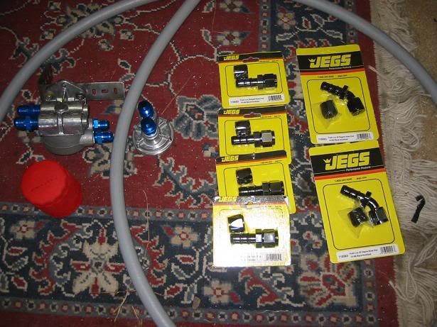

I purchased the an-10 fittings I needed for the oil cooler setup, so this week, I'll be putting in the lines and hooking up the filter relocation setup.

I also found that I have a 3 inch crack on the face of the ex. manifold, so I'm going to see if that can be welded for a temporary fix. I also installed the remote oil adapter on the block, mounted the remote filter/ Tstat under the passenger headlight, and have run the push-loc lines to the oil cooler.

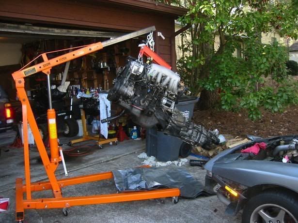

The engine/tranny pulled. First time I've done it together. I like.
Location of my remote oil filter.
The Long oil cooler, behind the IC.
The pushloc hose and couplers for the oil system, AN-10.

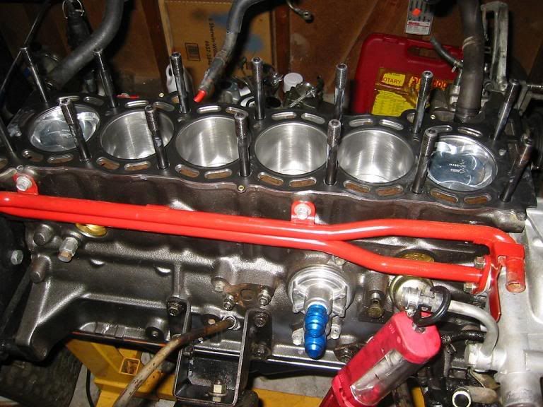

I tapped the head bolt holes in the block to day, but I need a bottom tap, because the test stud binds before I can get it seated all the way down. Anyone know who sells bottom taps?

I received the new ARP's today. I used my new bottoming tap to clean all the crud out of the bottom threads of the bolt holes, then I lubed up the Arp's and mounted them. I also dremeled off the dubious rivet on the Cometic HG, just as a precaution.
Once I had lowered the head onto the block and started putting on the ARP nuts, I realized that the last nut that I had was the wrong size! ARP stuck a M10(I believe) in with the 13 good nuts. LUCKILY, I still had my old ARP hardware, so this didn't become another delay. I tightened down the head in 5 passes, 40, 50, 65, 75, 85. I also threw on the timing belt and timed it out to TDC, and put the lower/ upper timing covers on. I'll have some more pics of this stuff over the next two days.

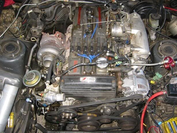

Aside from the fact that I've been out of town 10 of the last 15 days, I have been busy cleaning everything that's going onto the new engine, as well as scrambling for last minute parts that I didn't think I'd need. Here's a pic of some of the progress on the motor:
At this point, though, I have the cylinder head and valve covers on, the motor is timed, the intake, exhaust manifolds are on, the turbo, the upper, lower timing covers, the AC compressor, idler pulley, ps pump and all belts are also installed. I am now in the process of running the wiring harness back into and around the motor, and after that, I'll install the coils, plug wires and vacuum lines. At that point, I am FINALLY ready to hoist it, and mate the tranny back to it(which has been waiting patiently with a new clutch and AL flywheel.
