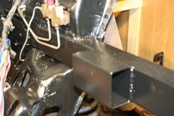

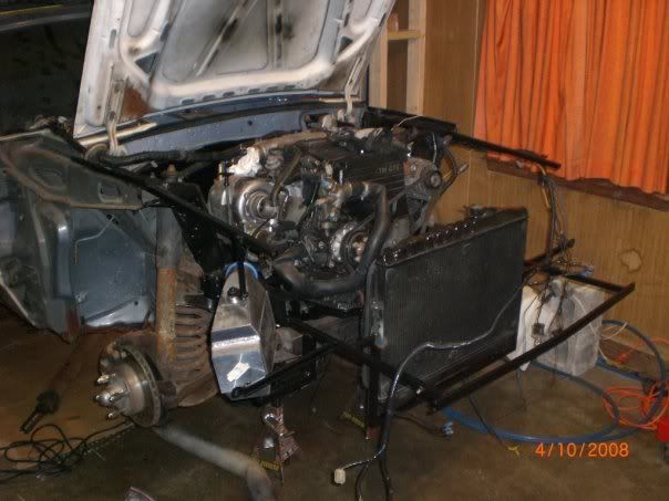

Cool project but I have one question. Does this car have almost no frame in the front or are the black things some sort of jig?

I am not running power steering so hydraboost would not work.. Having power brakes doesnt necessarily mean the car will stop faster, you just need to apply more pressure to the pedal. the frame rails are what the K-member bolts to. i extended them for the swaybar mounts here is a closeup of the extensions i added, these would normally go all the way to the bumper. the box hanging off is where the swaybar mounts.

i have a question
just wondering how come you didn't mount the intercooler kind of like the stock unit is mounted in the supra, in the front, was room a issue?
will the way you have it mounted get good air flow?

I have read flow tests on this and where he mounted it actually gets almost the same flow and is usually cooler...also it protects the fins.
