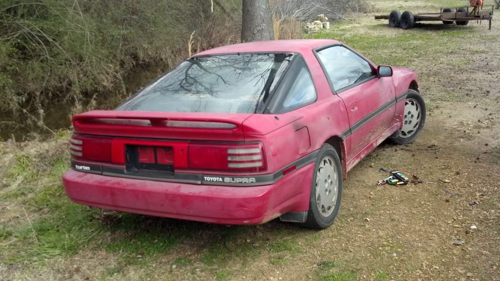

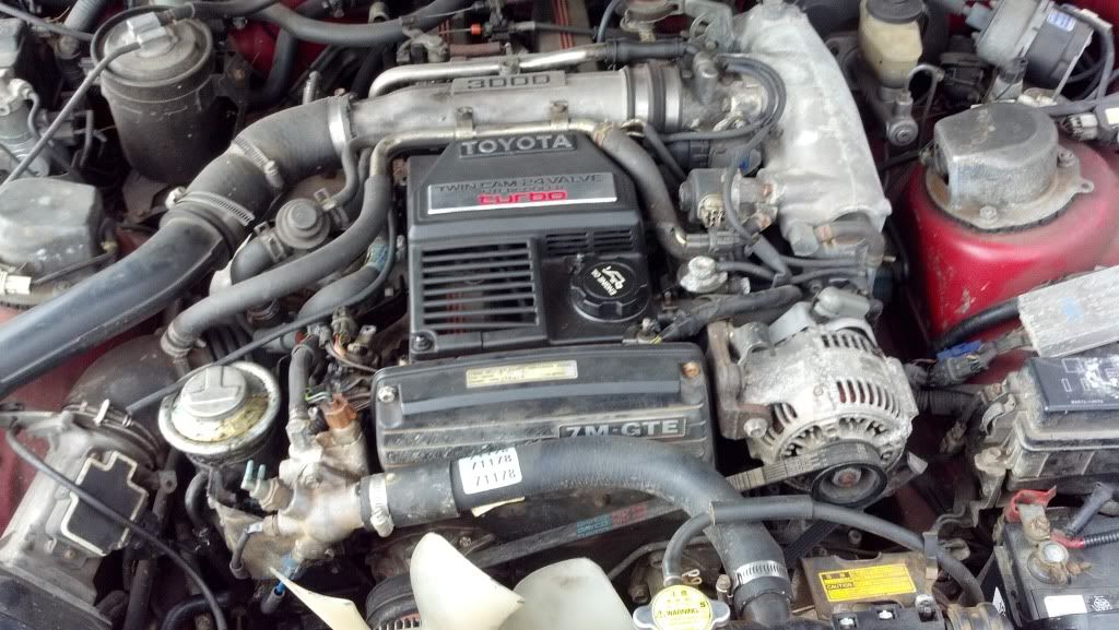

So I bought my first supra two days ago ,and drove it for about six miles before the head gasket blew. Also have like four coolant leaks from the back of the motor. The cars kinda beat up but I wanted a project so it was exactly what I was lookin for. Its an 88 turbo model. Ill post pics up as soon as I figure out how to upload from my droid, or get to an internet source. I can't wait to break this 7m open!

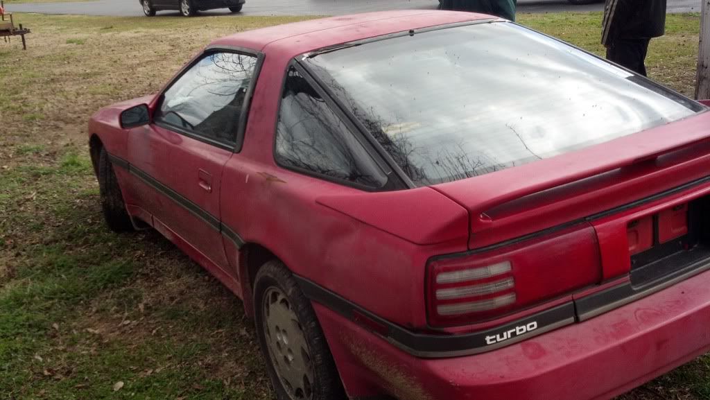

Needs to be washed.

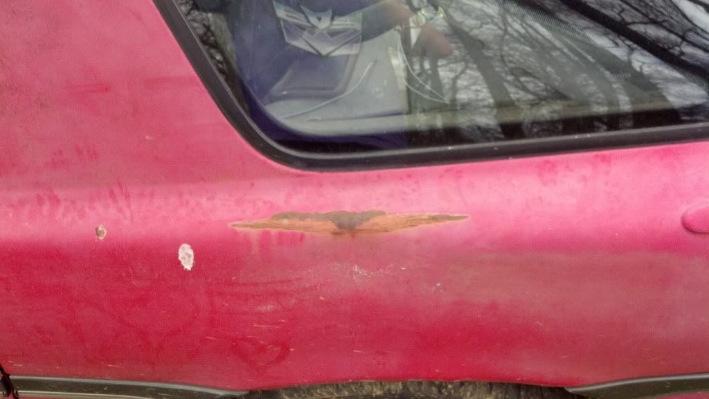

A little rust…

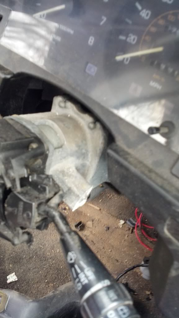

Where the wrecker place I bought it from broke the igniton cylinder off the steering column. :sly:

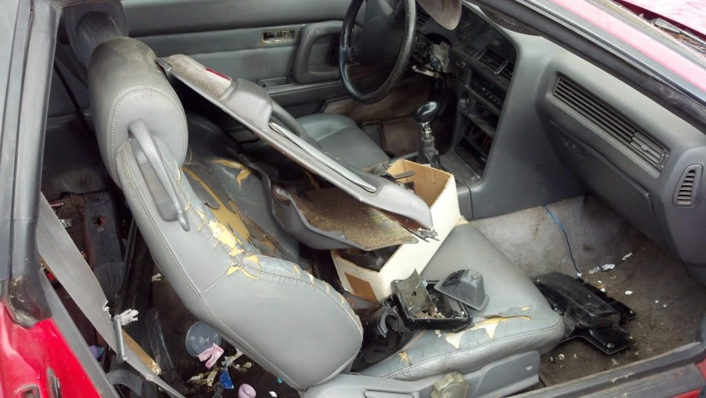

Ratty interior, but its mostly there

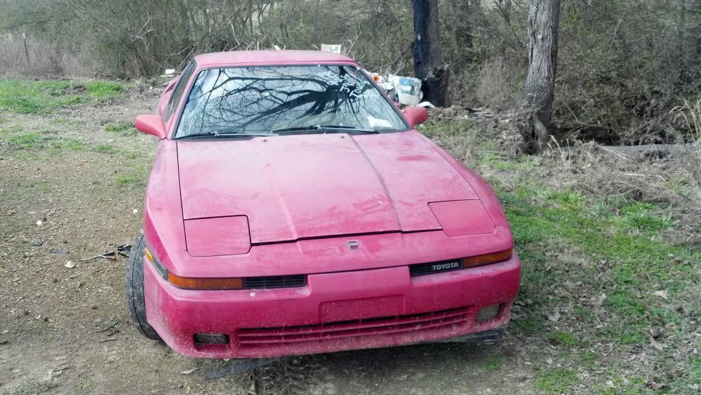

It needs a lot of work but she was gonna go to scrap and I've always wanted one and couldn't stand to see it go to the crusher. Any and all advice is appreciated.

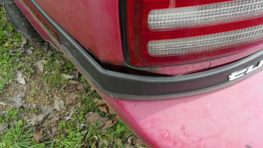

Bent exterior, blown motor, shredded interior.

Yeah I'm actually not lookin for much as far as power is concerned stock boost and a tasteful bolt ons is enough for me so as rebuilds go its more to make it reliable. No huge turbos or major internal mods yet. Any advice on head gaskets? We have a local shop I've heard a lot of good things about but I'm in the huntsville area so if anyone has suggestions I could drive a little bit for somewhere with experience with the 7m.

As far as head gaskets, I would say Felpro or OEM Toyota.
Since you don't plan to up the boost any time soon, you don't need to think about metal head gaskets.
I would suggest that you use ARP head studs, in place of oem bolts, though. It'll be triple the cost for the ARP's,
but they can be used again and again, unlike the one-use oem's, and studs are much better than bolts.
A composite had gasket +ARP's can easily hold 12+lbs of boost on a stock turbo all day every day.

Supraguy you literally just answered every question I had to ask before I ordered my stuff. Thanks a ton. Will I need to have the block worked do you think?
