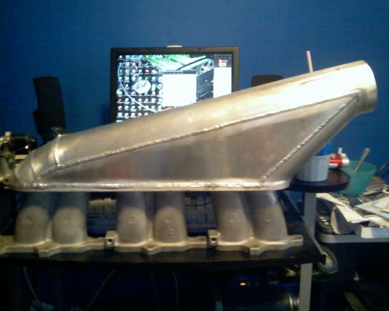

My FFIM...thoughts on it?

There is a block welded on the backside with 5 1/8 NPT nipples and one 3/8 NPT nipple. I'm choosing not to run ISC for the moment being. Q45 TB.
Can I ask why not? Dosent it ever get cold in Ohio? What about first start up on a brisk fall day?
I just ask why because it took me around 25 min. to make mine, not log at all. Super easy to make and easy to add not rather then once the FFIM is on the 7M.

easternguy2005;1215289 said:
Do you think you'll have even boost in all the cylinders ?
It's been virtural flowed in a 3D modeling program. There was less than 2% deviance between runners when virtural flowed with water.
Pic of mine
picture.php
Eventually I will run an ISC. Just for now I need to get the car up and going. I'm a mechanical engineering student at the university of Dayton and I don't have alot of free time so I'm taking advantage of the free time over break I've got.

Doward;1215526 said:
Parameters used?
Not really sure what you mean by this? Further explanation would probably yield a better answer.
Parameters used when it was virtural flowed in the 3D modeling program.
