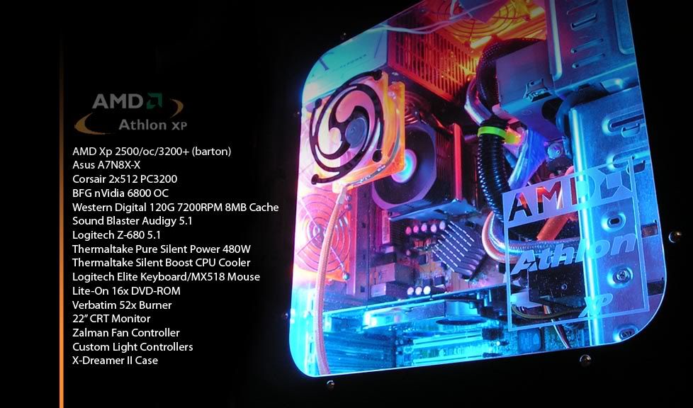

so. before i was all into my supra, i was in to computers. i read about em all the time..i put my money into em, i tuned them...and then i got my supra. heres a picture of my computer before i turned around into the automotive world.
so...the lights in my case are now usually off by the custom switch panel i made:naughty:.and just before i was in my car and thought, hmm its offly dark in here even with the lights above on...well i plan to replace those..but thats another story. back to those lights in my case. i have a total of 4 blue cold cathodes inside my case and thought i could spare one or two.
