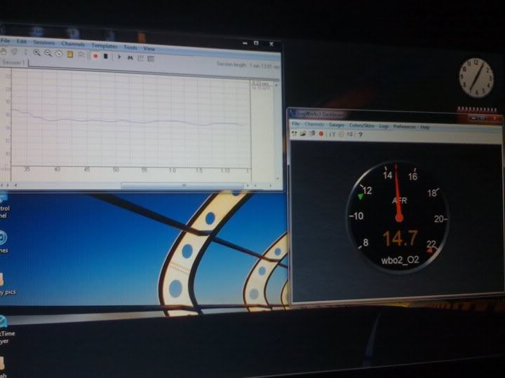

When I am cruising my AFRS are 14.7 when I decide to step on it when it gets around 0psi it stays at about 14.7 then after about a second or two it all of a sudden goes normal to about 11.3 at full boost. I tested the fuel pressure and its all good. AFM is good. Just installed a new TPS. I don't know what it could be, has anyone ever had this problem or have any ideas that might help me out?

Its GTE electronics. Would someone messing with the adjusting screw in the AFM have anything to do with it?
---------- Post added at 02:13 AM ---------- Previous post was at 02:12 AM ----------
And its not a lag in the time innovate lc1 is very fast you can tell there is a lack of power because when it goes rich it all of a sudden goes alot faster.

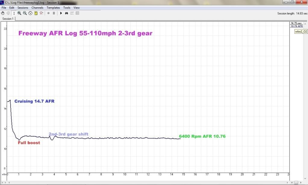

I was logging on the LC1 with a laptop and had the same thing happen.. I am tuned for AFR's 11.5-11.7 with the Neo on a dyno but stock should be around 10.3-10.7 with it on a stock computer.. If the AFM screw plug was drilled out and then they loosened the screw all they way out that would lean your mixture out over the whole power band.. Are you just watching the gauge when you see it or are you data logging it on a laptop.. You can't go by the gauge, I would log it and look at the log in LM log works 3
Here is my log on NA-T with no tuning at all stock ECU (GTE) no Neo
---------- Post added at 12:54 AM ---------- Previous post was at 12:44 AM ----------
Every single time there was a lag when the gauge stayed at 14.7 and then suddenly dropped into the high 10's- 11.0 and stayed under full boost.. But it shows on the graph the smooth drop
