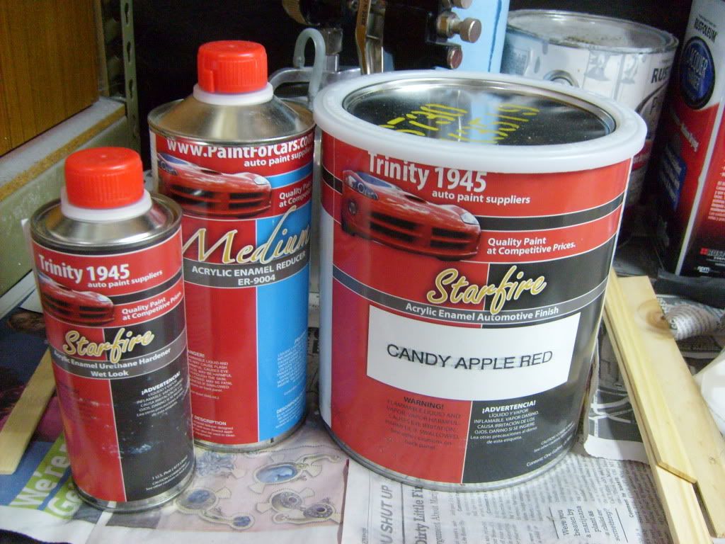

got the paint today woot!!! whats on the stick is a single layer nothing added and no clear and its dry.
also whats the best way to go about in fixing this

modmonster2008;1450533 said:

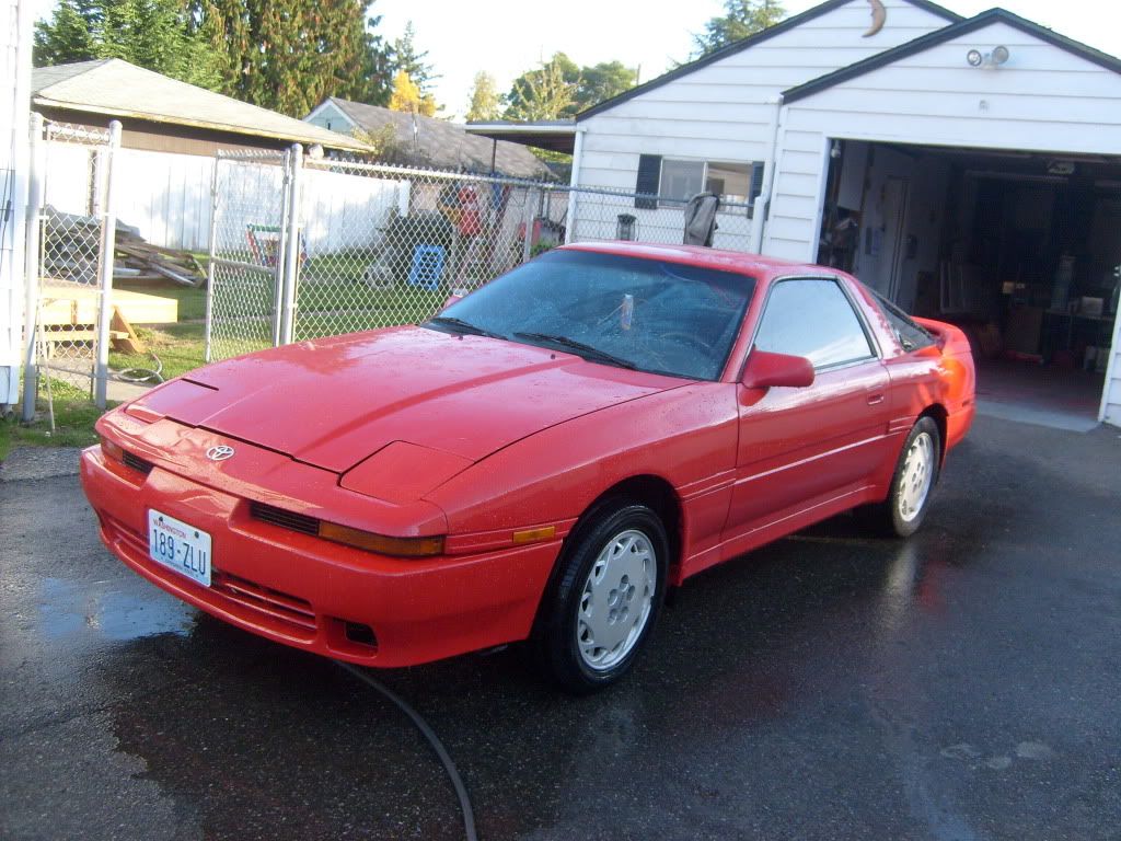

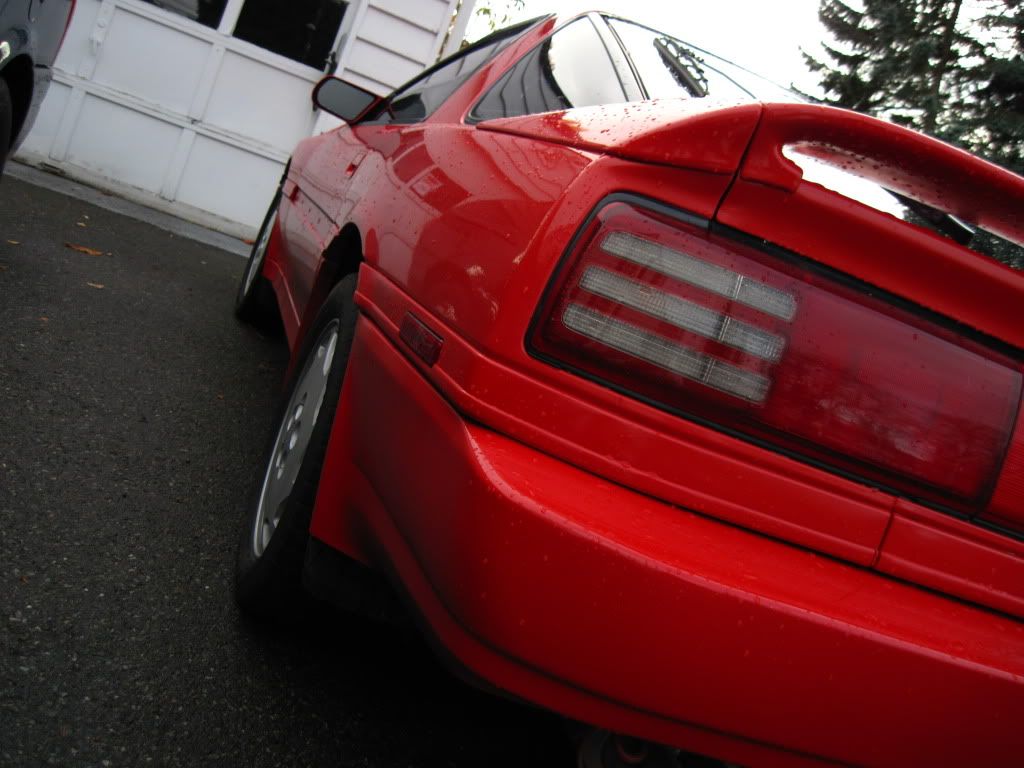

HAH! used the same paint i did, ordered online? candy apple red haha nice choice!
heres mine as a reference on the outcome...
prep/paint/finish it right and the results are outstanding! good luck

its holdin up pretty nice, been sitting outside thru a bunch of storms including high winds, rain, thunder, hail, show haha, and nothing shows on the surface yet, just paint at the right temp and at least 3-4 coats and you should be fine!
what temp did you use?

i painted during the summer around maybe 75*F do a test piece first, to see how fast the paint dries, because it tends to dry too fast causing it to have uneven surface, you want to have each coat still tacky when applying another coat so that it comes out even in the end, but i highly recommend doing a test piece first just to confirm the dry time, are you doing base/clear or single stage?
im thinking like 3-5 coats and then a layer or two of clear. im going to put the paint on thin with like a 50/50 mixture of paint/ thiner.
how does that sound?

I would read up on that particular paint. A 50/50 mix seems a bit thin. The manufacture has a mixing guide Im sure. If not talk to a local paint shop and ask what they recommend for your specific location, Temp, Humidity...

thats too thin for sure, i recommend going at least 3 coats of basecoat, and at least 3-4 coats of clearcoat to get that shine like OEM. then wait at least a full week before you start wetsanding the car, wetsanding a bit too early can cause a part of the paint to come off, which is not a good idea at all, just wait for it to cure :)
ok will do tomorrow thanks. im just reading what i find one google lol
cool i can wait a week ill need to take a vacation after all this sanding lol.
