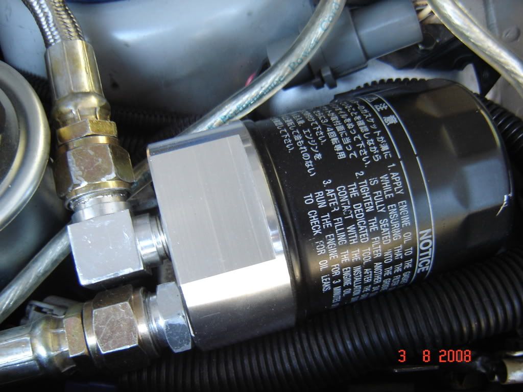

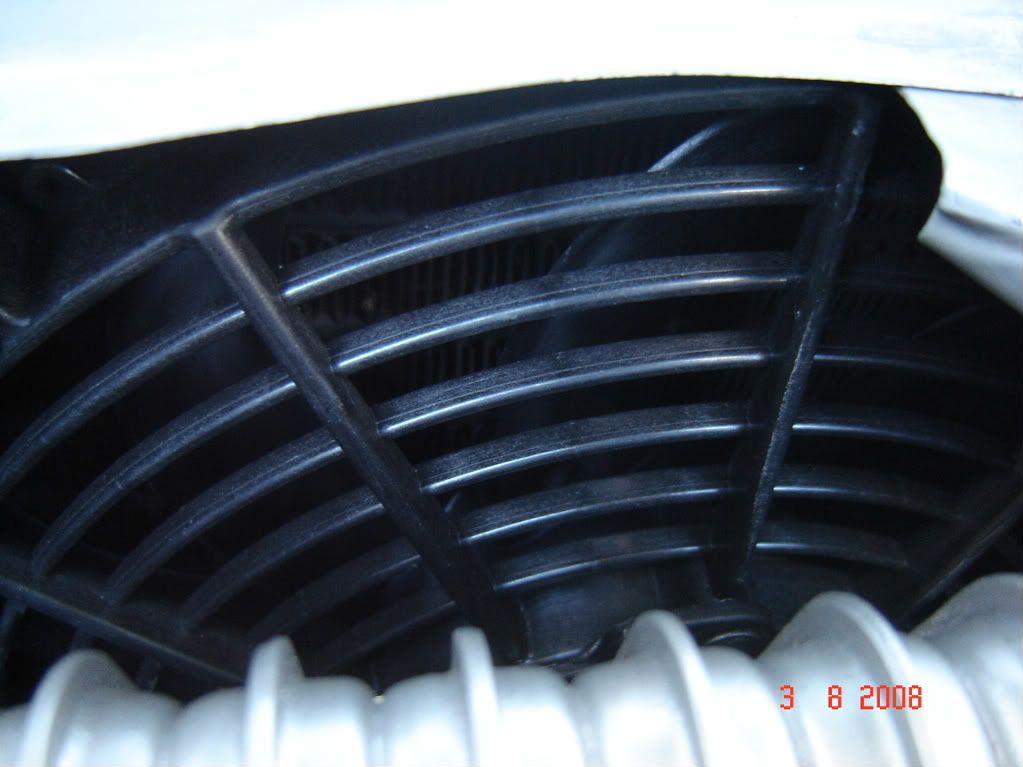

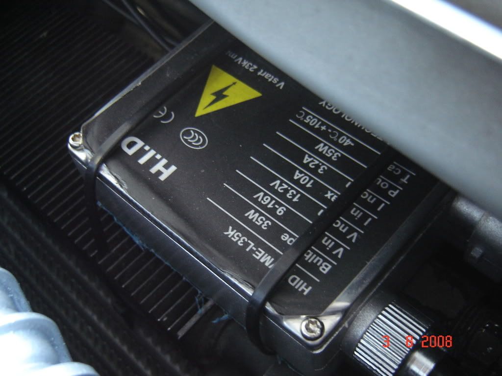

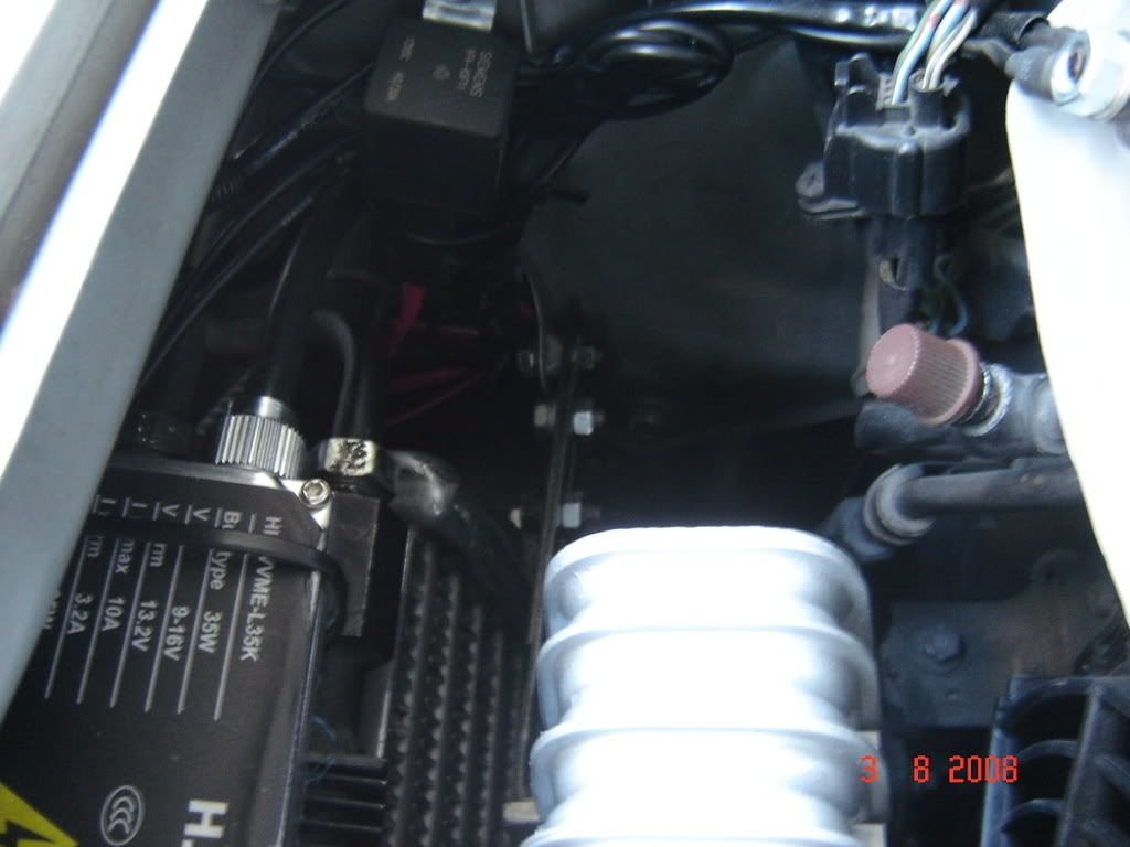

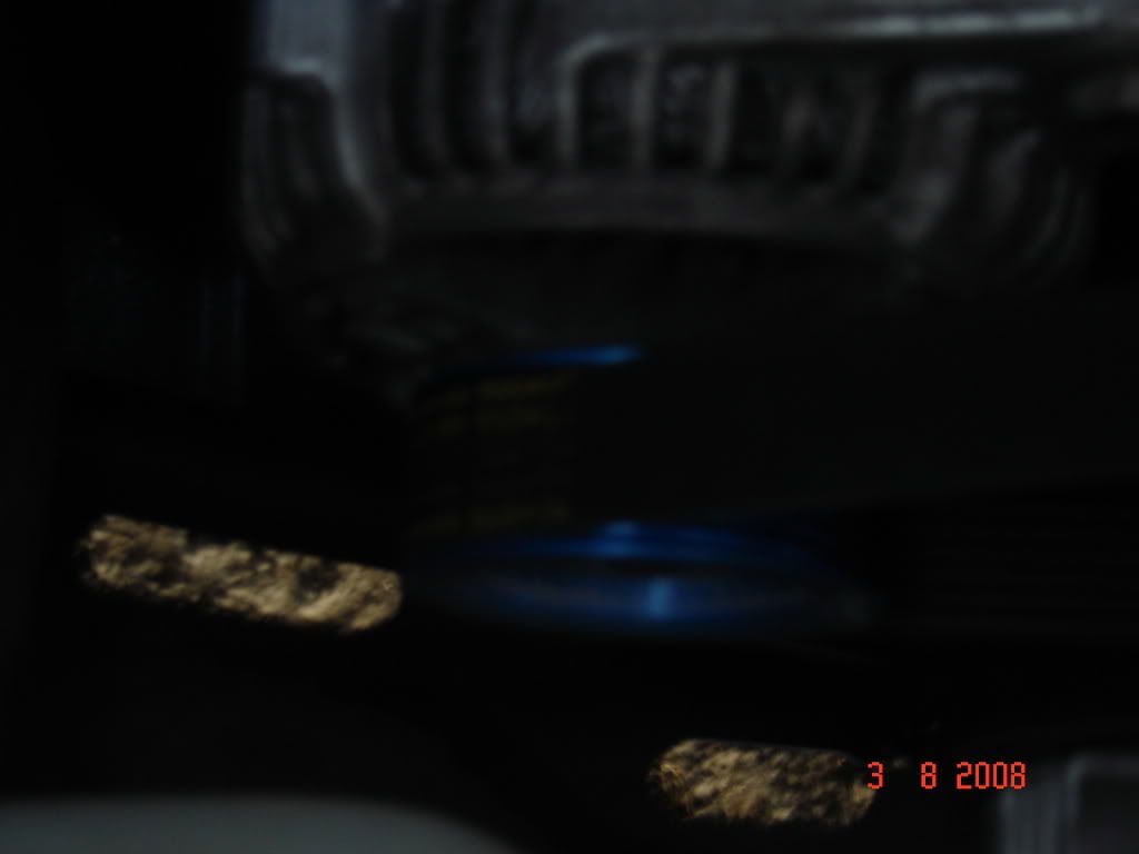

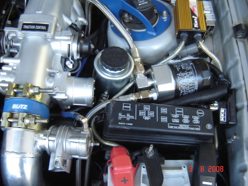

This week I installed the HID 8000K xenon system into my headlights...
The oil filter relocation kit along with a 10 row...but BIG oil cooler
(16 inch long,8 inch height,2.5 inch thick),now I can change the oil filter
in seconds :biglaugh: Not only that,but I saw a decrease in water temps
by 5 C'degrees and oil temps went down 10-12 C'degrees :love:

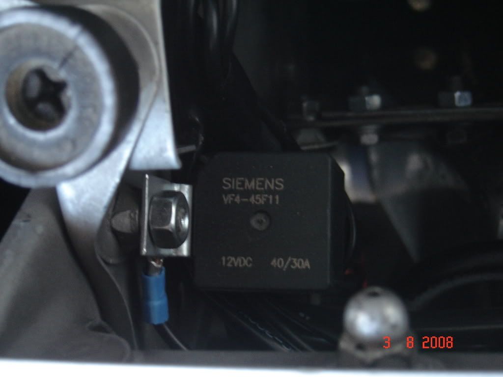

Put a Spal 12 inch electric fan (940cfm) with a relay & contoled by a
cockpit switch...:sarcasm: When I turn on the elec. fan I have seen
small demperature drop but it also controls the water temps not to rise as
before...:sarcasm:

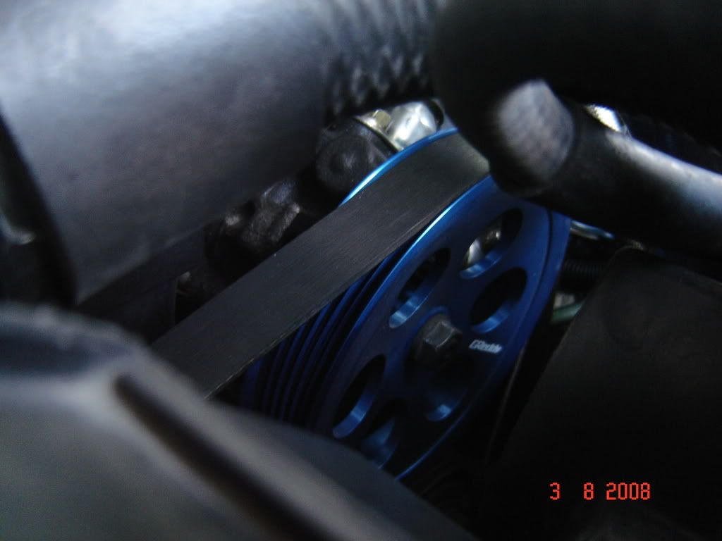

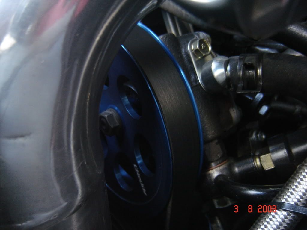

Forgot to show you the Greddy underdrive pulleys :biglaugh:....
A general picture showing the Oil cooler,Intercooler,Power steering coolers,
HID's chargers,Spal electric fan,Electr.fan relay by 'Siemens'...:sarcasm:

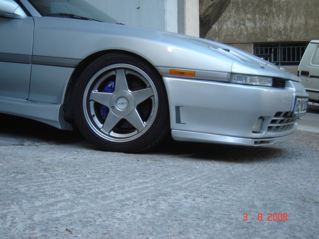

And by the way,except that I have better braking than before,this calipers
look good also.
p.s. Thanks Martin (from Germany) for the brackets :icon_bigg
And new performance parts are on the way home from Japan and
United States...Keep you posted!

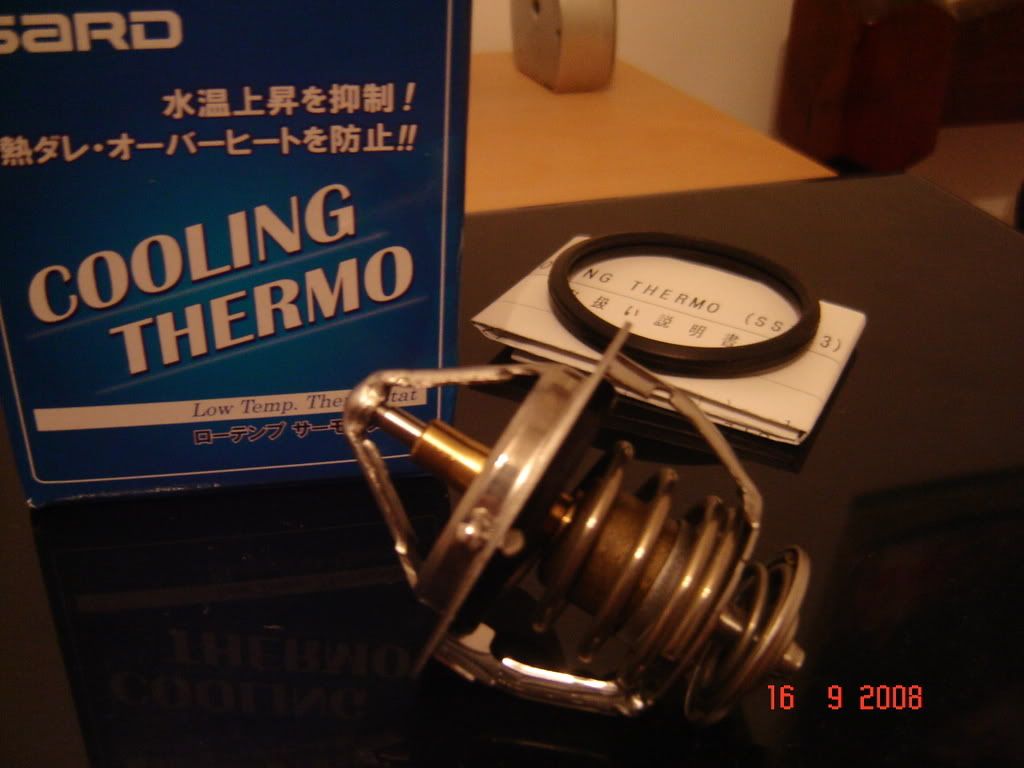

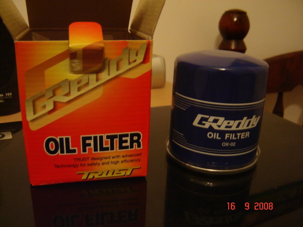

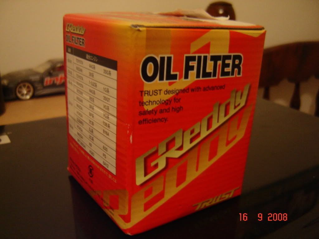

Greddy high performance oil filter
Sard low temperature thermostat (72'C / 160'F)
Blitz racing radiator cap (1.3 Bar / 18 psi)
& Sard oil pan drain plug (magnesium plug for catching small metal debris)

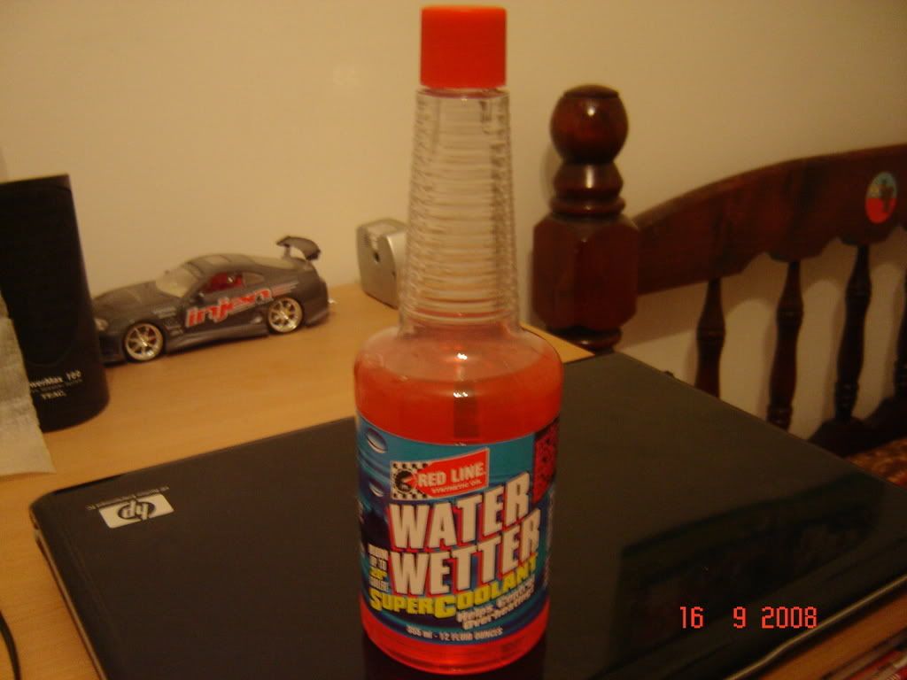

Redline water wetter

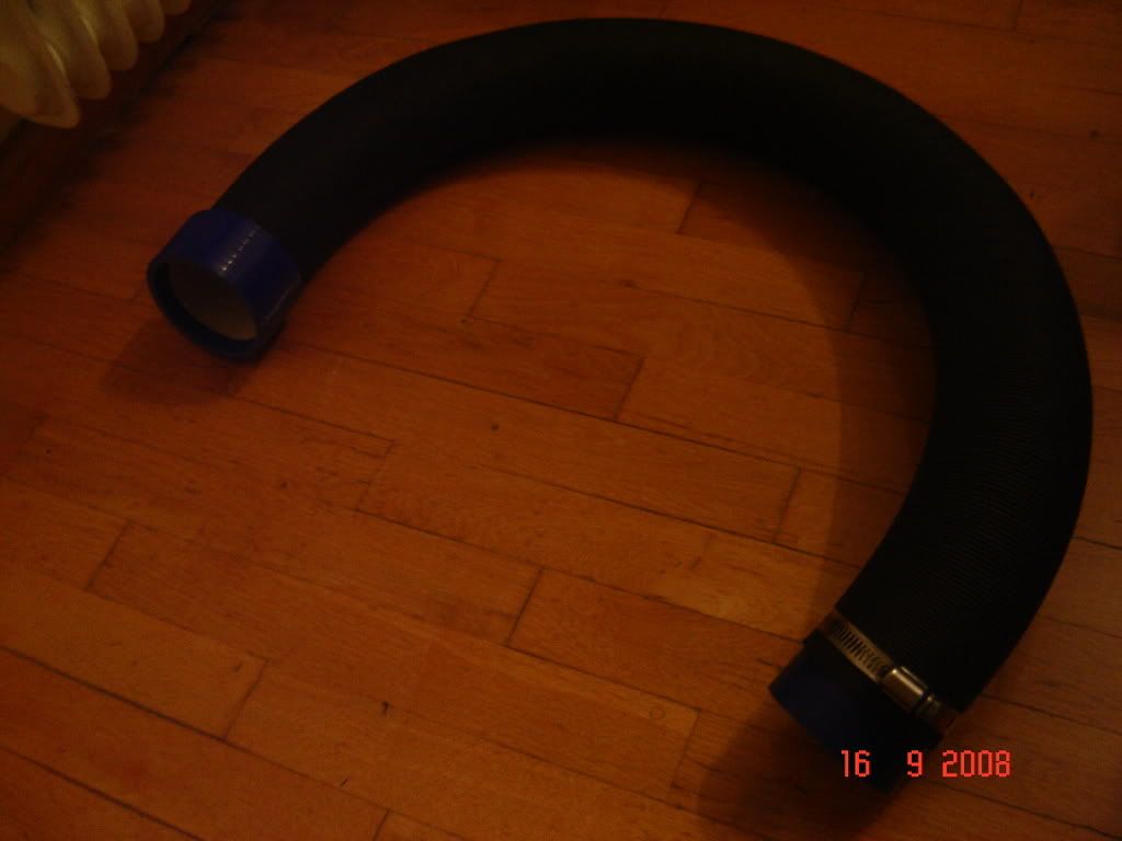

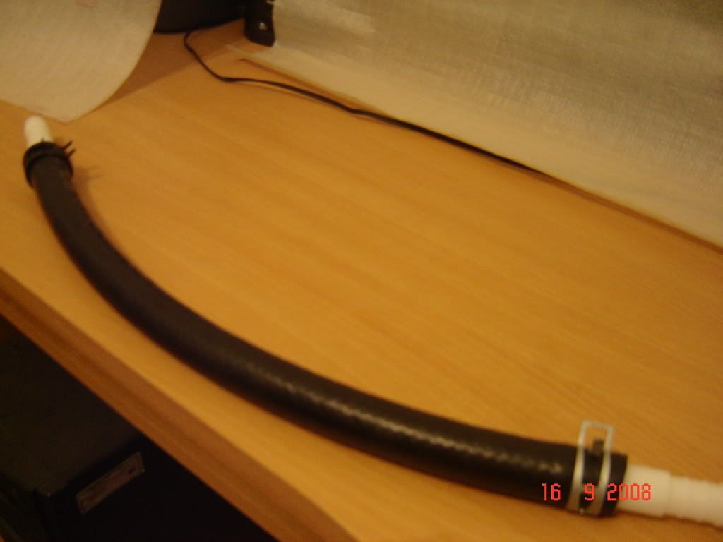

Custom coolant hose (for use to by-pass the stock oil cooler.Stock oil cooler
will remain on the block but coolant will stop going through it). I have already
installed an aftermarket (air to oil) oil cooler,between the IC & the A/C condenser...as I have mentioned before on my previous posts :biglaugh:
Will reduce temperatures (oil & water) by 10%...not bad :sarcasm:
Custom intake hose 70mm /2.5"inch (For use to make a tunnel for the fresh cool air to make it through the engine bay.One end will be installed near the IC,and the other end will go under the right pop-up light through the fender and exit the hole that used to be the intake hose of the 7M-GTE! Cold air is needed over there,cause the air filters are located and there is the area where the turbos produce heat! )
Some more pictures will be added soon,when the parts will be on the vehicle!

hrmm isnt the OEM temp for the thermo at 180?
be sure to cut open that greddy whenevr you are done with it ;) i wana see the insides hehe
and did you have a thermostat control for your oil?
Yeap,oem 2jz thermo is 180 F.....
I think you mean to cut open the Greddy oil filter...:sarcasm:
Maybe it should be better to send it to you :biglaugh::biglaugh:
No...I don't have a thermo controled oil cooler,but the climate here
is on the hot side :biglaugh:
But don't worry..I always wait for the oil to reach optimum temps before
I boost the 'jz' ...:biglaugh:

good deal hehe, wouldnt the 160tstat just delay the warm up?
SupraClaou
Sep 1, 2006
846
4
Athens,Greece
Yeah,it will delay the warm up a little...:biglaugh:
But on hot days the low temp. stat will pay off :biglaugh::biglaugh:
