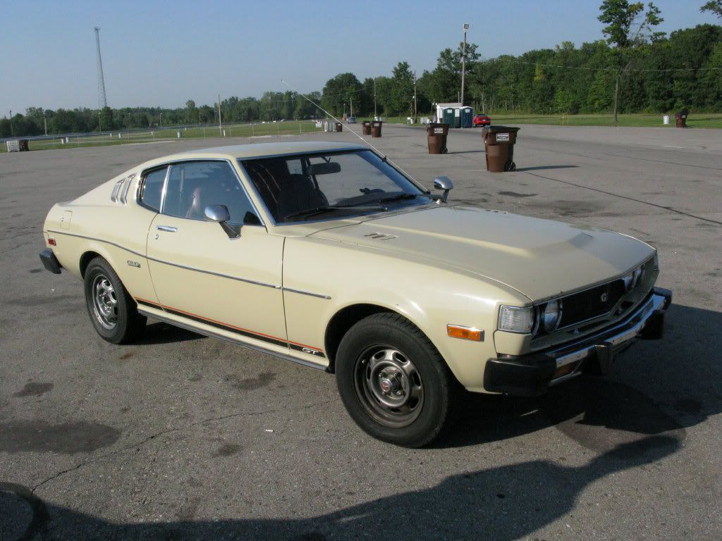

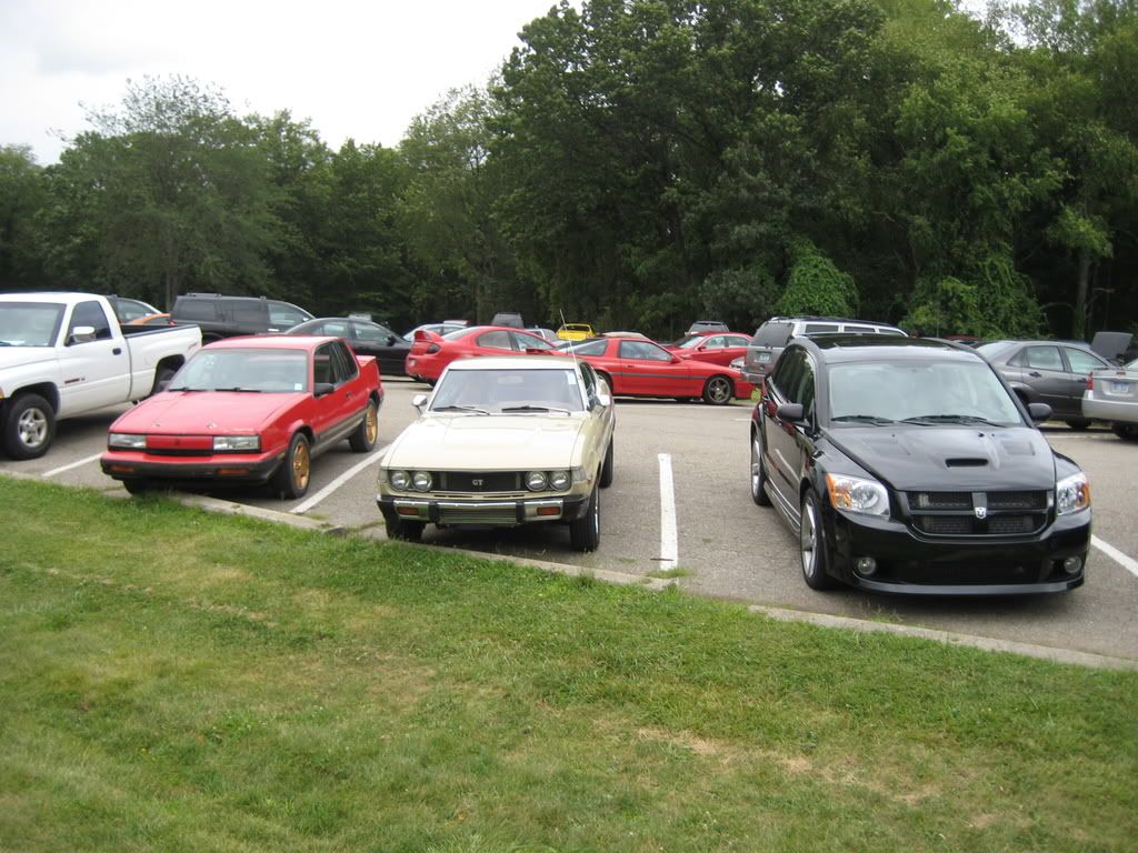

Here are some pics I took of my own car last night at another forums meet.

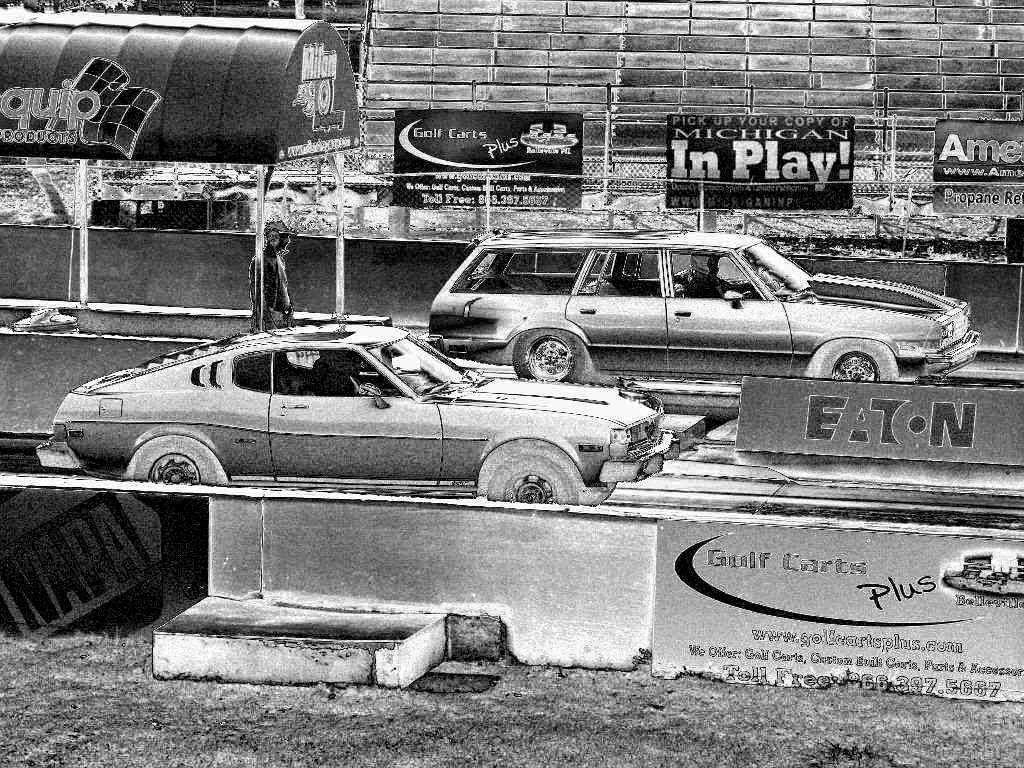

I have reallllly been neglecting my Project page here, I have been having too much fun driving the car!

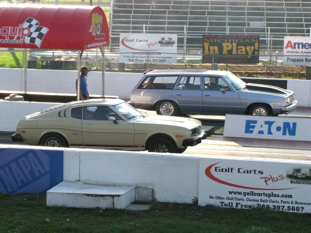

Much faster than expected, I believe it should run about mid 12's or so in the 1/4.
I still have a wheel hop problem pretty bad, but I am working on a solution.
I have not had too much competition out on the streets so far... I have had one person beat me out of many races.... not that I would ever do that on the street :roll:

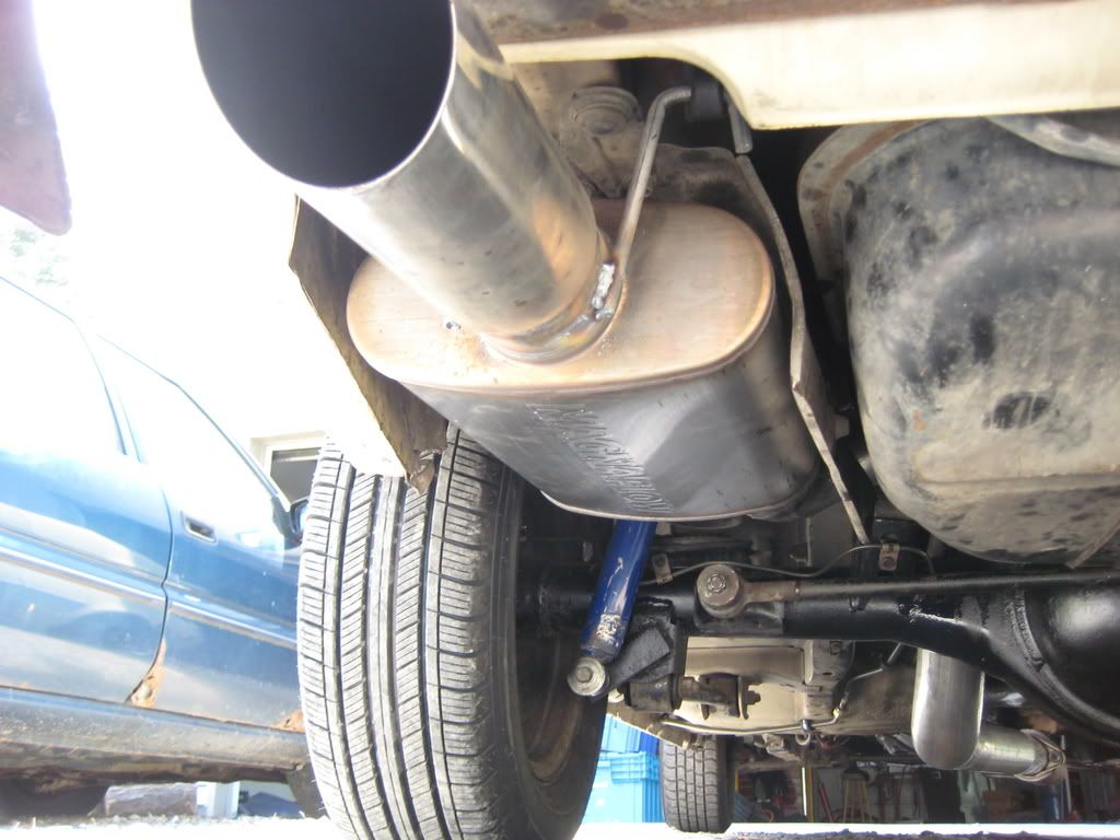

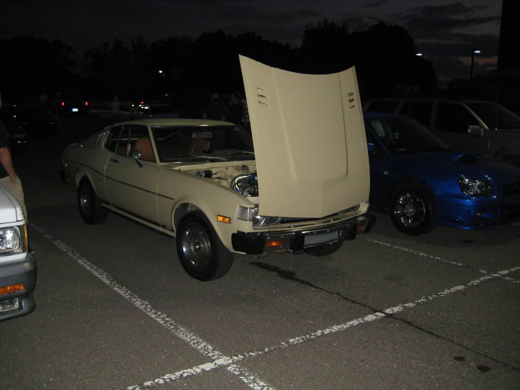

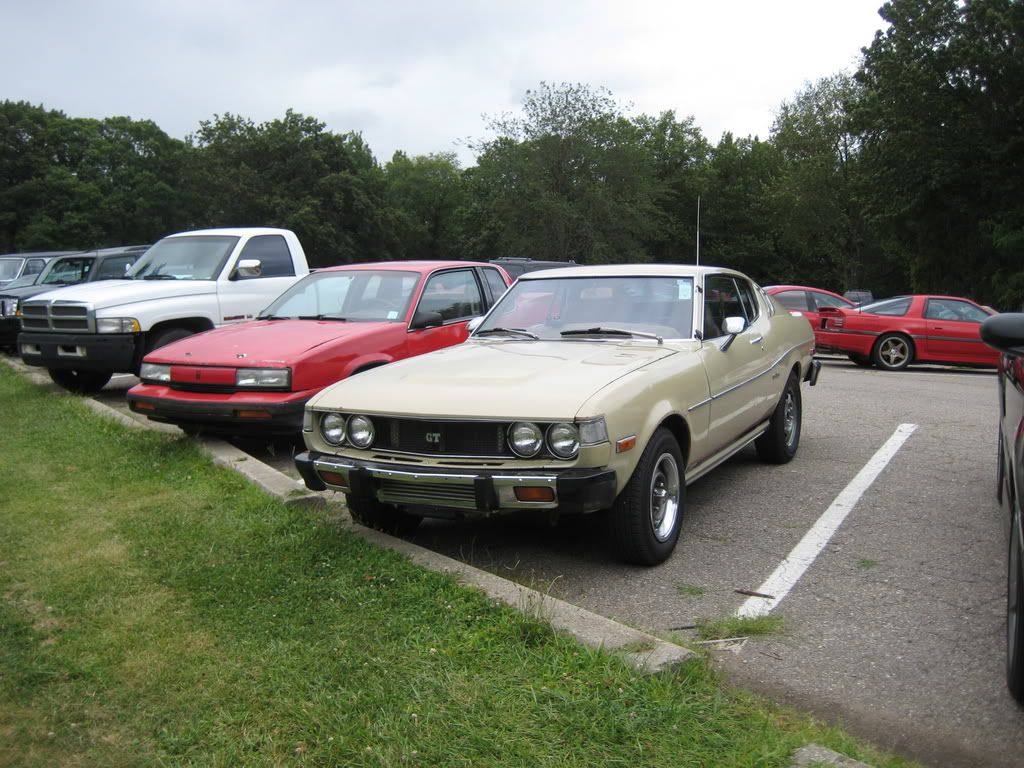

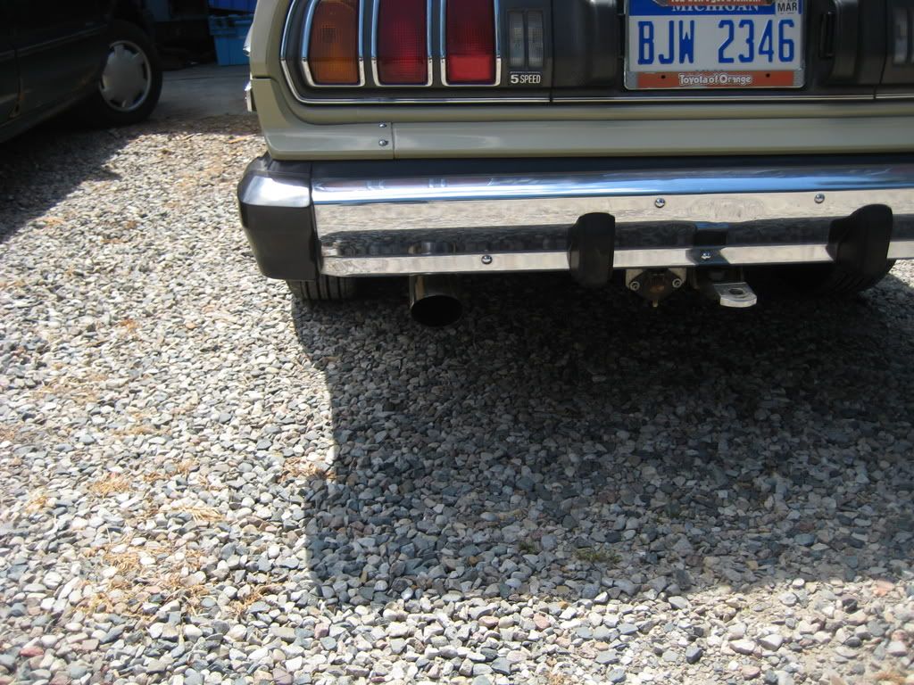

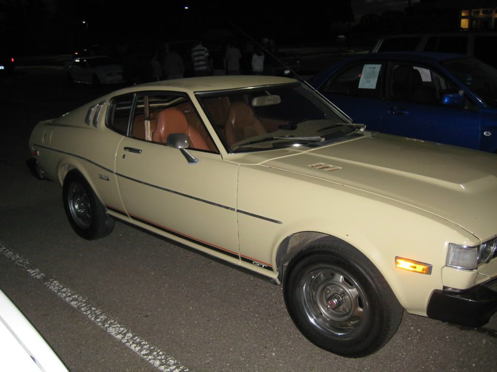

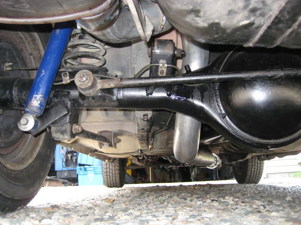

Here are a few pics of the exhaust, and then some pics from a few car meets!
excuse the axle breather leaking... problem is fixed now..
people checking it out..
Meet from a diff MI forum

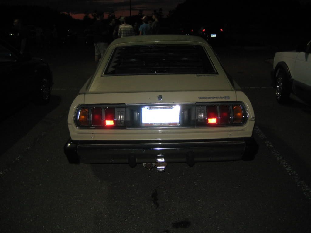

So far this car has been the ultimate sleeper, I love the fact that i left the trailer hitch on it, and it just looks like some old slow beater. I have definently suprised a few people.

The pinion angle is non adjustable.... the new axle is installed the same as the old one though.
I believe all my bushings in the 4 link setup are causing my problem, they are rubber and they are factory origionals. Which I guess changes the pinion angle when its under heave throttle, but I havent gotten around to finding poly bushings though....

Fixed the axle hop by using poly bushings
Took it to the track and ran 12.9 @ 110mph... on 195/70/r14 crap rubber :)
Should run an easy mid/low 12 with more traction

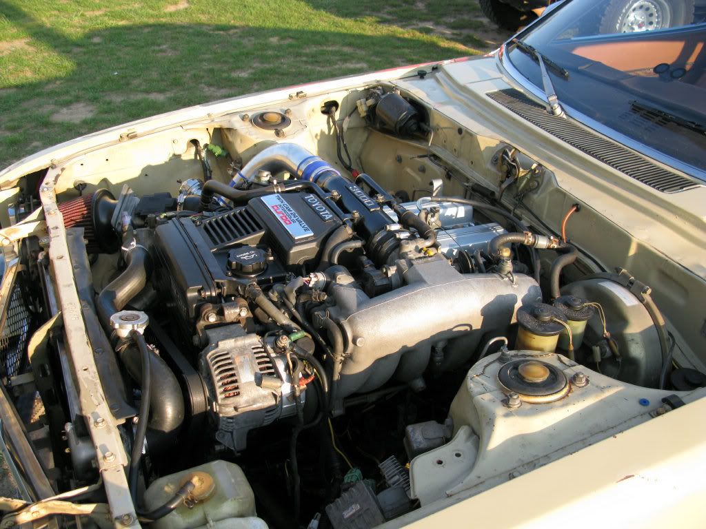

Going to go Lex/550's/Safc/wideband for some basic power.
I am going to keep the stock HG for now with ARP studs, but I am going to up the boost some and just use the HG as my weak point as I experiment with tuning.... I would rather blow a HG than crack a piston or worse. HG is easy to change so thats what my route will be for now

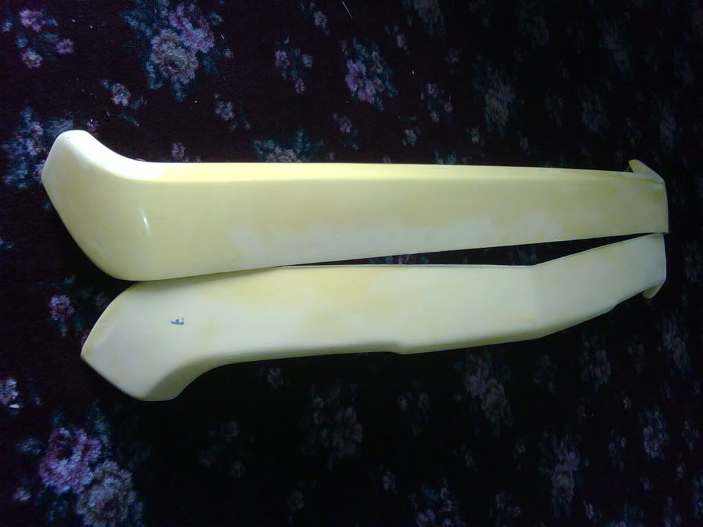

ordered some "smiley" fiberglass bumpers for her.
should save about 80lbs or so, and it will look much better.

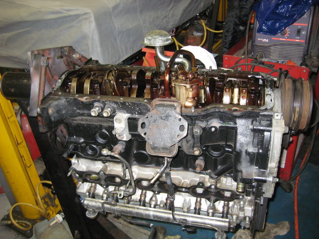

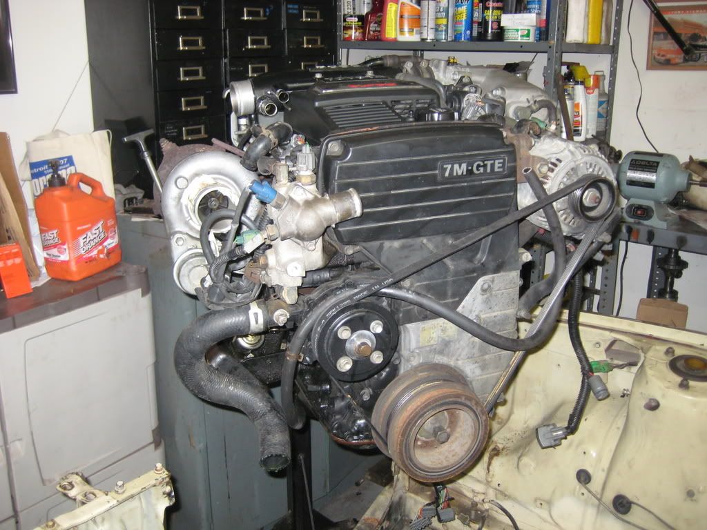

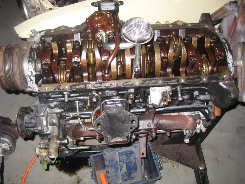

motor is out... might be going the mhg route to be safe
