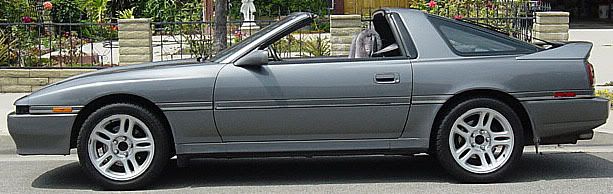

There once was a very nice looking grey car on here with Mustang Rims. They were a 5-spoke, and looked sick! on his car. He just needs to lower it a bit.
Here's a pic

They will fit. I have a set of Mickey Thompson ET Streets 26x10.5 mounted on 01 V6 Mustang wheels. No rubbing and they actually fit quite nice and flush and are WAY lighter than my other wheels. I'll post up a pic when I get home.
