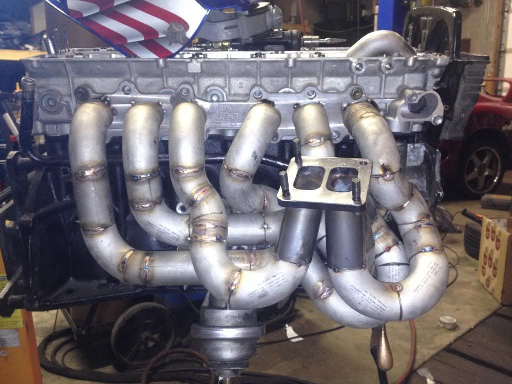

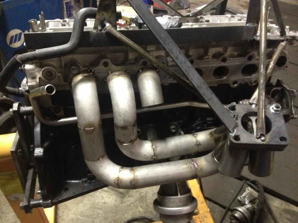

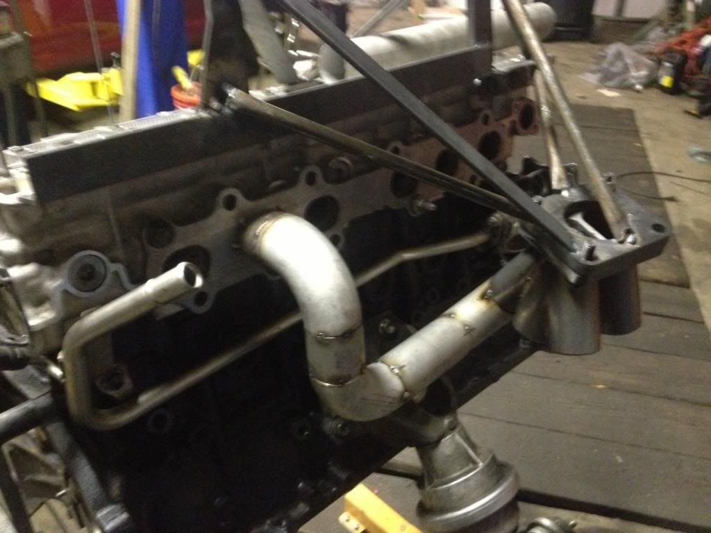

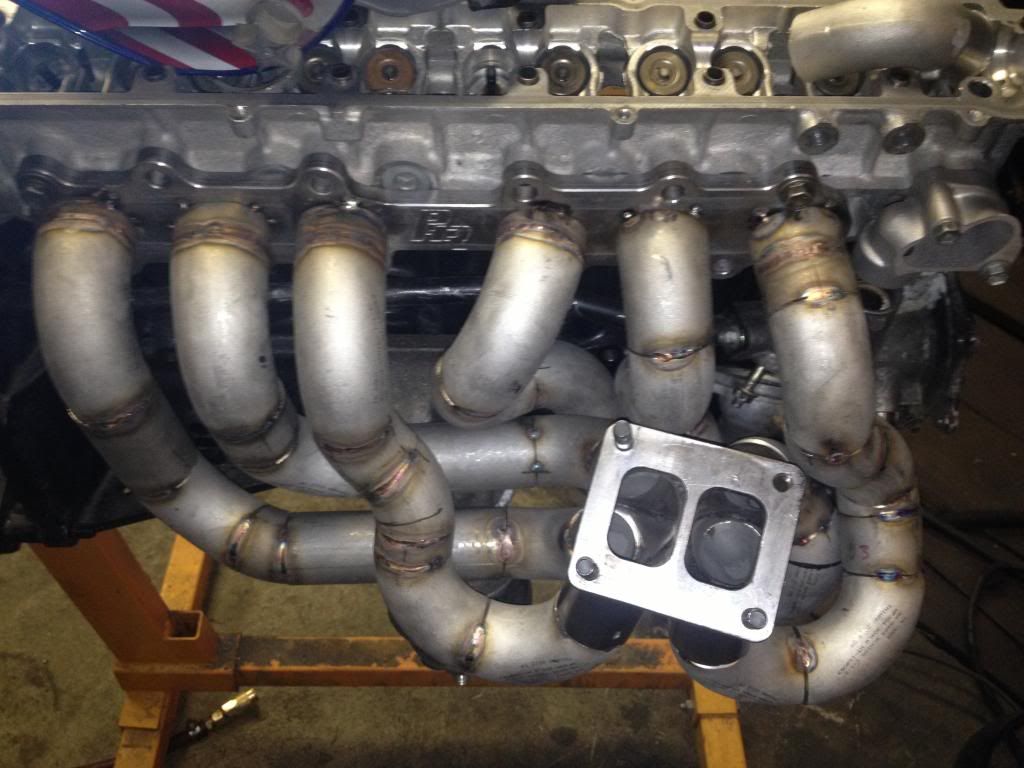

Built a jig for the collector and started fabing the runners for the exhaust manifold.. Disregard the welds on the jig they were done using flux core due to a space issue at the shop.
