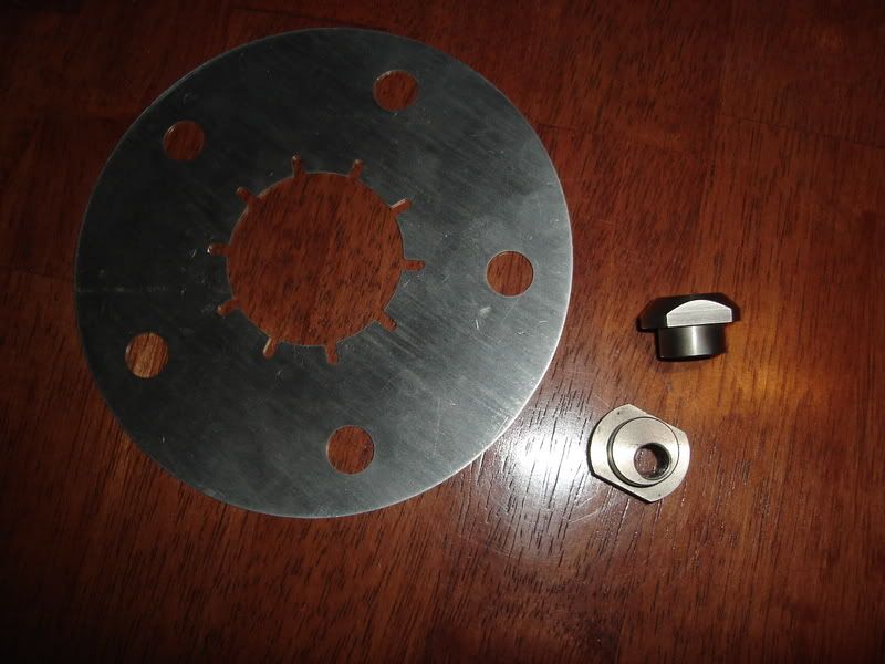

fast and easy way to get the mkIV rear brake's mounted
adampecush
Regular Supramaniac
May 11, 2006
2,118
Edmonton
We need a sticky, I'm tired of doing this.
1.) Pop out the threaded inserts in the rear calipers. Measure all dimensions. Also measure the centre to centre spacing of the holes on the mk3 caliper.
2.) Measure the brake rotor bores of mk3 and mk4 rotors.
3.) Go to your local machine shop with the dimensions of the caliper inserts and hub spacing ring. Have them make the parts, ideally machine the caliper inserts from 4130. Install the new inserts into your calipers, and mark where to drill the mounting holes using the dimension you measured from your mk3 rear caliper. Offset the holes radially inward as much as possible (with respect to the wheel) to minimize pad overhang. Drill and tap to the appropriate thead (M8 iirc).
4.) Install
5.) ??
6.) Profit.
