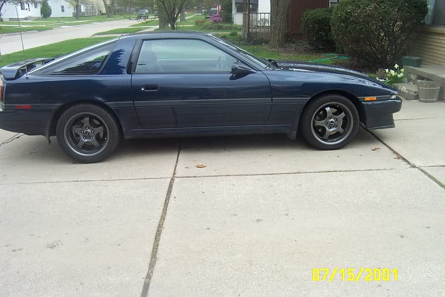

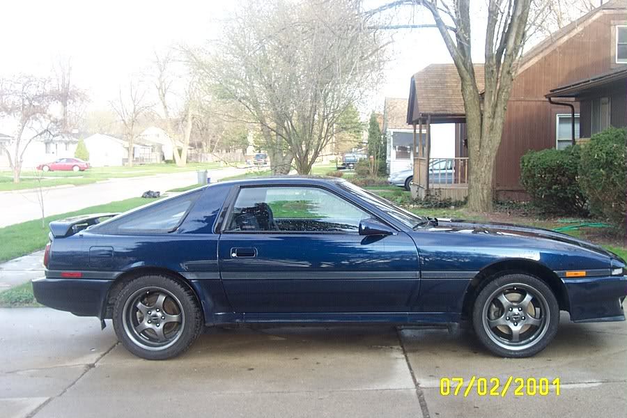

Ok
Here are the before and after pictures with the ST springs installed.
I am pleased with the drop. Please keep in mind that I was not looking to go extreme, as I drive my car every day and comfort was just as important (if not more so) to me as looks.
I could not feel any noticeable difference in either the handling characteristics or the ride quality between these and the original 18-year-old stockers (TEMS) that have about 57K. They both ride damn nice.
The after pictures could look better but it has been cold and I didn't feel like washing the car first. It was also overcast.
I think for 140.00 shipped for all 4 you can’t beat the ST springs if you want to get a bit lower.
This might give some you folks a better idea on what to expect if you decide to go this route.
Once again, thanks to Dr.Jonez for the install. I asked him if he wanted to look at the info that came with them and he just laughed, said no, and put them in exactly as the install instructions stated.
