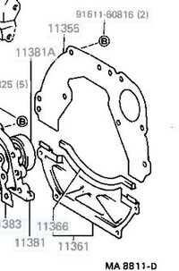

All great information. I plan on taking the engine out with the transmission attached. I attempted to remove the torque converter bolts from the flywheel but there is a gasket that is bolted between the engine and bell housing. And it looks like it goes all the way around, I could hardly get a ratchet in on the side bell housing bolts especially where the starter is. Should Just do a cut out on the gasket at the bottom of bell housing so I can access the torque converter bolts?
trofimovich
Jun 29, 2012
98
24
8
Russia
To remove the bottom cover, just unscrew the bottom side stops.Then the lower crescent will be removed.
It consists of two parts.
