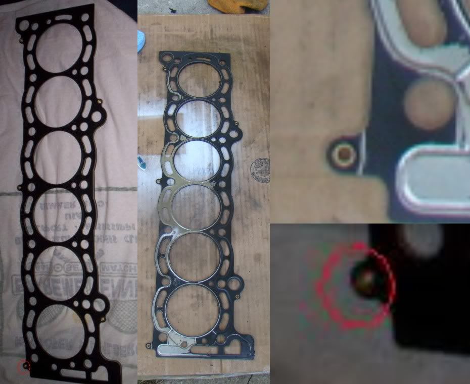

Are you sure you had rivet problem. Last Cometic I got looks like they corrected the issue. Other threads here say so too and looking at the indention of the head mark on your HG looks like there was no interference.
http://www.supramania.com/forums/showthread.php?p=961238&p961238
MRSUPRA;961238 said:
The TMS (Cometic) 1.4mm gasket that I recently installed had no "rivit interference".
The rivet that causes the problem is circled on the previous version, compared to yours. See how your tab sticks out further.
comparison image courtesy of Justin727
http://www.supramania.com/forums/showthread.php?p=75122&post75122
edit: sorry I just reread your post. Unless it was a typo; I don't know what a 'ridgets' problem is.

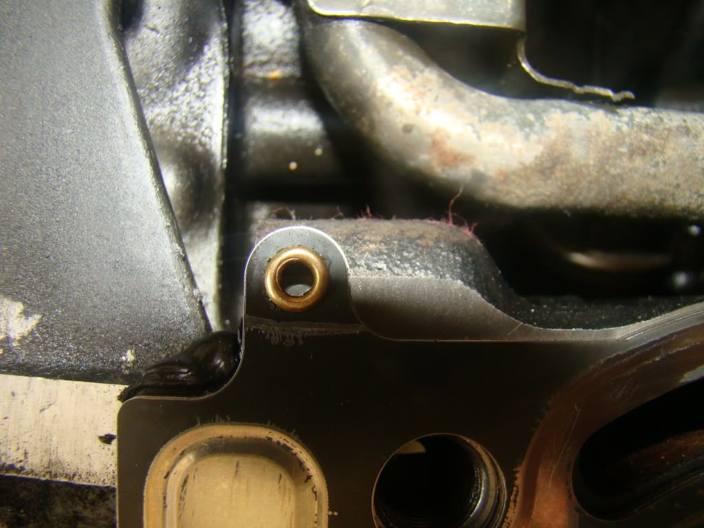

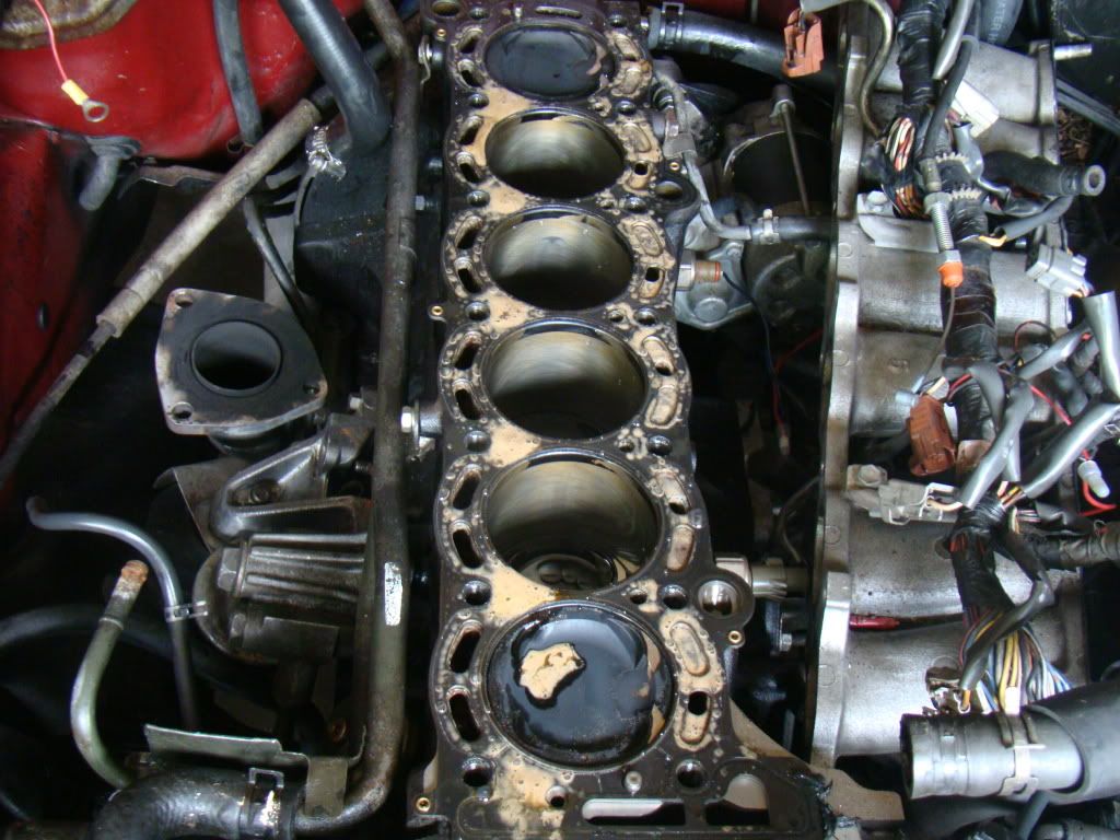

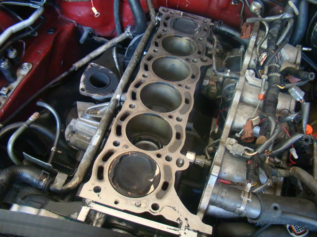

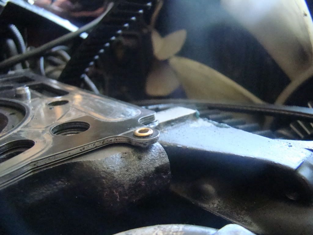

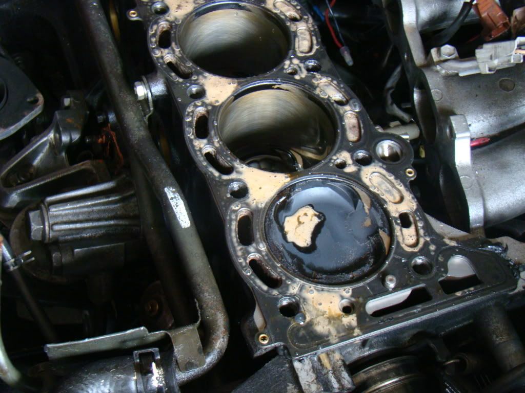

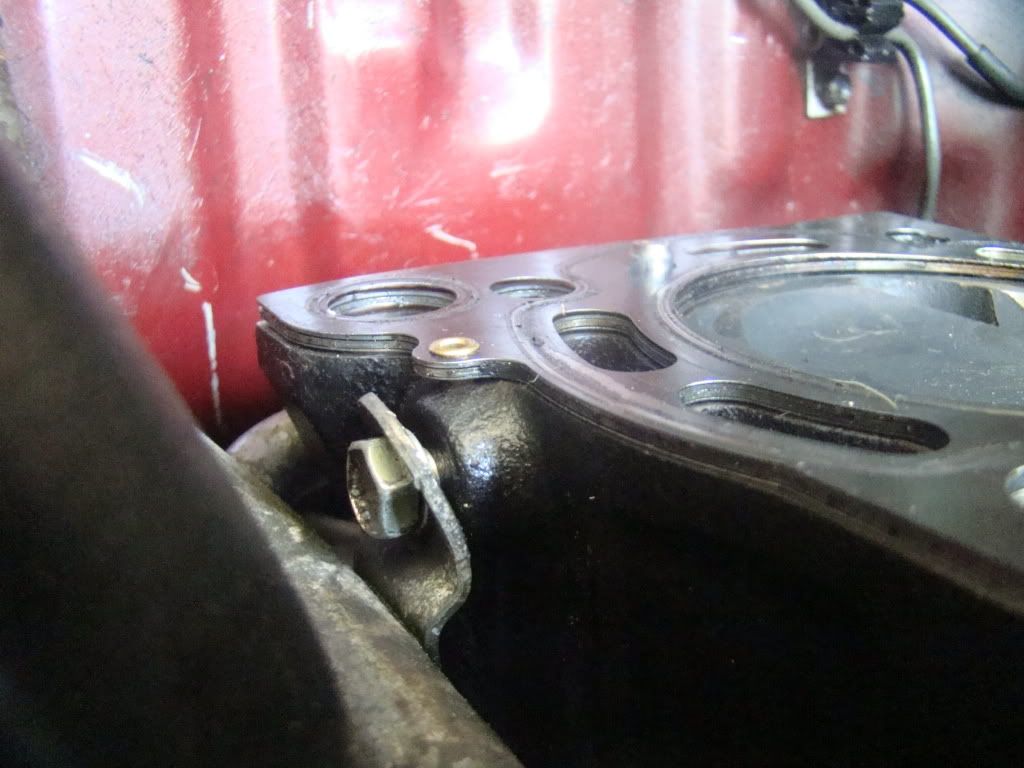

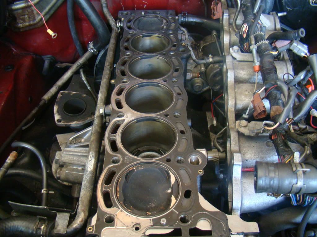

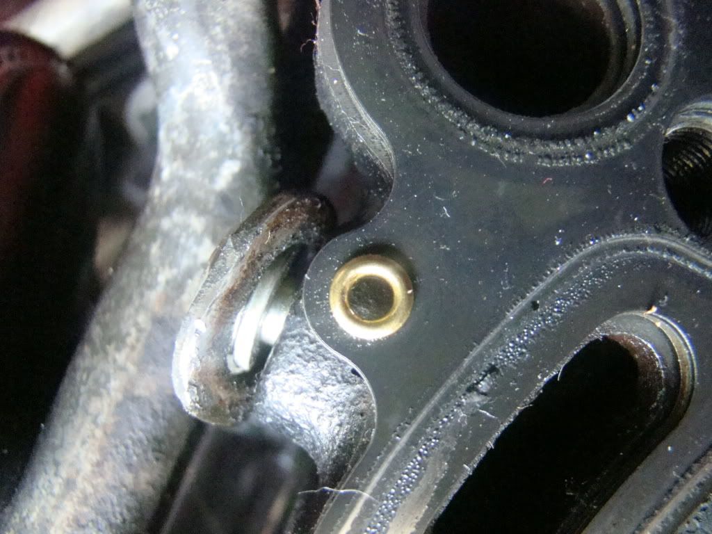

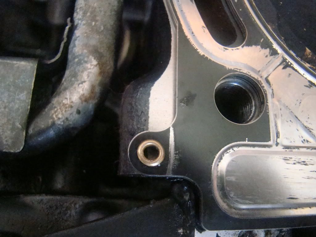

Ah! yes I ment rivets... And yeah its a Titan(Cometic) MHG..... After laying the mhg down on the block again and checking to see if any of the rivets got in the way of the head sitting nice and flat I noticed the exhaust side rivets... The top and bottom ones seem to defently get in the way... Here are a few pictures of the block....

It defiantly looks like you had a bhg, but -
Though the front rivet looks like it's laying on the block, the line in the gasket is the extent of the head so the rivet does not interfere with a flush seal.
I haven't heard anything of the rear rivet causing a problem, nor experienced it on my Cometic. (or anyother rivet on the revised design)

See, none of those rivets look compromised. If they had been in the way they would be squished.
