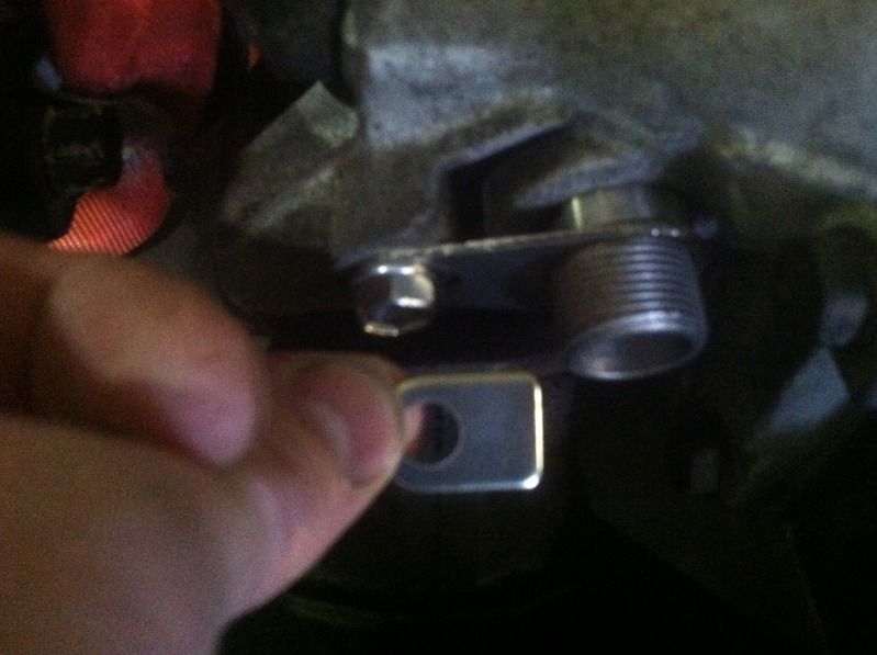

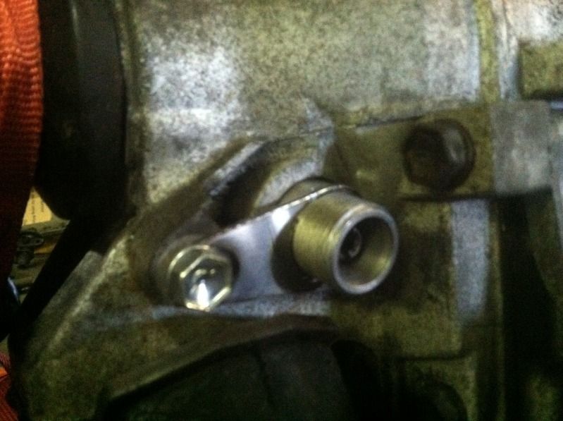

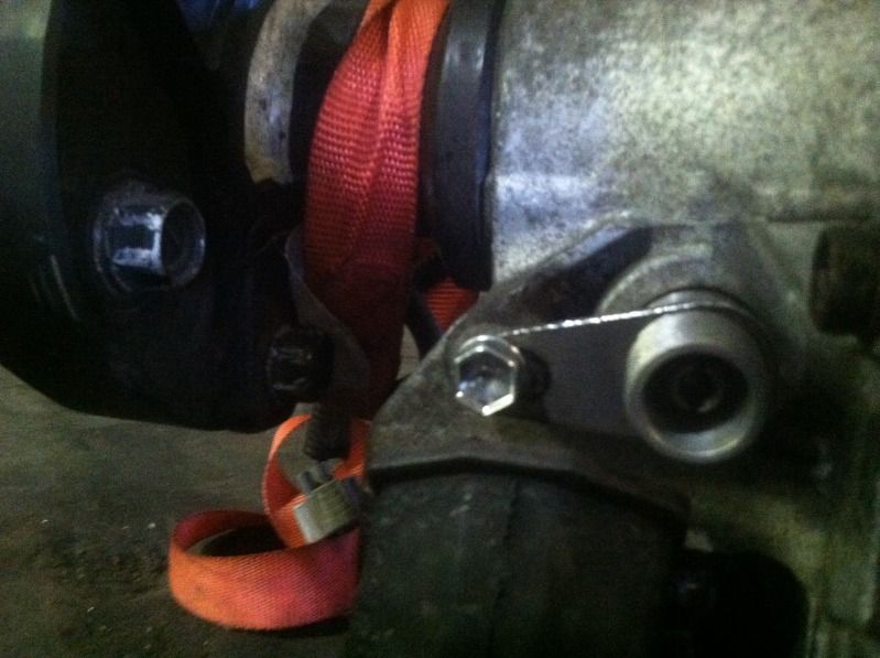

Photobucket has been gay lately and the iPhone app was F'ed but now good. Here are some pictures of the mod:
Here you can see the part number piece and how short it is. So maybe there is another part number that is longer? But my fix should work fine!
Hope this helps people down the road!

Yeah that bolt hole is quite far away on the Aristo tail housing. Interesting, I didn't expect that. I haven't seen any plates that long from Toyota, but your solution looks like it will work well.
Jeff
