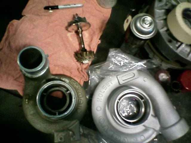

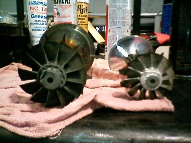

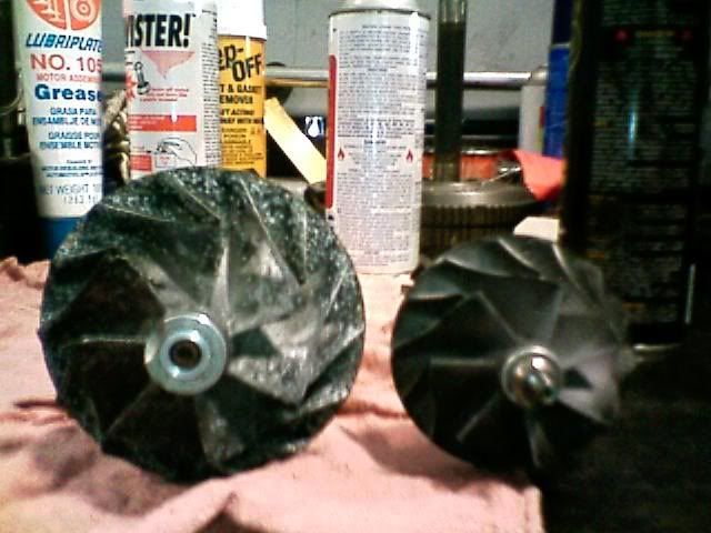

Here is the HE351CW (Hy35) compared to the HX52. Mind you the HX52 has about a 67mm compressor wheel....

No the hy is around a 53mm comp wheel. Id bother with it because it flows 60lbs of air.
Compressor minor/major: 2.077"(52.75mm)/3.0645"(77.84mm)
Turbine minor/major: 2.2825"(57.98mm)/2.5670"(65.20mm)
Mind you the closest Garrett Wheel that flows 60lbs of air is almost 58+mm in size.
This means quicker spool due to the low rotating mass.
IIRC, the HX52 measures 66.7mm minor / 98mm major ?? on the comp wheel....

Hy35 all the way Jon.
After she's all happy with that, move up to the HX52 with a two step and do a wheelie!

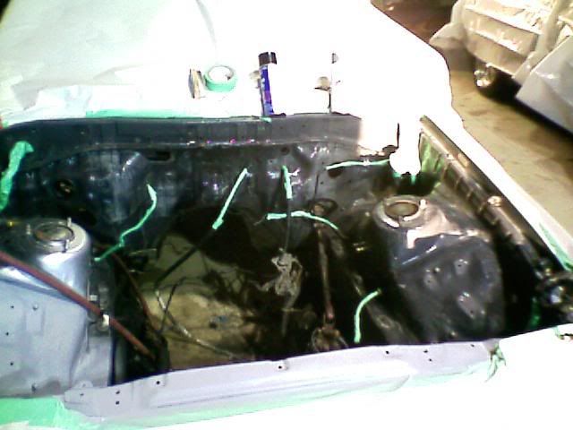

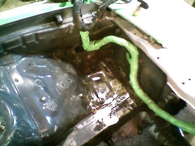

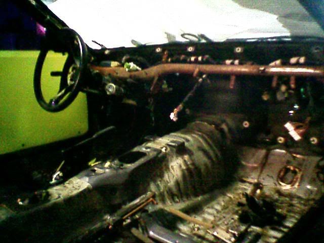

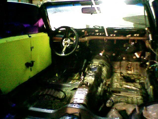

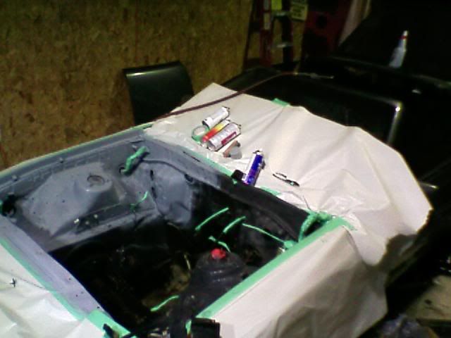

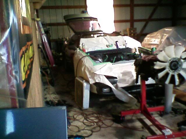

Just a few updates since Ive had some time to knock some crap out.
A few shots of the progress since the interior was gutted along with the engine bay.
The green paper is a mock up template on how I would like the aluminum door skins to look.
The bay has been prepped for paint and is getting shot with primer as we speak.
Enjoy for now, more to come.
Battery Tray BE GONE!
Halfway there!

if you have both turbos already, i'd try out the HY then move up to that big ass HX if you're not satisfied with the HY.
