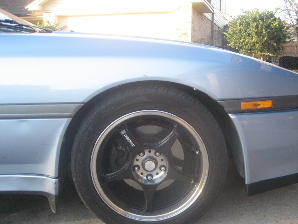

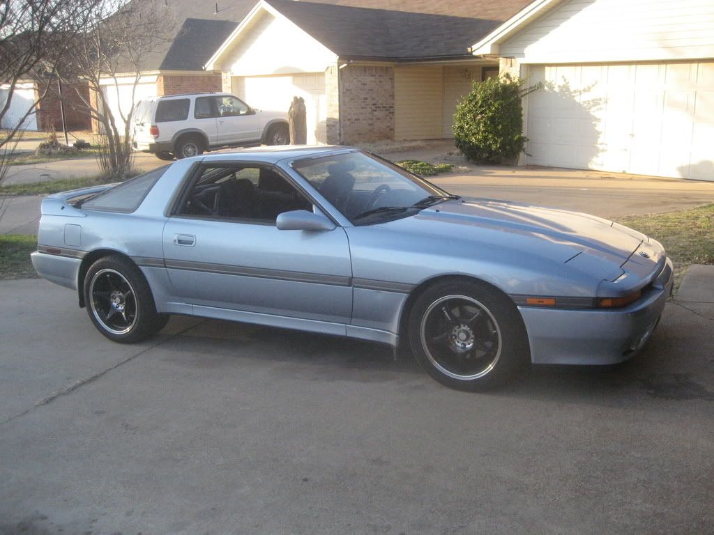

Yup, those Cobra wheels are really wide! They stick out alot on our cars, I've seen them in person on a MK3, and they look ok just not right. The 17x9 +24 you will have a problem with rubbing. The wheels that I have are the 17x8 +35 in the front, and 17x10+35 in the rear. and they work great and don't stick out that much at all. I might get some 17x9+35 for the front later on.

No they are not photoshopped. They are real. I didnt get the 17x10.5 +27offsets figured they would be too wide and stick out too far the f. I got four 17x9's maybe it was the wrong choice. the 275 fit fine on these 17x9... I test fitted the fronts and they stick out slighlty but I may get 255-40 tires and do slight fender pull. My ride hide is pretty high to any rubbing issues.
