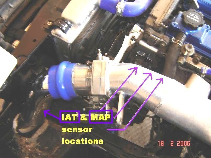

Here's the ideal/most suitable locations for IAT & MAP sensor fittment on a FFIM according to Bob's suggestions last time we talked about this on the thread:

I hear you guys about where people say is the best spot for the air temp sensor but I doubt the Toyota engineers would be wrong about putting it in the plenum on 1jz, 2jz, and Turbo A engines. Makes me wonder if people say the intake piping is the best because it is the easiest to remove and put a fitting in. :dunno: I'm gonna leave mine where it is and see how it does. The only vehicle I can think of that has the air temp sensor in the intake piping is Honda, and I don't want my setup to be anything like a Honda :)
