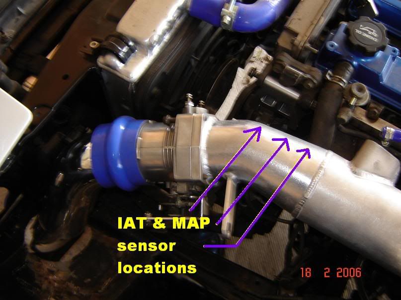

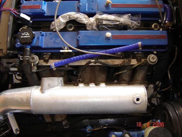

Ok a question about IAT & MAP sensor fittment. I know it's been mentioned that both these can be mounted on the intake pipe as close and prior to the throttle body as possible. Could these be mounted just past the throttly body? I have one of Ron's FFIMs and this is what I mean:
So could any of these sensors or even both be mounted on the elbow past the t/b?

i recommend putting the IAT in the IC pipe just before the TB because there's less chance of heat soak there.....you can put it in the intake manifold, but there is the chance of heat soak.
the MAP sensor can be connected to any post TB vac line.
So Adam any of these three side ports will do for the MAP sensor, right?
Does it matter in what angle the IAT sensor is mounted? The way my i/c pipe is located I could either mount it on position 1 (09:50 clock angle indication) which would be a tight fit next to the radiator or position 2 (6:30 c.a.i.) vertically from undernieth (most preffered spot). Also my blow off valve will be mounted where I'm pointing out on the photo. Will that affect the sensor's location?
yessir!
angle doesn't matter. i have my IAT mounted underneath @ a funky angle....

Ok thanks Adam, that's how I was planning to mount mine as well, underneath. So my blow off valve won't do anything to the IAT sensor that will be like 1" away from it right?
You want to watch out for ports that are close to cylinder runners, you can get a choppy MAP signal which will not be optimal......
I usually like to see the MAP sensor tapped near the throttle body, away from individual cylinders.
Bob
So Bob would just past the t/b be ideal? If you can see on the pictures above I was thinking to tap it on the elbow pipe of my manifold right past the t/b.
