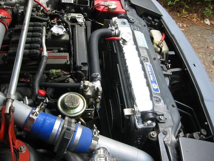

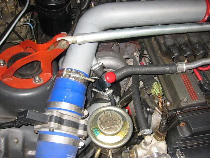

You mean like this?
Lots of people have done it, but not with the OEM metering unit. You can't.
