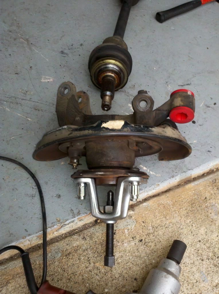

I meant the wheel hub assembly.
mk3_7m
Jul 21, 2007
536
melbourne
ah yeah that's fair enough.... my poly bushings came in the other day... and can't afford to leave the car off the road for a while.... and it's supposedly a lengthy process to get the bushings out of it's housing. So buying another set to work on and doing a change over would be easier.
